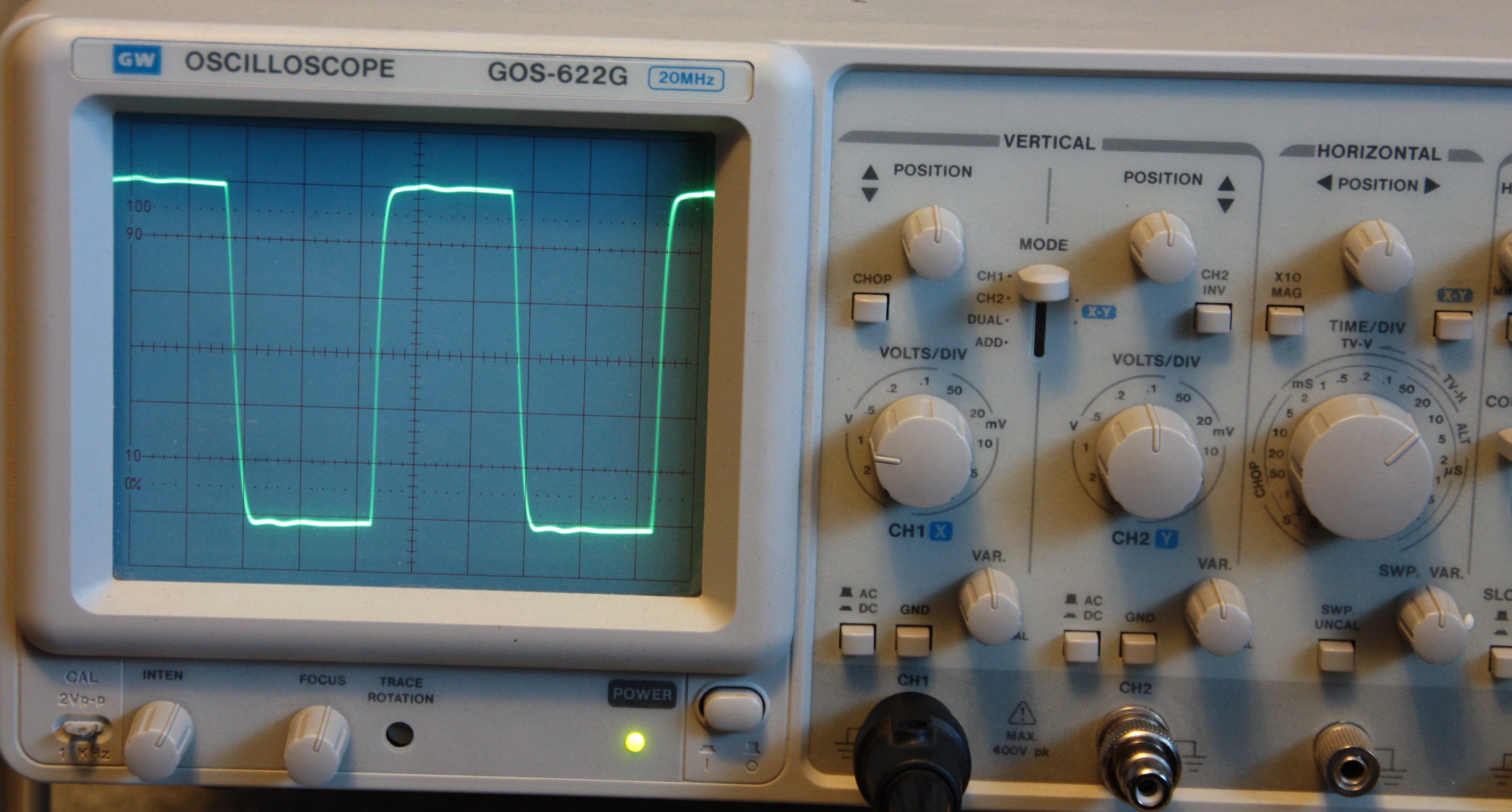

Get the Hammond 1650N from here:
Hammond Push-Pull Tube Output Transformers - (1608 - 1620, 1645 & 1650 Series)
Would be my recommendation.
10K square wave from Hammond 1650N driven with push-pull triode connected KT120's
At ~550V you should get 45 watts out.
