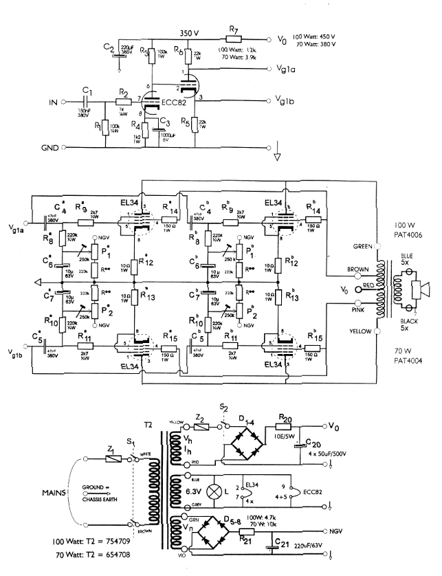

I have a pair of PPP EL34 monoblocks built to the design below.
I have the EL34s Triode Strapped with the screen resistors (R14a,R14b, R15a, R15b) = 1K 5W. With an Oz 250V 50Hz AC Line I get an HT of 485 V. I also run ECC99 in place of the 12AU7 with no other circuit changes.
Problems are:
Gain too Low
Zout too High
Otherwise sound is surprising good.
Those VDV2100 (PAT4006) Toroidal Outputs really deserve something a bit better, particularly in the front end / driver. I have a few ideas about a rebuild BUT though I'd canvas the "experts" before diving in.
Any suggestions from the experts ("drips under pressure") here?

Bypassing your output stage cathode resistors should lower your output impedance.
Would that subsequent increase in gain then allow you to do away with the first stage, bias the splitter using resistors and capacitor couple it? or use a long tail phase splitter instead?

Oops! didn't read that right. Disregard the second paragraph. The bypass cap will increase the gain and lower the Zo.
Indm,
Those cathode Resistors are 10 Ohm. That is the amp is fixed biased and these are just convenient bias measuring resistors and individual tube fuses. Bypassing those resistors WILL increase gain and lower Zout - by about 0.5%.
Actually I was thinking in terms of a whole new front end/driver. The Output Transformer bandwidth is so huge that global feedback does not worry me BUT I am hoping someone might have a good idea for local feedback schemes which eliminate or at least reduce the requirement for any global feedback.
Perhaps a separate pentode driver tube (or triode with largish unbypassed cathode resistors) or even MOSFETs for each output tube with shunt ("partial") feedback.

Can anyone comment on pros / cons of differential mu stage front end / driver as compared to diff amp front end feeding SRPP drivers?
Should I instead be looking at interstage transformer solutions?

Ian,
Take a look at Norman Koren's web site. He has some interesting input phase splitter design. The web site is www.normankoren.com
Andy
