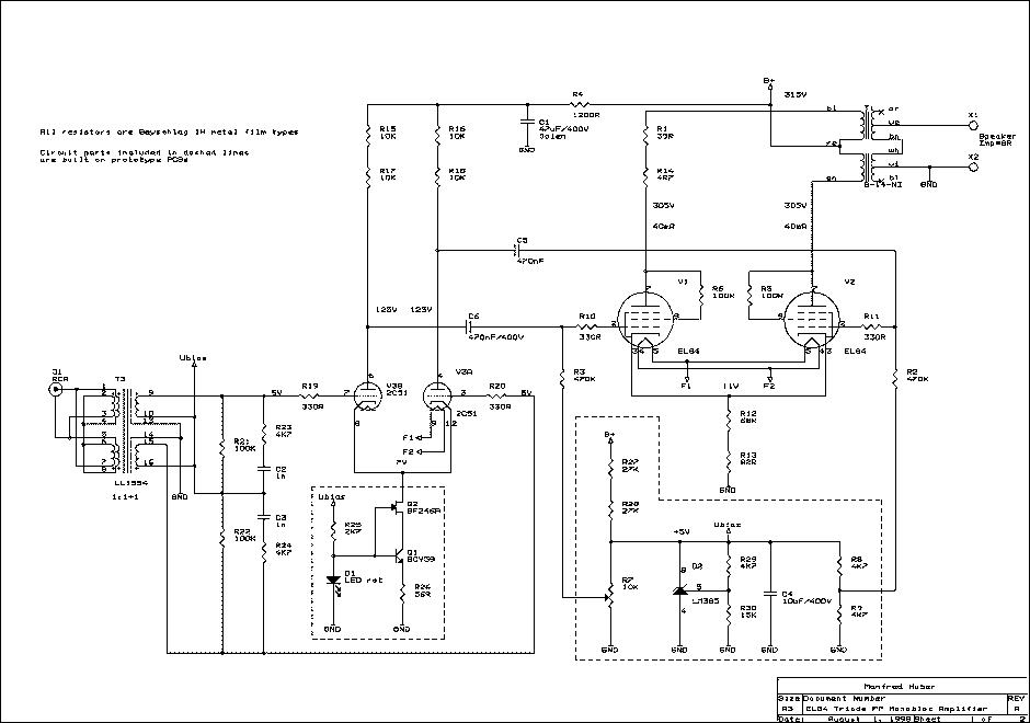

el84PP
Your countryman Huber had an interesting EL84 on the web (now disappeared (?)).
Could anybody comment on this design ?
Did anybody build or heard it ?

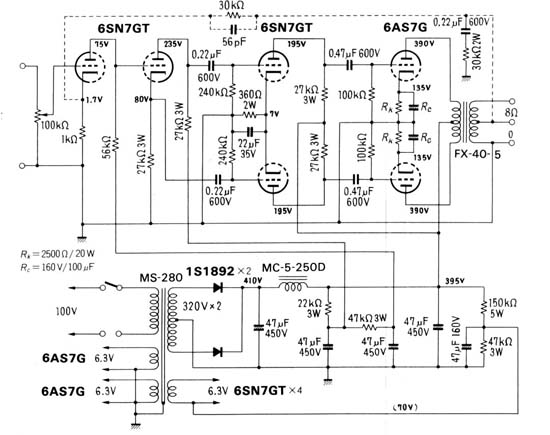

Andreas
- PP in Class A
- Triode output Stage
- Common and cheap tubes
- 10 Watts per channel output
- Common 5000ohm PP output transformer
- Just replace the diodes in the power supply showed in schematic with rectifier tube like 5U4G, 5AS4 or GZ37
Argo
