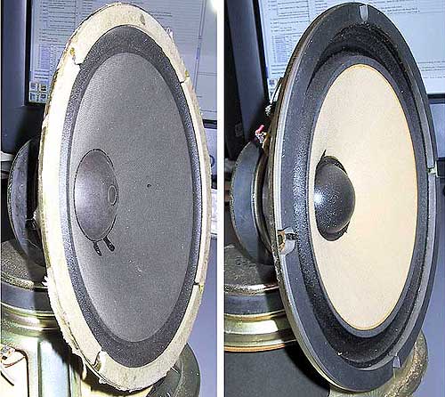

Planet10, slightly OT
The drivers on the left picture, thats a coral 12L60 or something, i might have a pair lying around in the basement somewhere. Had them 15 years ago in a 125L ported enclosure giving lots of rumble.
Have u tried to do anything with them yet ?

Andreas said:The drivers on the left picture, thats a coral 12L60 or something, i might have a pair lying around in the basement somewhere. Had them 15 years ago in a 125L ported enclosure giving lots of rumble.
I'd have to go downstairs to check the number, but it is a 10" Coral. Plans were to use it with a pr of very special 3" Tandbands, below about 250 Hz in an active system.
dave
