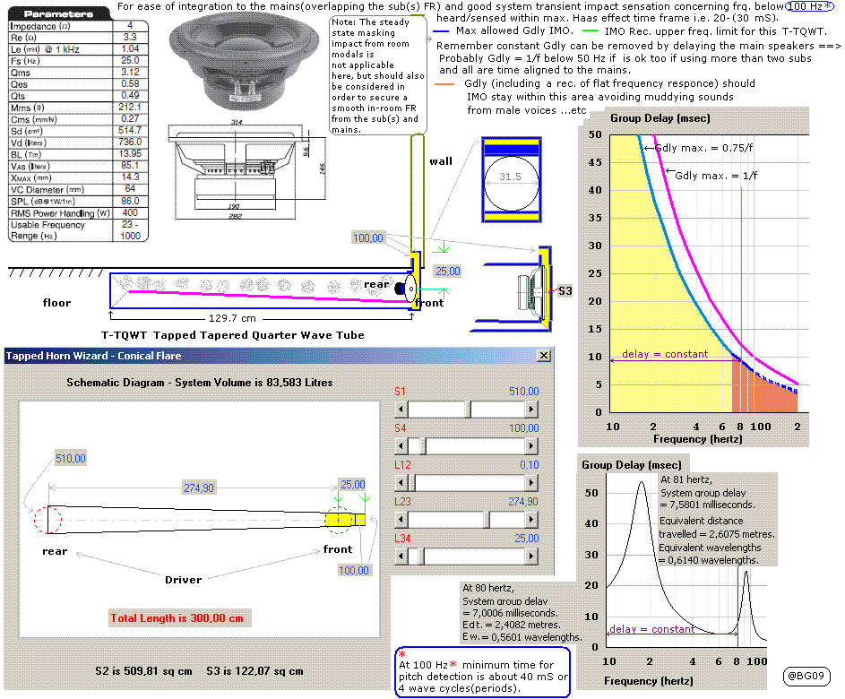

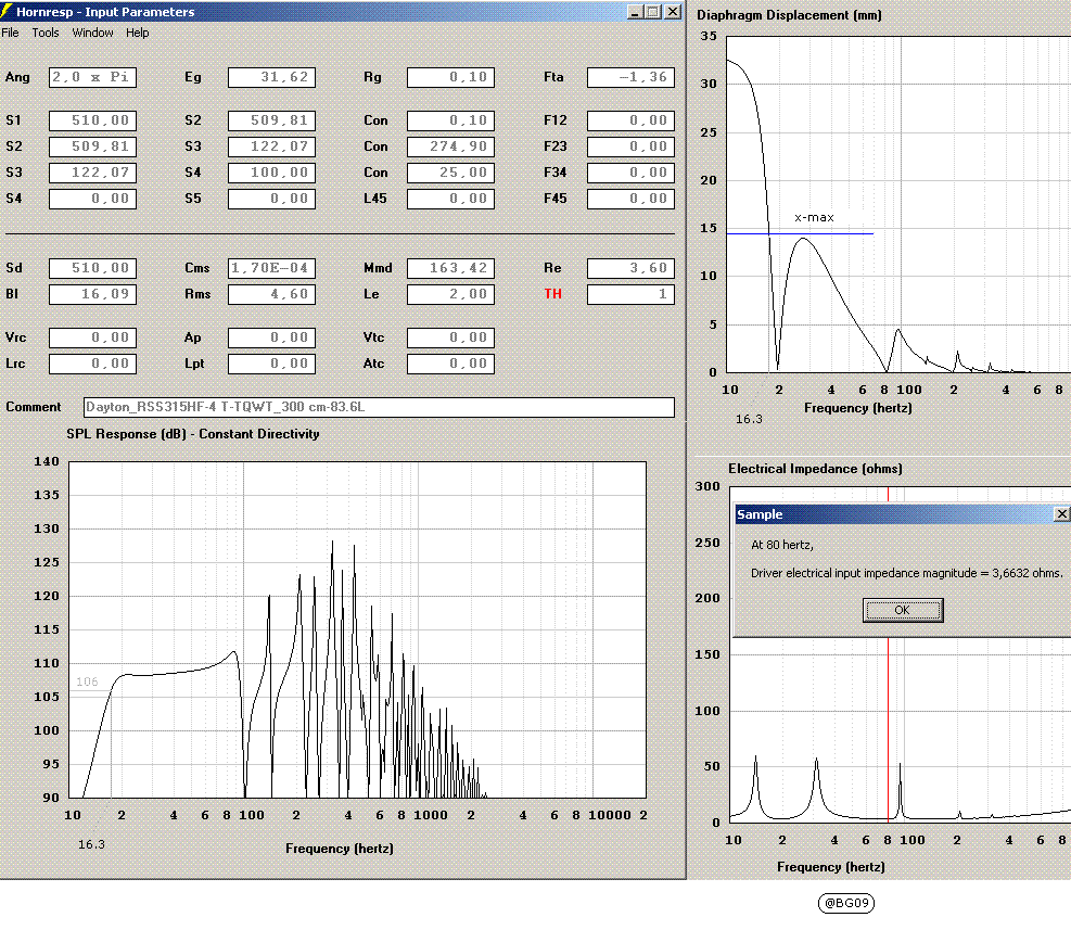

..As to drivers, no ideas yet. I was assuming 15" though. .
Hi homebuilder,
FYI,Here's a suggestion using 15” Dayton TIT400C-4 instead of the 12” Dayton RSS315HF-4.
b
