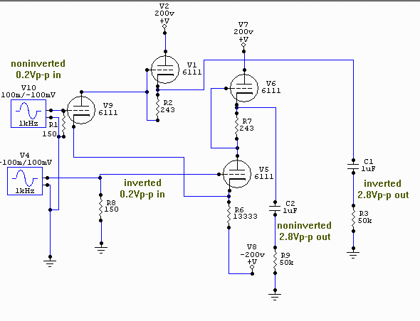

If you like tubes, here's a balanced in and balanced output DAC circuit using tubes. The 6111 is somewhat similar to a 12AU7. Low mu triode. The voltage sources represent the DAC outputs feeding the 150 ohm resistors as an IV converter. The rest of the tube circuit is a differential pair, with a pair of "SRPP" type output driver circuits.
