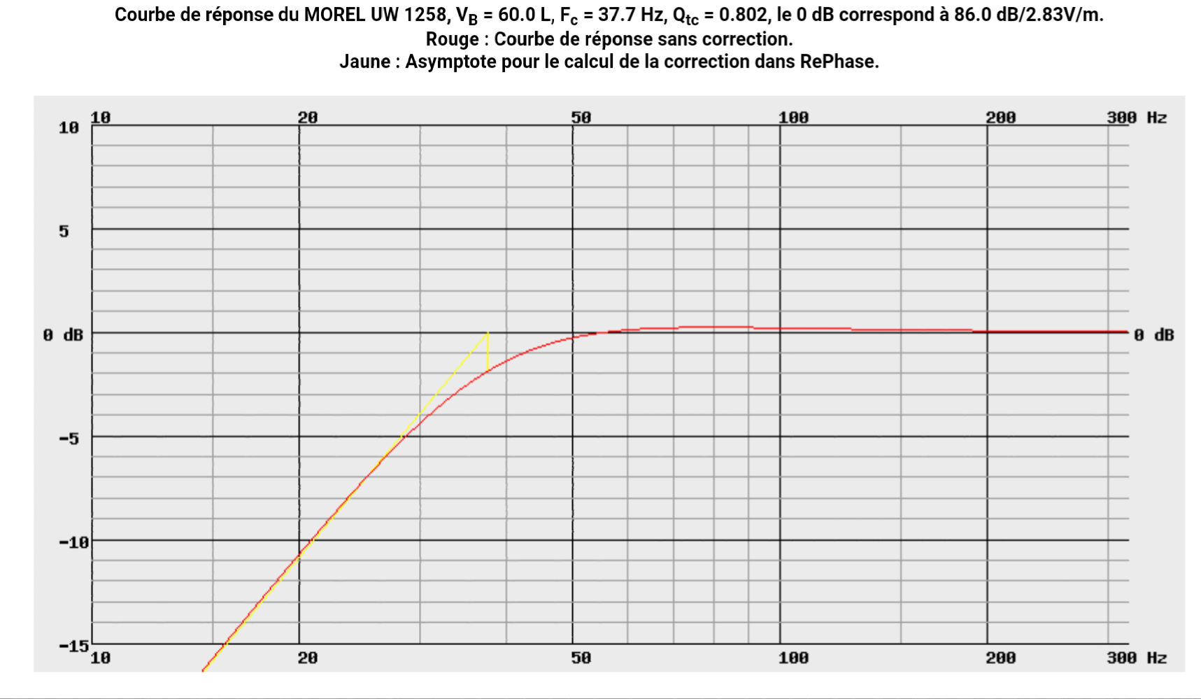

Try a MOREL UW 1258 in a 60 Liter sealed enclosure with the monitors and a good 50>W power amp (each driver).
Link
