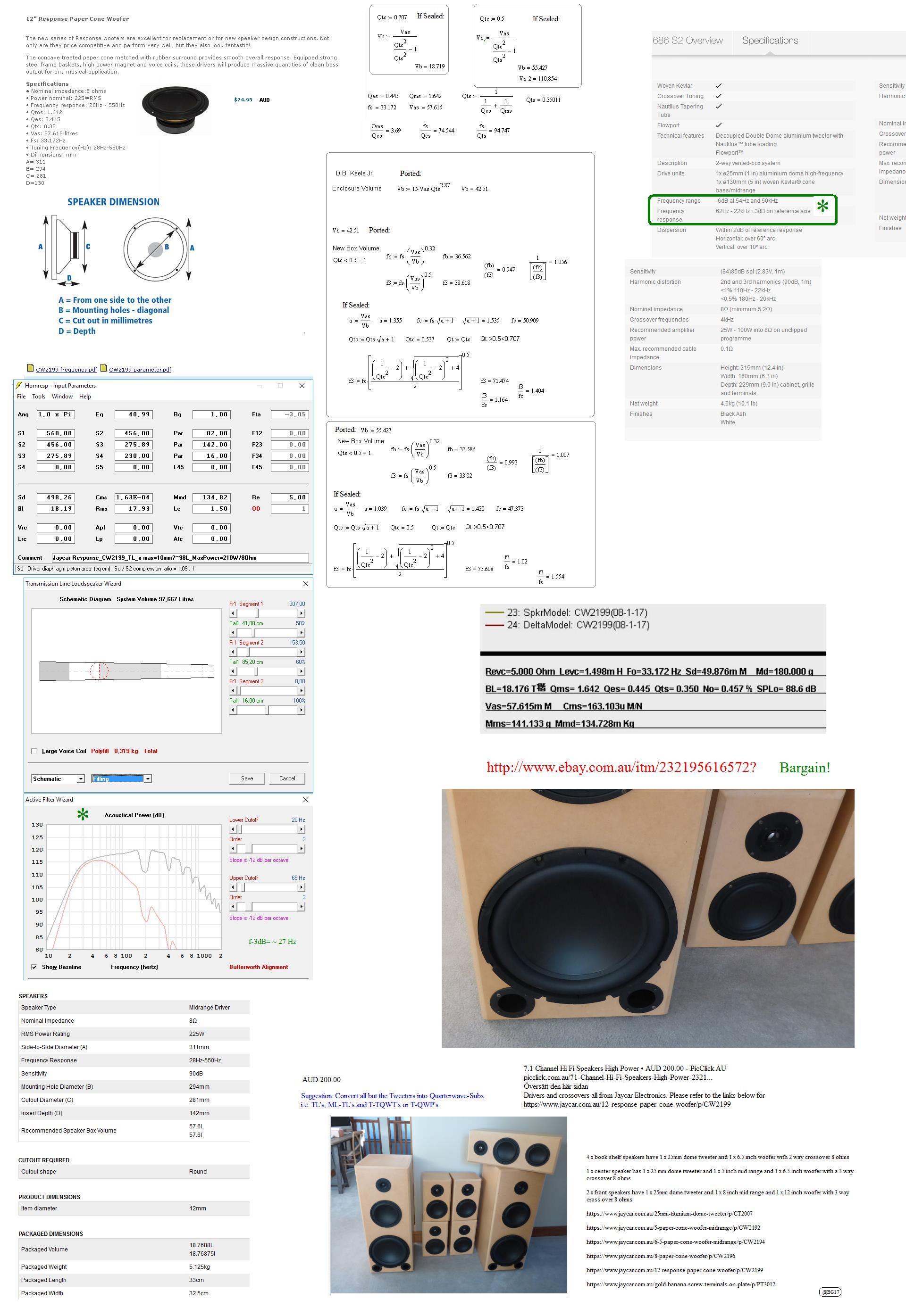

Alright, nice. Thanks so much for your help. So a low Fs and a high Xmax is what I am after? I just called up the speaker guy and he thinks I could save myself $50 and just build a 1.5 cubic ft sealed cabinet and add stuffing if it is too big. Does that sound legitimate? He also said that the fs is roughly 32hz and the Xmax is 10mm. Is this good? The Dayton Audio equivalent is this;
Dayton Audio DCS305-4 12" Classic Subwoofer 4 Ohm - Classic Series - Loudspeaker Drivers By Series - Loudspeaker Components
which has an Fs of 24.2 Hz and a Xmax of 9.3 mm. I could order this from the US for $200 Aud.
Thanks again for your help!

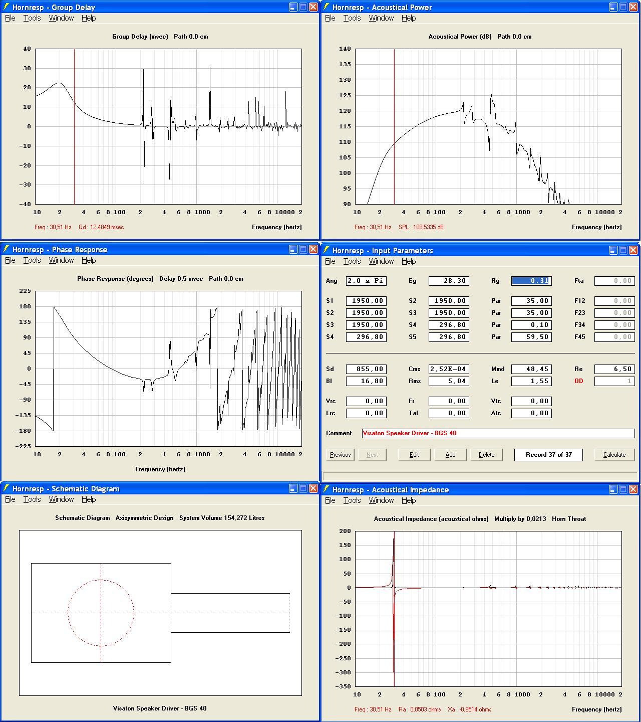

What about a 15" instead?
https://www.soundlabsgroup.com.au/p/V-3040-BGS40/BGS+40+-+8+Ohm
Output at 30hz 109db at 100w, well within xmax and whatnot. Looks like about 225AUS$, you need an amp with some adjustment possibilities also.
Edit:
May be disputable whether it's a "sub" but it's certainly likely to cover your basic needs.
Edit2:
Just use it as your tv table or something 🙂

Yeah, I think you are right about going smaller. Do you know much about the Dayton Audio RSS265HF-4 10" Reference HF Subwoofer? Looks great but I don't know much about it. Cost around $250 here in Aus.

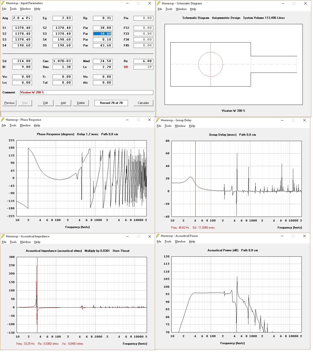

I understand perfectly, but it's not very easy to find good subwoofers for a good price in Oz apparently.
The Visaton W 200 S 8ohm should work well though, just use 2 in paralel or one per channel, good values at 30hz fs and 0,33qts and only 85$ each, should be very easy to sim a design for it.
https://www.soundlabsgroup.com.au/p/V-9030-W200S/W+200+S+-+8+Ohm
Edit:
And if need be you could always just get a car amplifier with integrated xo and use it with an old computer psu, if you know how to trigger it properly (load the -5v from the motherboard plug with a fan or resistor to gnd if my memory serves me correct, it's been 7 years since last time I did that, think it's the only blue wire on that plug, can be green some times? At any rate it's the only -5v wire on the psu) it's a really easy and cheap setup.
Here you go. 2 x Visaton W 200 S 8" in one box. If you want to go deeper then there will be some choices to make, but this should be ok.
Price is 2 * 85$ + materials and an amp. If you are very cost concerned then it should be possible to get materials, psu and amp for free if you spend some calories hunting around.
