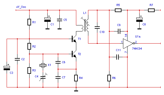

I would like to ask for the question on the regulator which is low noise for the clock circuit!
* Beside the LT323, LM1085, any good circuit is better than their performance?
Please advise! The input voltage for about 9-27V somthing....

Be carefull with switching regulators, they are noisy, and when I say noisy I mean they produce a sh%tload of wideband noise which may unpleasantly interfere with your oscillator.
My own low noise supply that I commercially sell exhibits less than 5nV/Sqrrt Hz in the range of 20 Hz to 100kHz
For your reference: An average LM317 is 30 dB more noisy......
all the best
Fully agree with Guido. A well build discrete linear regulator is unsurpassed regarding noise. PSU noise is damn important for powering an oscillator that is intended to be of lowest side band noise and hence jitter.
Why would anyone use a switch mode regulator for powering such sensitive electronics? Even mechanical noise can largely impact performance of an XCO.

According to my measurements......
Assuming that they didn't lie to me:
An unbypassed LM317 has noise in the range of 3 uV/sqrt-Hz.
The simple supply in the oscillator schematic I posted is around 4 nV/sqrt-Hz.
Jocko

For those of you struggling with PSU noise, get rid of it in the oscillator circuit itself as well. Attached a circuit that does. T1 is also acting as an extra PSU filter as well. For 256 x Fs, L1 can be a 10.7 MHz mf-transformer, for 512 x Fs it can be a 27 MHz transformer. I am up to building this. In the past I build similar ones with a dual gate mosfet.
