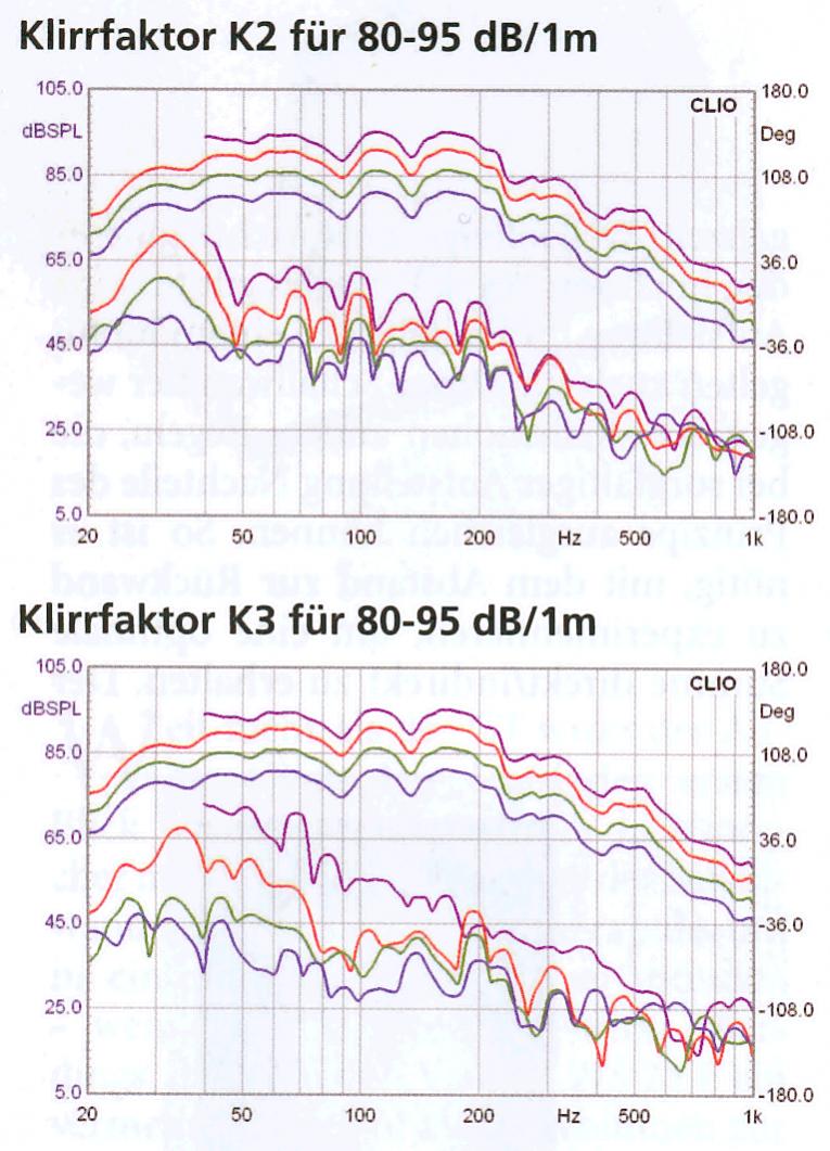

Two comments from reviewers (you need to translate the second one, I'm afraid):
Audio Circle dipole
no baffle loudspeaker "Nobbi"
Below are distortion measurements for the audio circle dipole, NOT the individual WS25E.

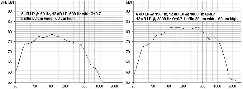

Just for starters 2 suggestions for the WS25E in OB:
attachment.php
Left for a wider baffle and lowest response. You need to EQ between 50-250 Hz with a bandpass filter. It won't do loud of course.
Right for integration with a subwoofer at 80 Hz and a bit higher Xover to the midrange.
If you know, what configuration you are aiming at, I could simulate some U frame too.
