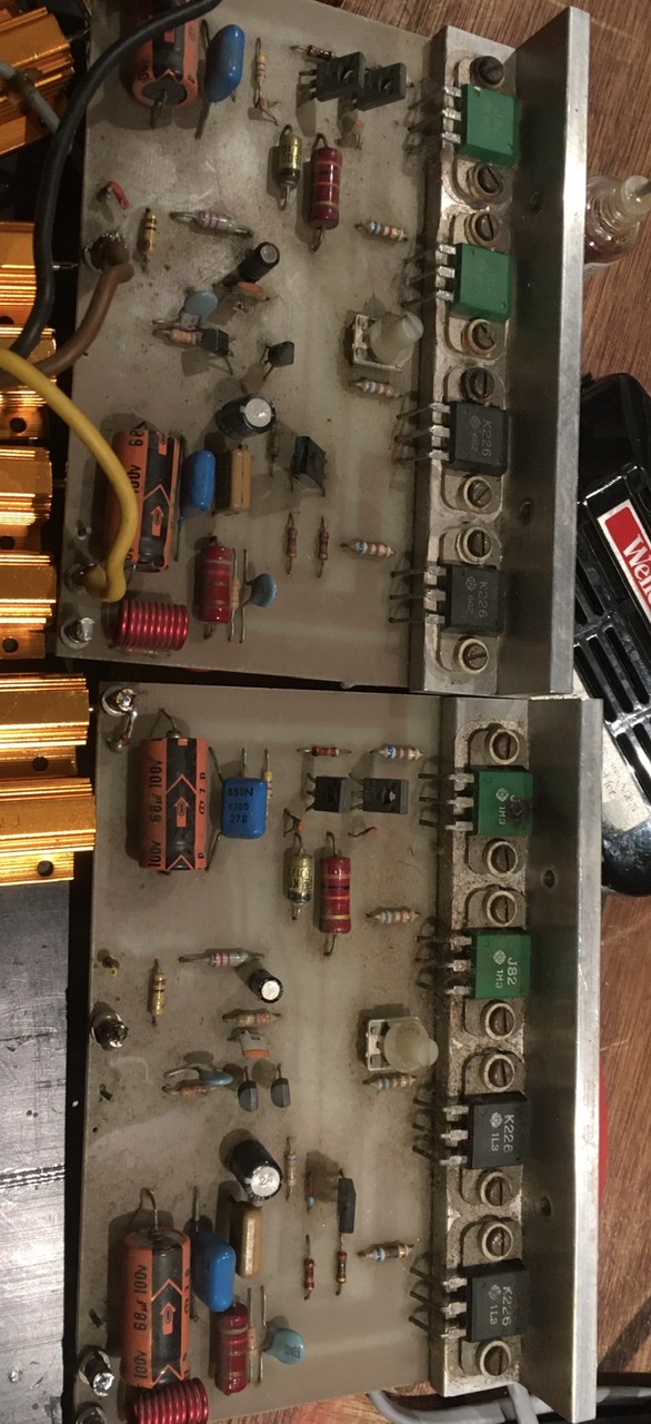

I have been given an old, home made PA amp that was blown in one channel and dodgy in the other. It seems to be a lateral mosfet design, somewhat simpler than the hitachi data sheet design and not really capable of the power supply the chap had fitted.

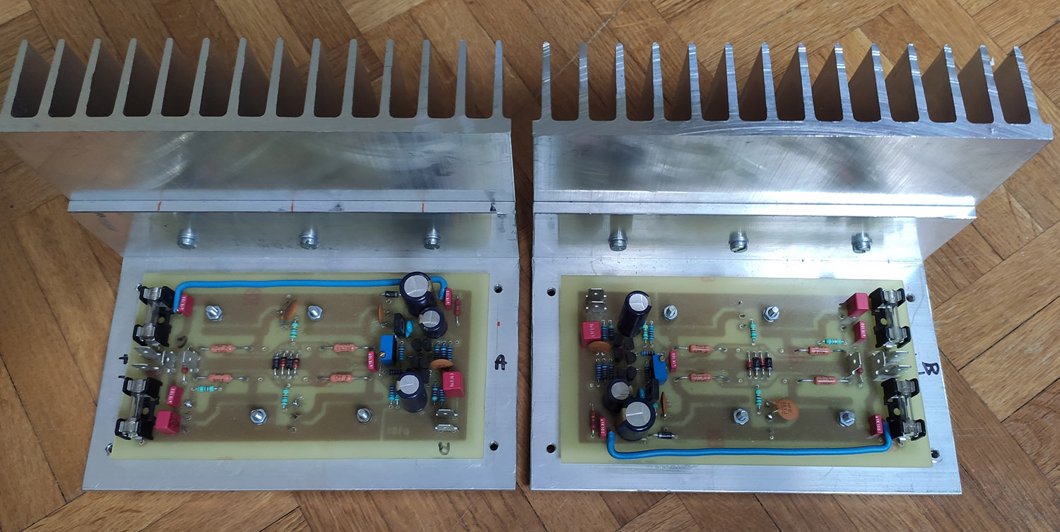

Hi Lord,
I built them as a challenge after completing Elliott's P3As and wanting to hear lateral mosfets.
The P101s sounded pretty good to my old ears but never made it to a finished chassis...

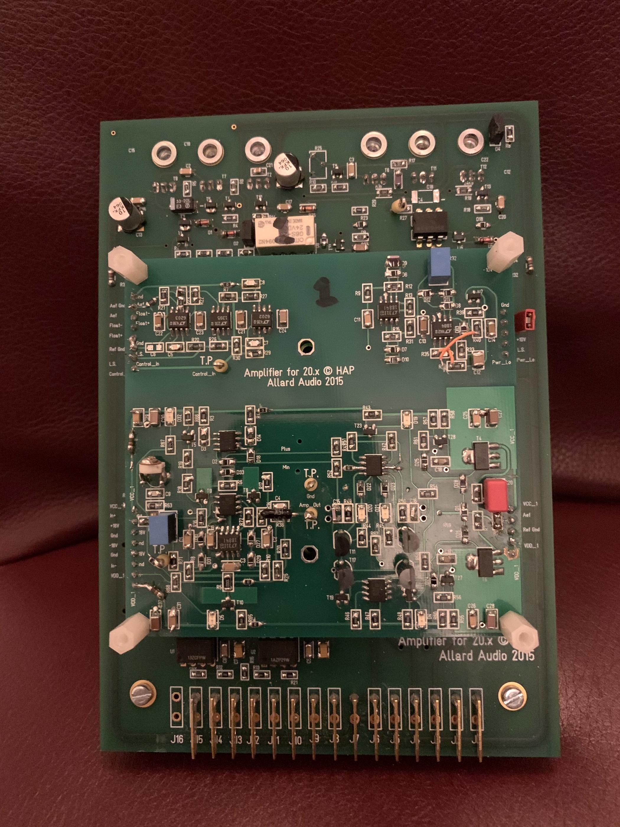

I started with two ML20.6 monoblocks.
Threw away the outdated amplifier boards, designed a whole new two stage setup, the first stage a 27dB amplifier followed by a 0dB current amplifier in a nested feedback topology, still using the original MJE15030/15031 pre drivers and MJ15024/15025 drivers. It was a swop of the socketed amp board by a completely redesigned one populated with modern SMD components.
It must be seen as a technological challenge but not as a DIY project because you will need a ML20.6 for the power supply etc.
Here is a picture of the board.
Hans

Hi Lord,
Jacques
Very cool Jacques, I like your approach of building a few different designs and comparing. If one has the power supply the rest is pretty cheap to chop and change. 🙂
What number and how many lateral mosfets were used in the original design? Show us a pic of your chassis.
I can suggest the Dh-220c design as an option.
J82 and k226, if there was a reliable source I would think about resurrecting them. As you can see the board on the right blew up quite spectacularly. 😀

Thanks for the pics and info. How big are the heatsinks?
