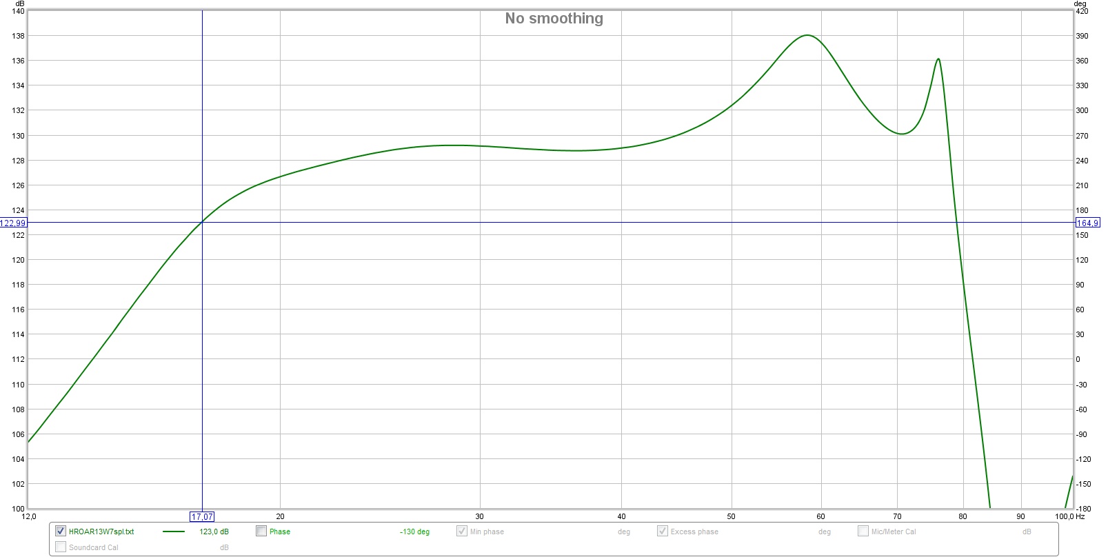

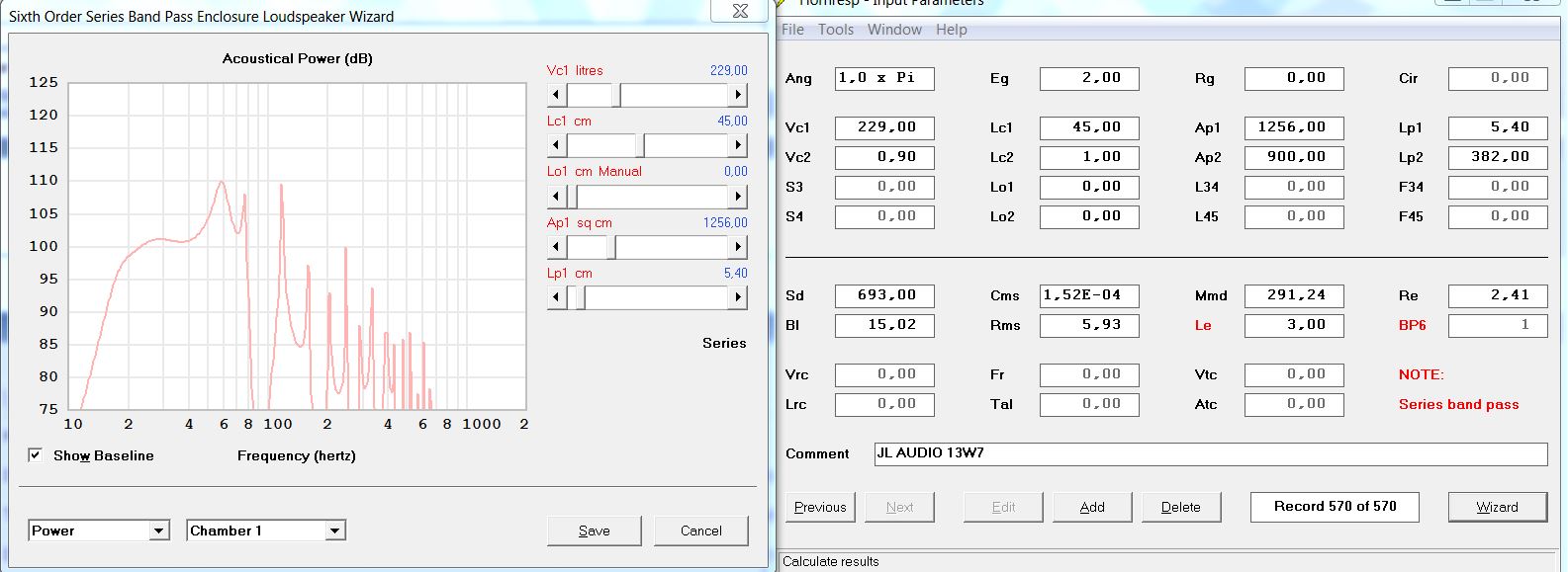

Here is a large but easy to build and rationally designed "HROAR"/ 6th order BP with mixed quarter wave first resonator and Helmholtz front chamber.
I can´t promise that it will sound any good since I have never used a JL-Audio 13W7 driver. It does have a quite high Qts and Vas with lots of Mms so it behaves a bit strange in Hornresp compared to the drivers I am used to.
It would be 1200 x 1200 x 522 mm for a rational use of standard 18 mm plywood (double layer in both front and back).
Layout as the first build in this thread:

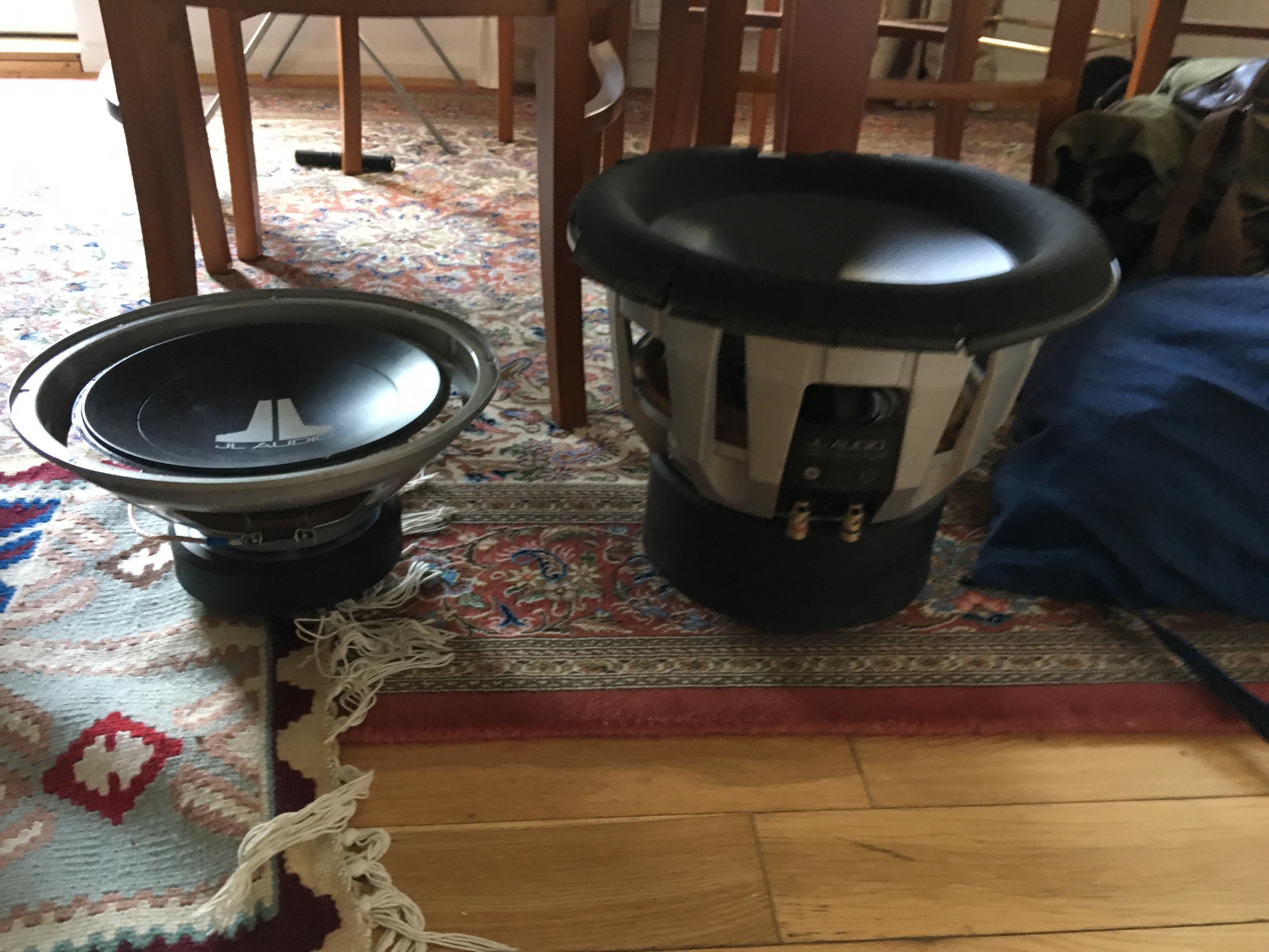

The xmax is genuine for the JL w7, the realistic continuous power handling is also closer to 750-1000 watts depending on the type of material played.
Here it is next to a “normal” sub capable of around 13mm of xmax.🙂

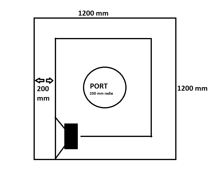

A simple sketch of the layout.
Internal depth is 450 mm.
The port is 400 mm in diameter for 1256 cm2 port cross section and a max port air particle velocity of 12 m/s.
seems to be the low group delay for a band pass box
60 ms GD @ 17 Hz is quite low.
Very nice looking driver! Seems quite capable for some serious HT-use. 🙂

Ok, Ive just about managed to get Hornresp to import them, I still need to learn how to use the software properly... 😀
I like these designs, low GD, play loud, nice passband width. :cheers:

Here is what Hornresp predicts is the max Spl if the 32 mm one way linear cone excursion holds true in real life. This is with 625 watts.
