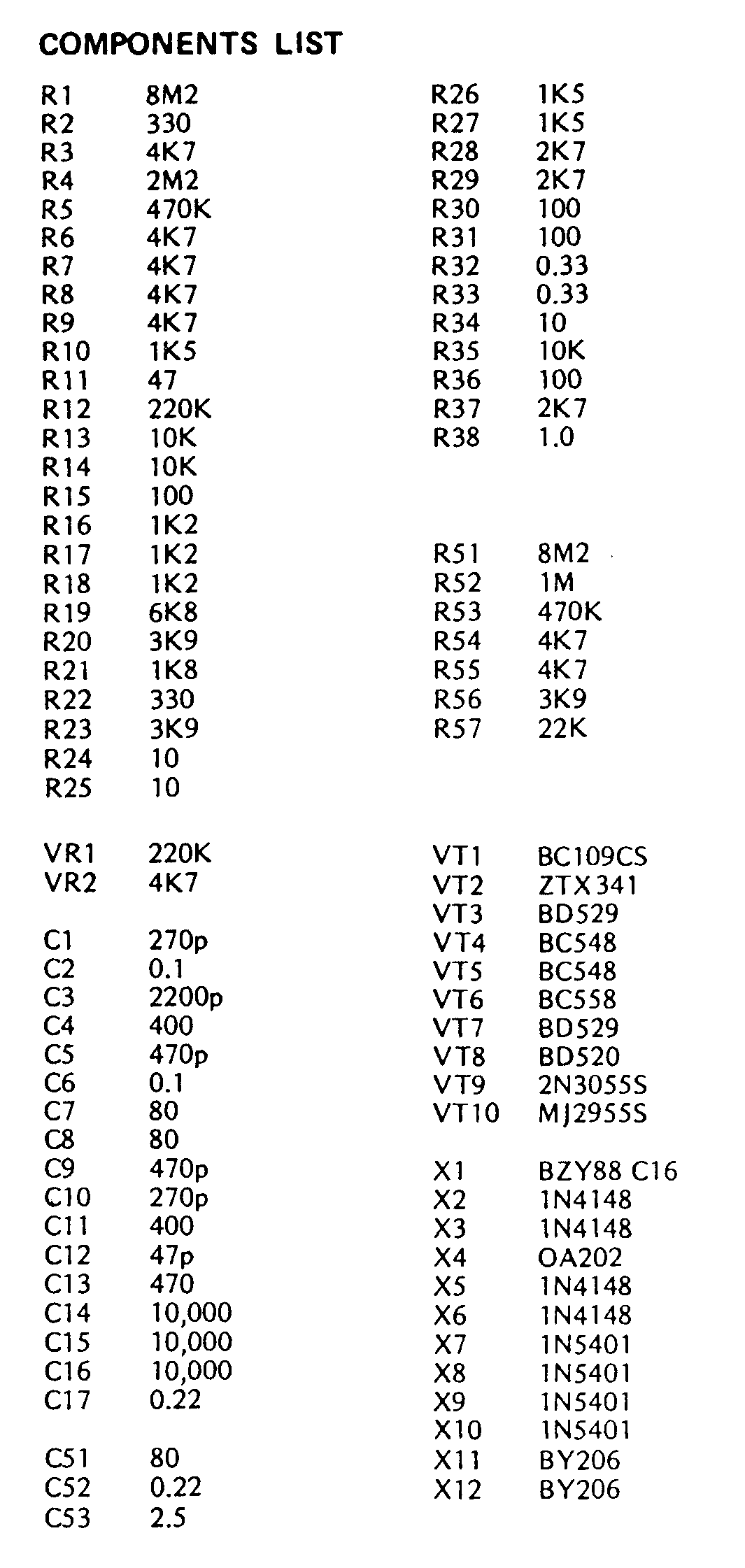

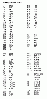

Also have a P51 and the all the caps will be replaced.
This is of great help I hope.
Is it complete??.
Is it complete??.
Dear Michel,
Thank you very much for including the component list! It was very helpfull. Thanks to the component list I could find the original value for R35. In the P51 I have here for repair this resistors have a value of 100Ohm (Original from the factory) but this resistors where fused. It turns out that the where originally wrong placed but since they only discharge the elcaps of the powersupply the amplifier always worked without problems. No I mounted 10kOhm resistors and the amp works fine again without blowing up this resistors. Soon a restauration journal will be published on my website: Vintage Audio Repair Netherlands
