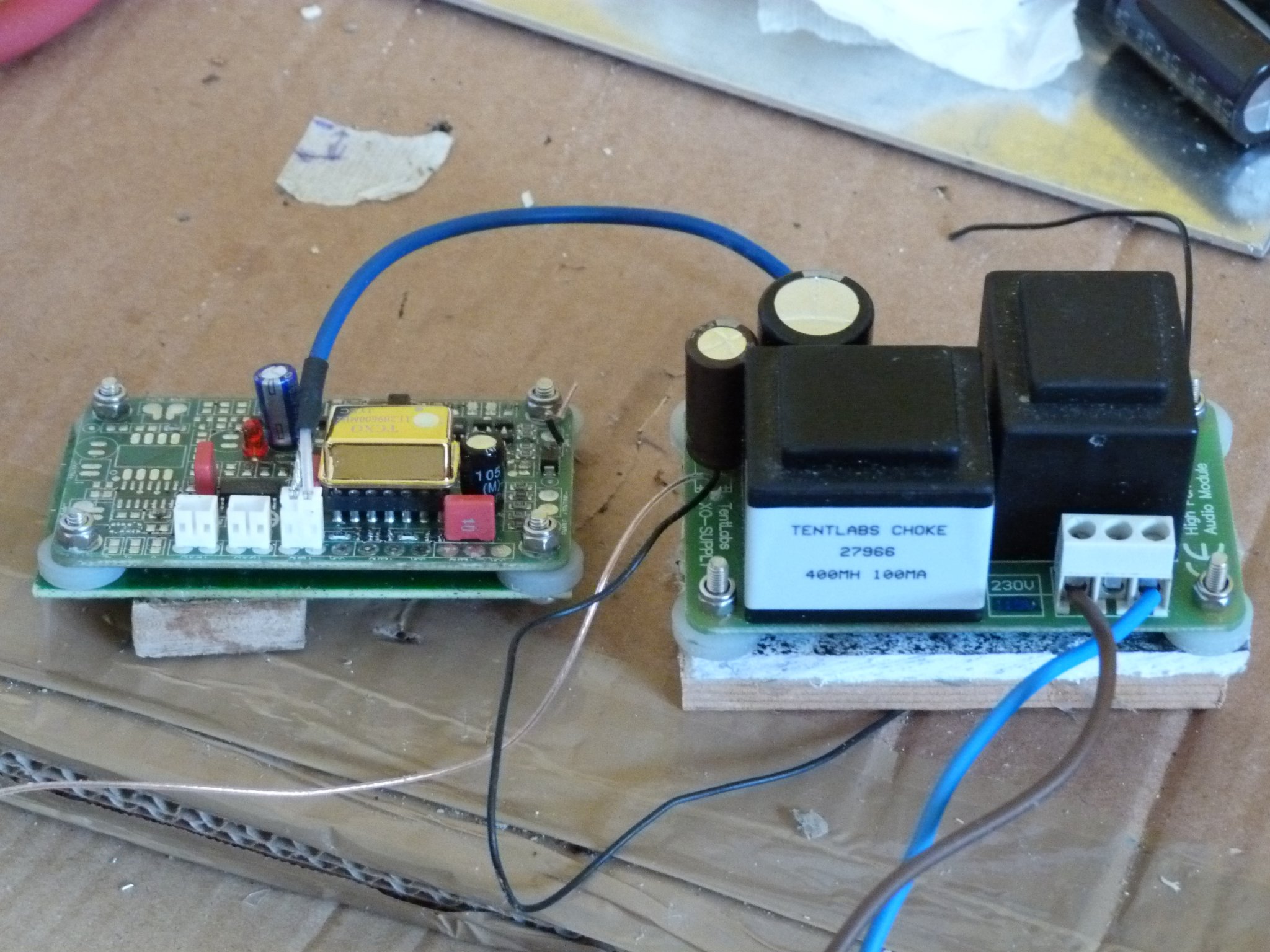

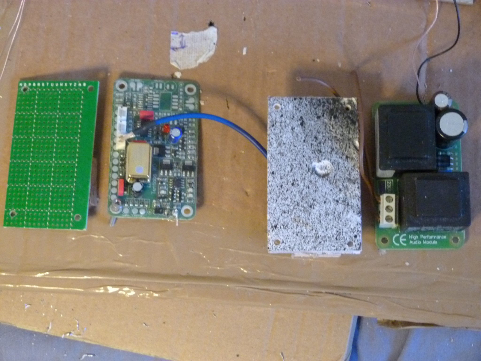

The components Tent board and PSU, with my bases to mount them.
Bases fitted.

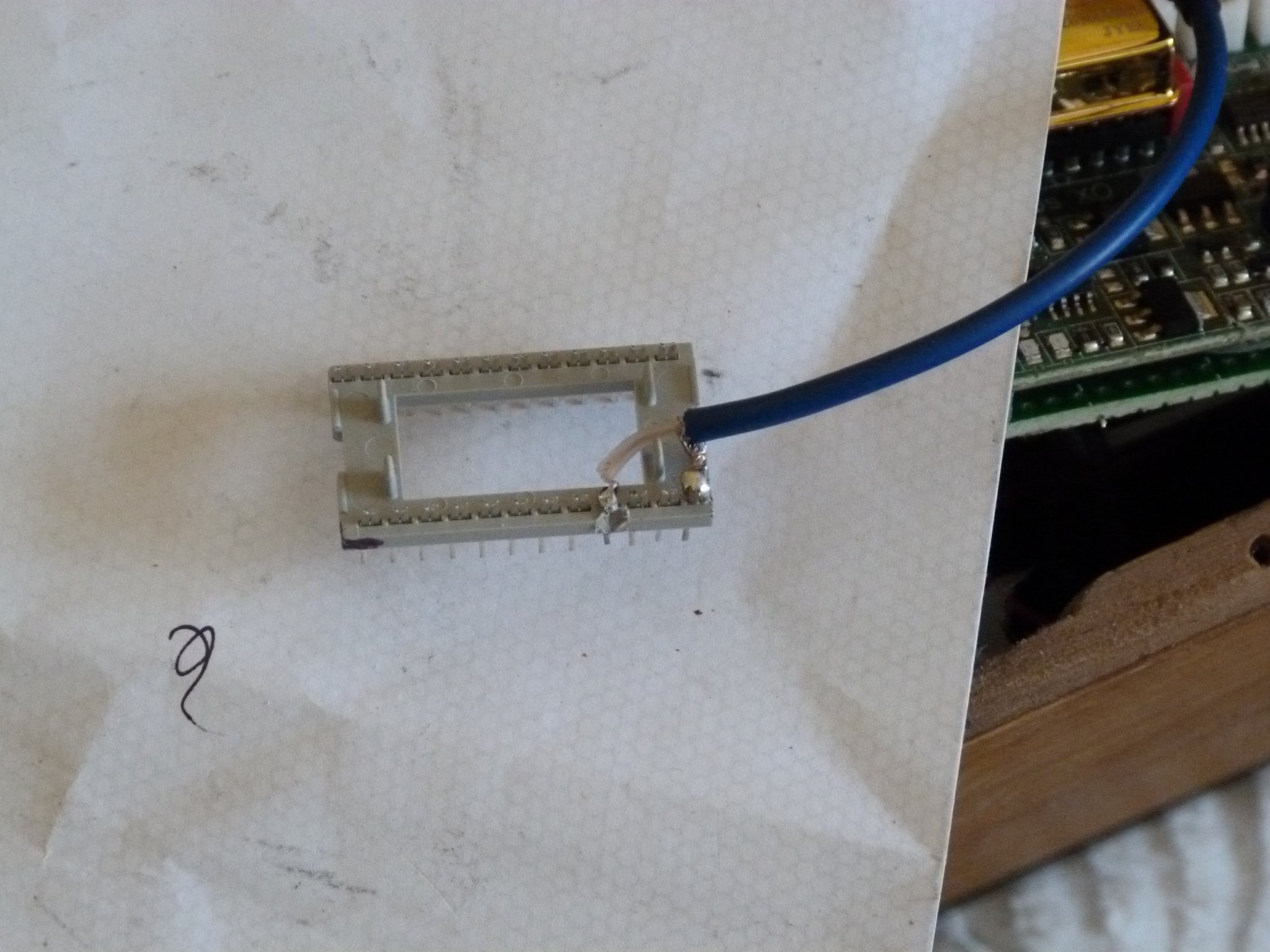

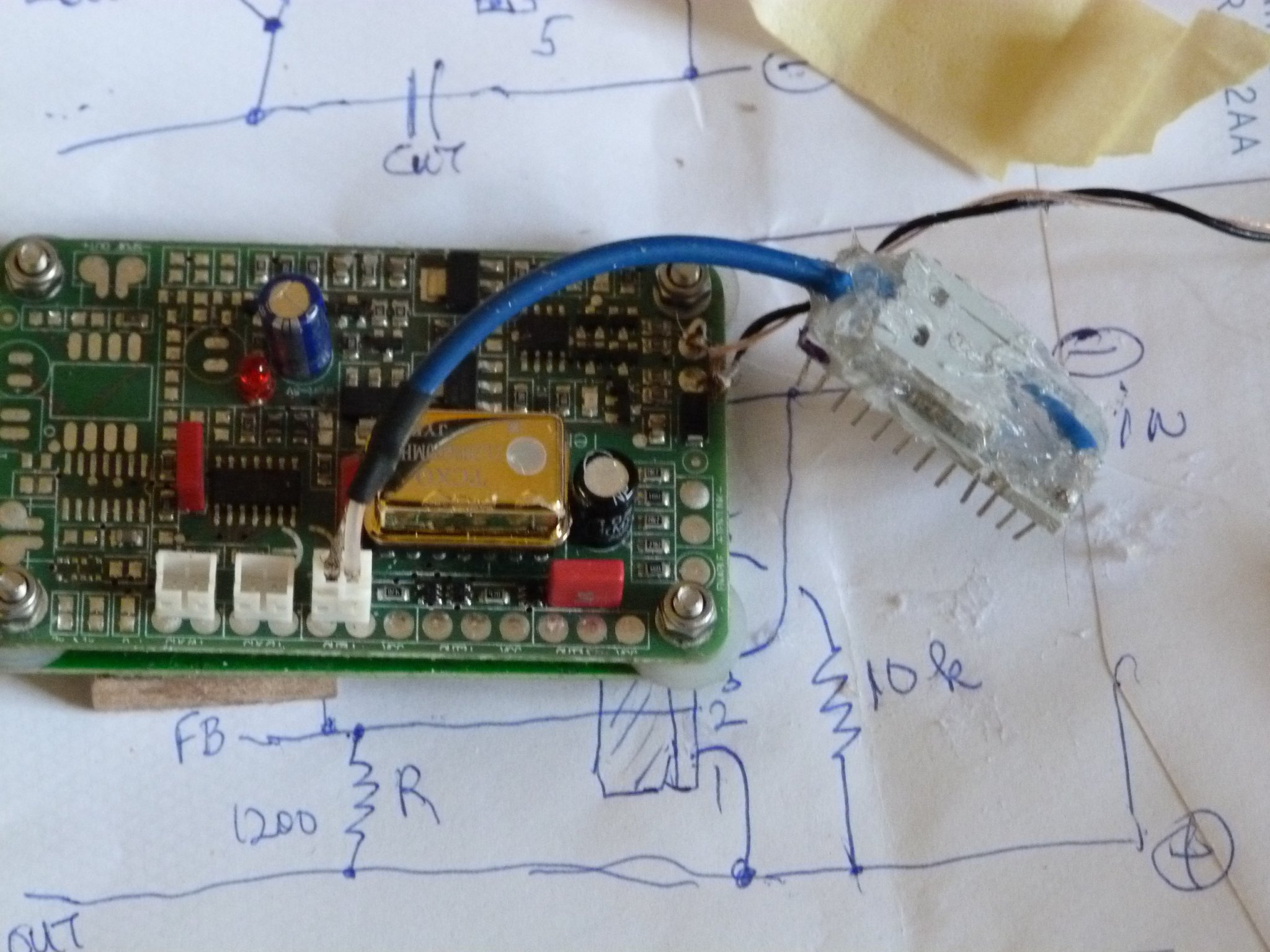

The DIL connector wired, signal to 9, earth to 12; there is no other earth connection from the board or PSU.

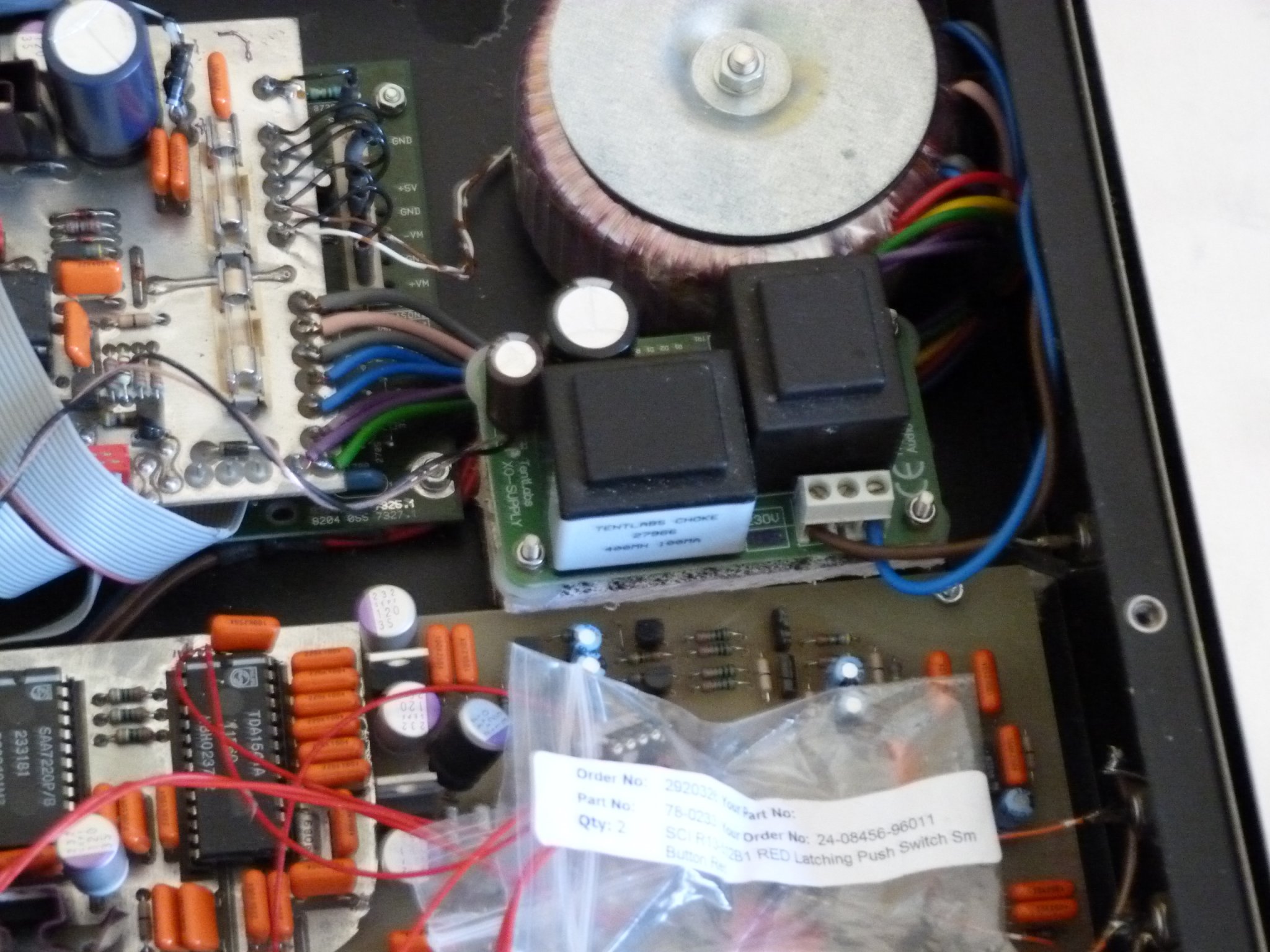

PSU fitted; glued in with silicone sealer; OK, does nor look professional but I use it a lot, it works well.
Connector sealed up. Yes, it looks awful! I should be ashamed but I'm not as it works OK. I could not get the cover on, best I could do was to cut it down and fix it as shown and then fill in the space with silicone sealer as strain relief. It works.

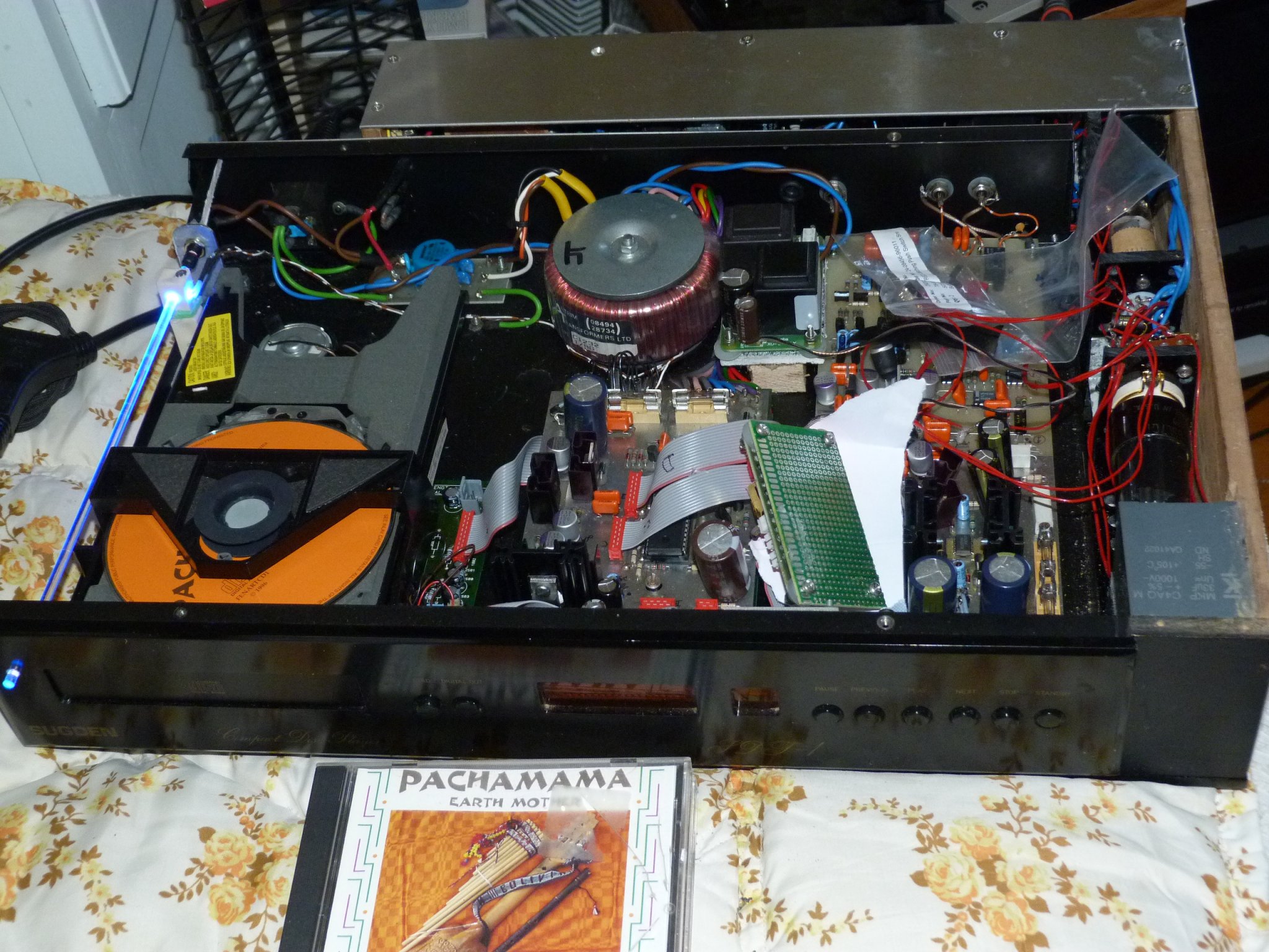

Overall picture. The part at the rear with aluminium cover holds most of the PSU for the valve output stage. On the right you can see the valves and circuit. The clock board is laying there, I'm about to fit standoffs and secure it.
Bases fitted.
