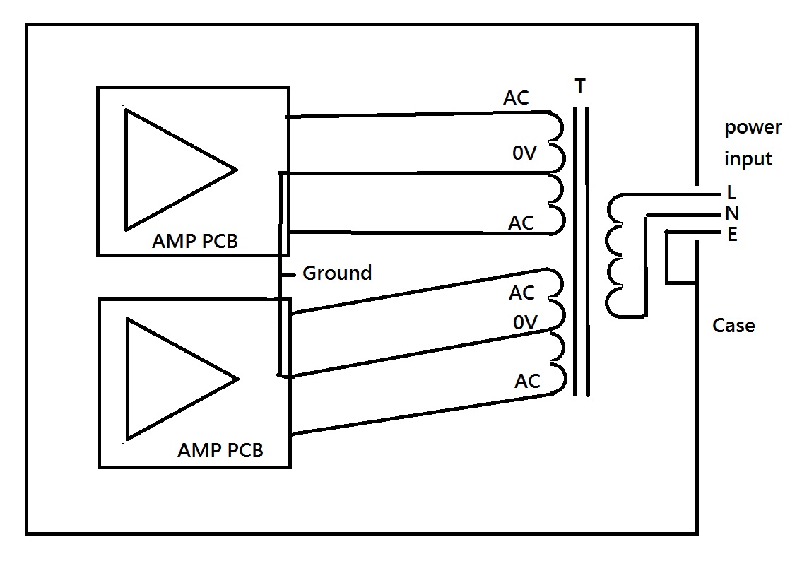

the two PCB ground should connected to a single point of the case and the connection should be short and same distance from each PCB will be best fit
I thought since the PCB is screwed into the case, that would ground them, but looking at the PCB more closely, it seems the screw holes arent connected to anything.
Is this likely to be the cause of the problem, the right side PCB is currently working fine, with or without the gnd wire connected to the case.
Amp internal circuit must need a suitable grounding, otherwise different kinds of noise will be introduced to your amp.

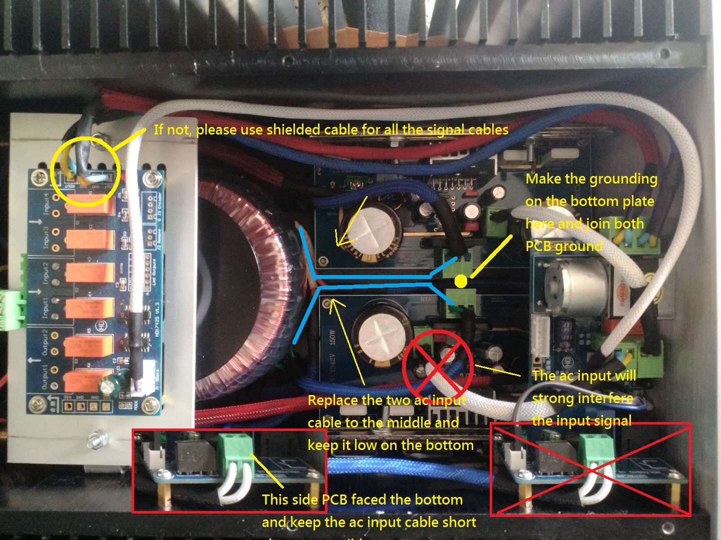

Maybe the ac input cable on the top PCB introduced noise to your amp, you may move that PCB close the power transformer.
I'm a little confused how I would do this, could you direct me to a picture of it in practice?

so I should connect the 2 Ov from the transformer together and to the case as per your diagram, and also wire the ground from the power-in to the case?
I added this at the back of the case just before the issues started, but since a number of other things changed at the same time I wasnt sure if it was better or worse for it.
I make this diagram, hope you can understand how to wire the ground.
Just connect the "PCB 0v" to the ground where I point out before.
How to ground inside the amp is not easy to explain, not just simple 0v connect to ground, please google more info about it.
