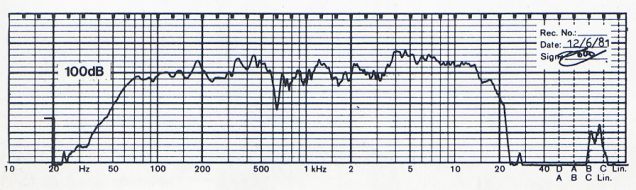

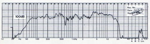

by compare the frequency response of follow both drivers result for me is, that Precision Devices' PD121 is a good replacement:
http://www.fane-international.com/downloads/Fane AXA STUDIO 12L Data Sheet.pdf
PD.121
I need the 16 ohm version (4 pcs.).
The main difference to the PD121 are present at Mms (65 gr instead 32 gr) and VAS (66 liters instead 121 liters)

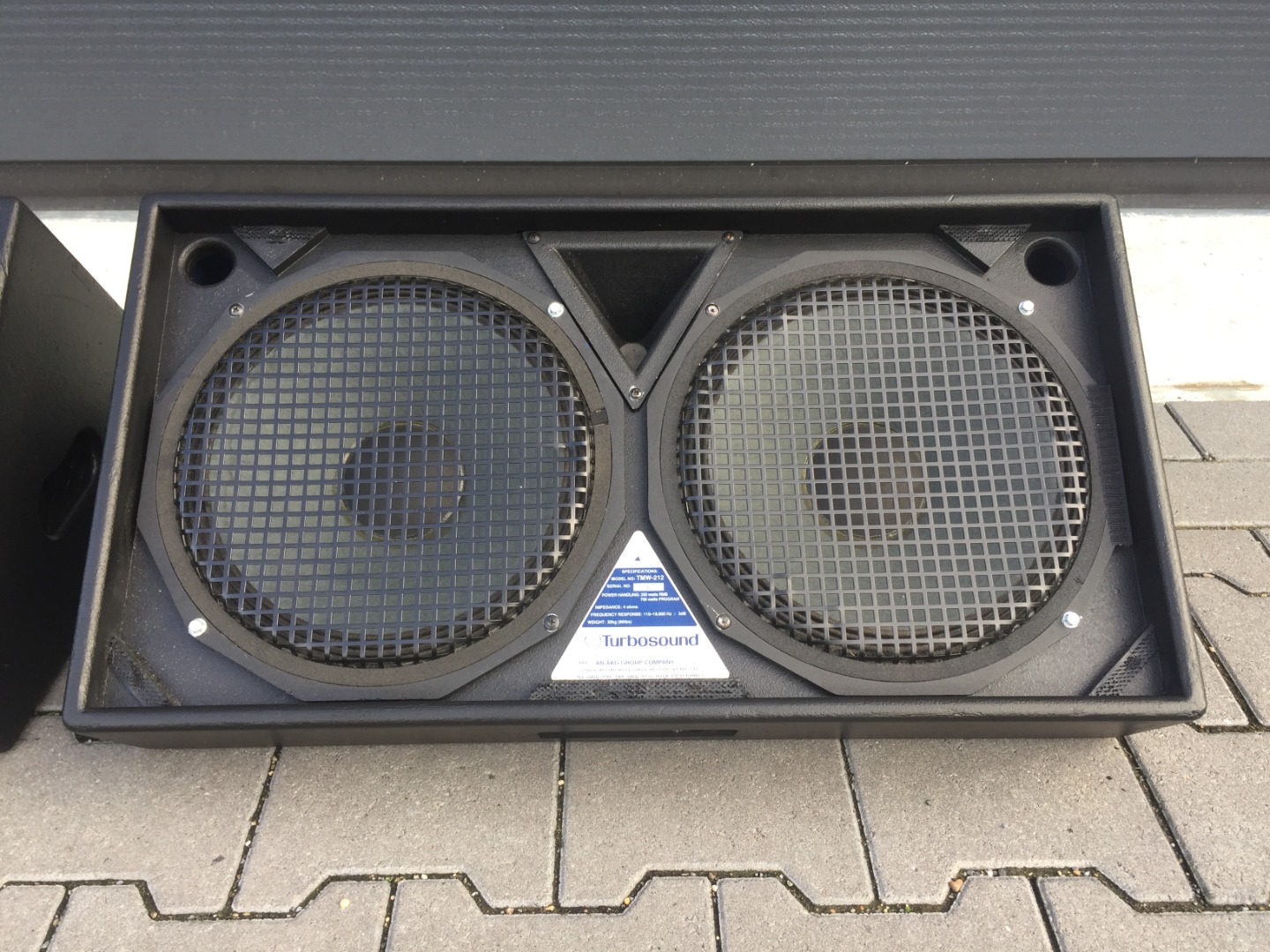

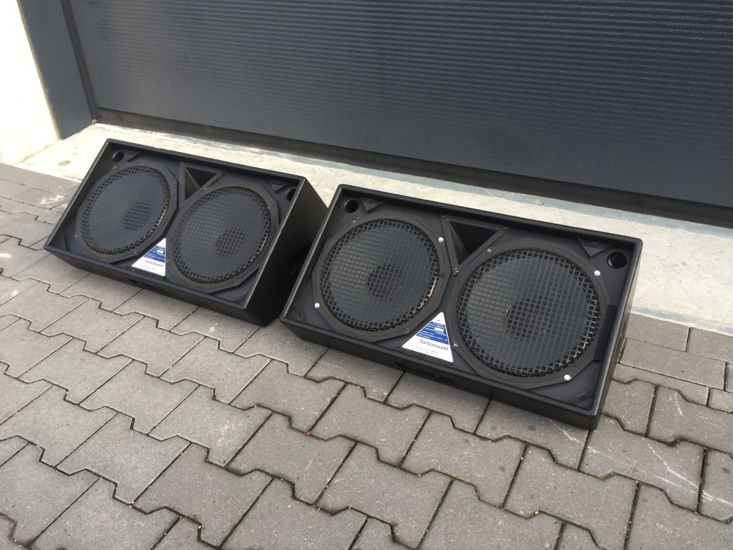

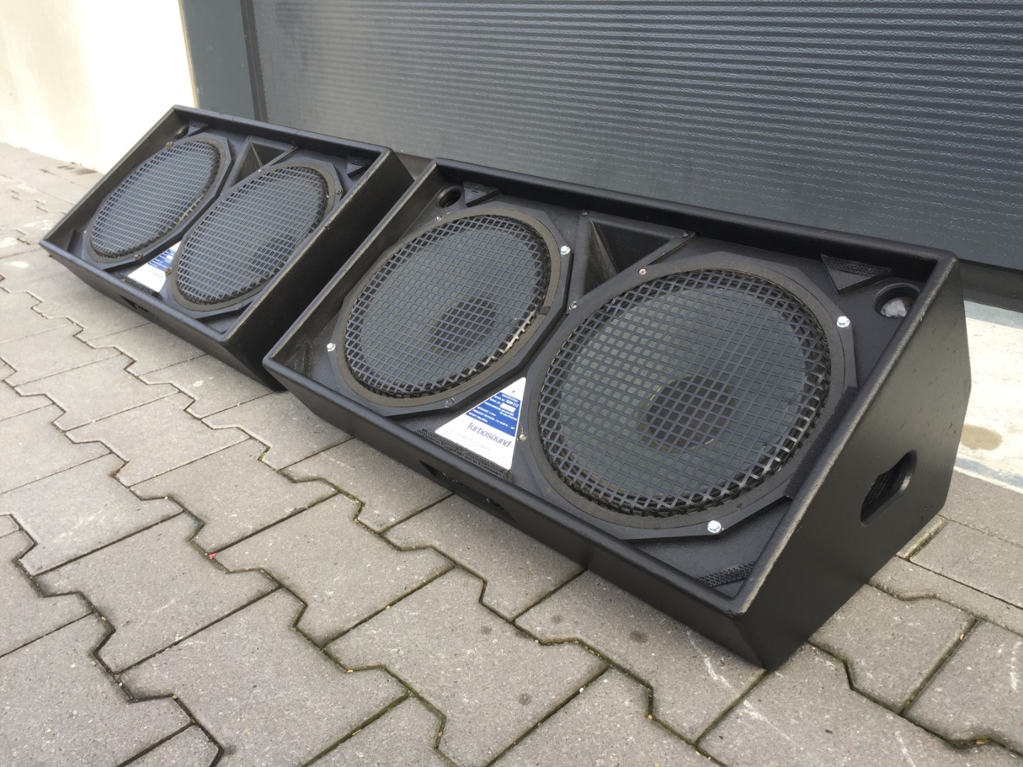

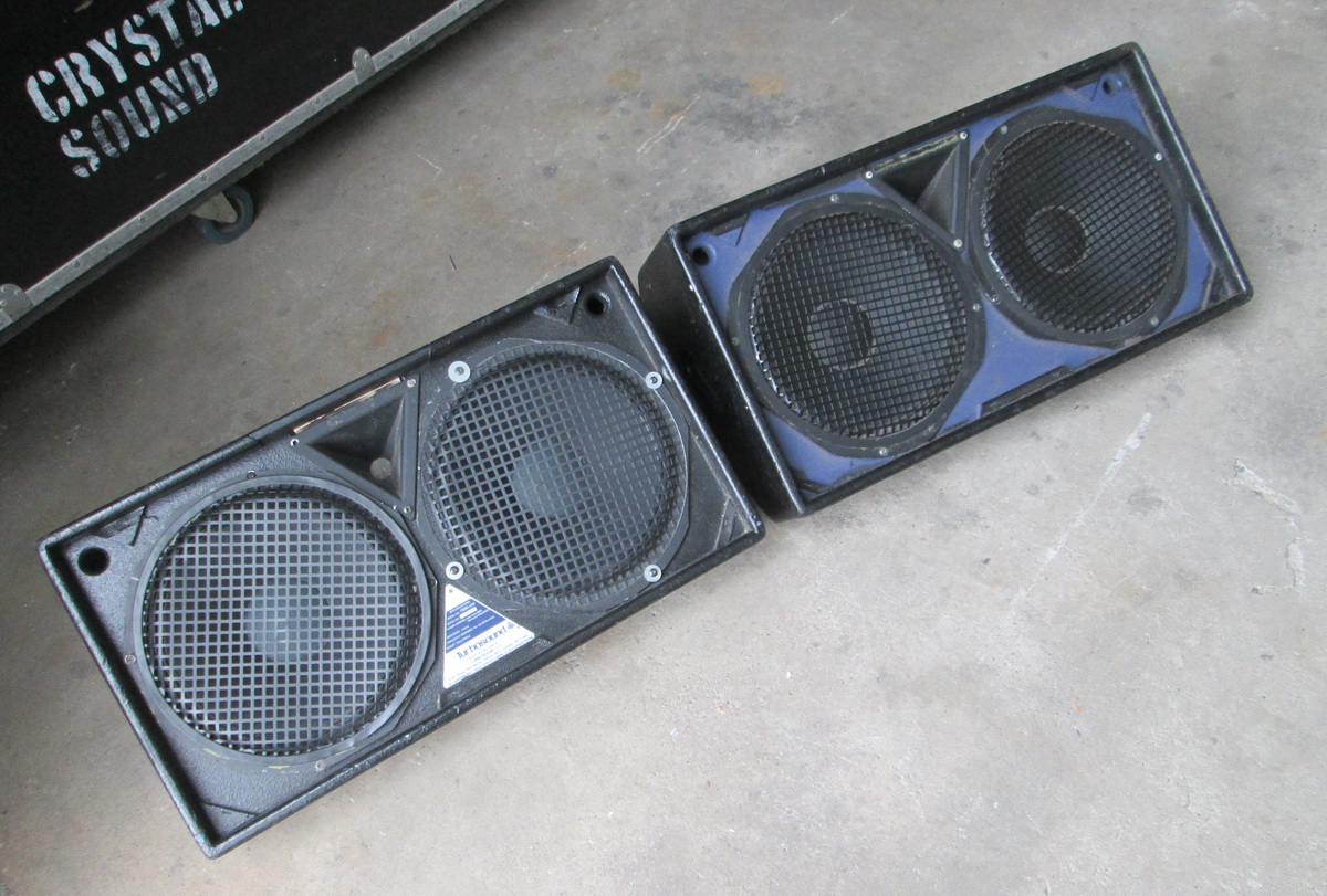

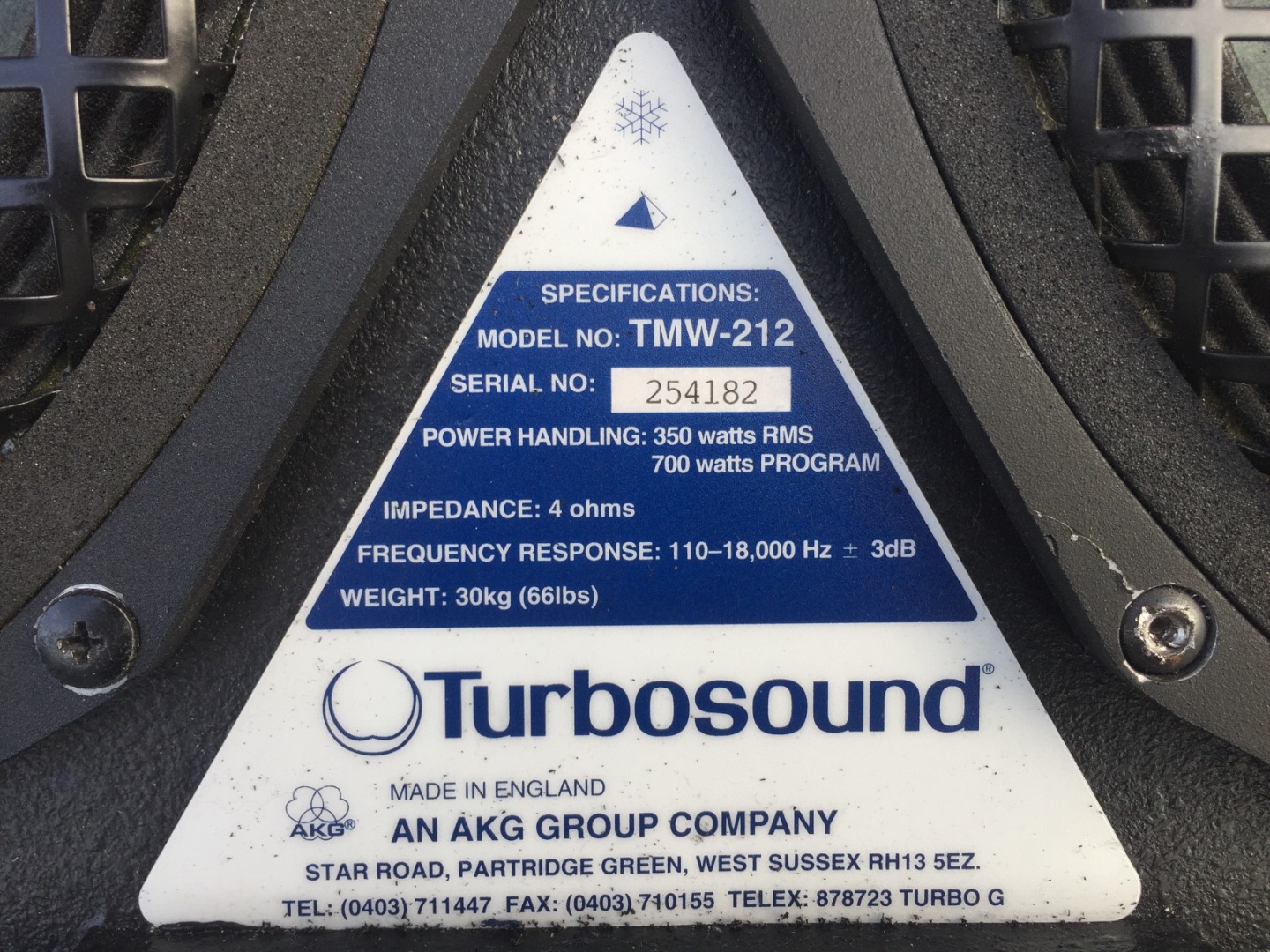

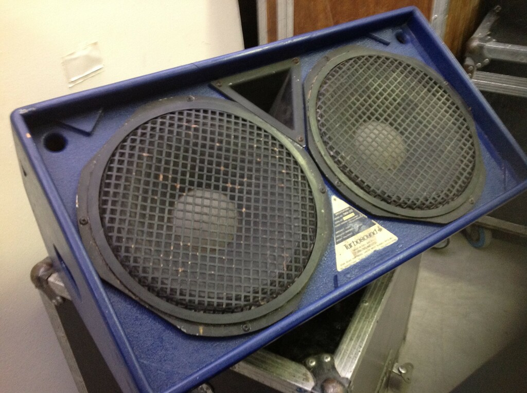

Turbosound verbaute in den TMW212 Monitoren am Anfang die Fane Studio,
später dann PD-Treiber, die dem PD121 in ihren Specs sehr nahe kamen. Ich habe bei einem meiner TMW die originalen (FANE Studio 12) leider
tauschen müssen, und bin mit den PD121 sehr zufrieden, denn sie haben eben genau im Mittenbereich ein sehr homogenes Klangbild.
Translation:
Turbosound equipped their TMW212 monitors at the beginning with Fane's Studio 12 - and later series PD drivers, which are very close to the PD121 in their specs. I have the genuine FANE drivers replaced by the PD121 and I am very satisfied with it because this driver from Precision devices have a very homogeneous sound character particularly in the midrange.

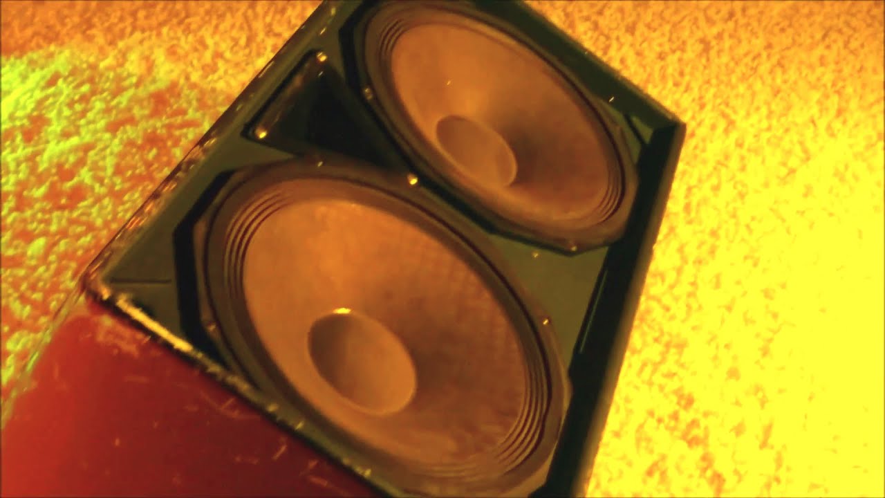

According the attached images is this claim correct.

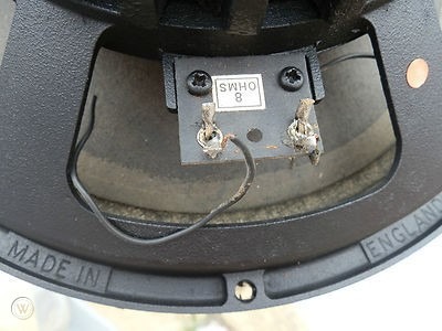

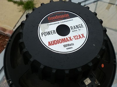

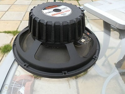

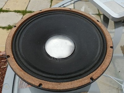

these look a bit like the goodmans audiomax12, although the goodmans is more efficient, one of the most efficient 12" speakers ever.
this from the attached images ?
