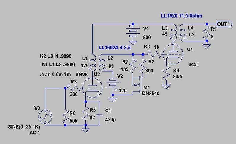

Does any one have any success using a 6HV5A in position V1 in a cap coupled, two stage amplifier? I understand that this is a difficult tube to tame since it is happiest wtih a high voltage on the plate and multiple grids.

In terms of tube tracer and curves, see here: http://vinylsavor.blogspot.com/2011/07/tube-of-month-6hs5.html
Single ended, class A, output tube would be 845; 500v (preferred) up to 1kV.
Output voltages of signal source: 2v.
Yes, those reminders that brought you back are those things that are keeping me involved with tubes. Wonderful inventions.
Lotsmorebetter,
There are few schematics using the 6HV5 as a driver online with a search which should be enough to get your started.
I used one to drive a 211 SET amp with a B+ of 1,200V. Worked quite well but crawling infants meant I deconstructed it years ago and I cannot find my notes. I'm sure the 6HV5 was choke loaded and cap coupled. I had a few high voltage bench supplies so I experimented with some A2 designs. I ran it as a spud amp for awhile.

Thank you for your suggestions. I know of Jack Eliano's use of the 6HV5A in his 845 configuration and I also know that he no longer uses it for some reason. I also read Thomas Mayer's blog a while back, but I could not find a schematic.Lotsmorebetter,

Hello MattLotsmorebetter,
There used to be an Italian tube site, Anza High Tension, that I can no longer find, he offered a few 6HV5 schematics as did Jack Eliano of Electra-Print. You might be able to unearth those on the Way back machine. Thomas Mayer on his blog has a few as well, <https://vinylsavor.blogspot.com/search/label/6HS5>
Matt
"Ansa" not Anza": https://ansaht.com/phpBB2/index.php

Piero,
Thank you for the link to Ansa's site. I'm not sure why I couldn't find it but I've loved his experiments and builds over the years.

Thank you for your schematic. I have some questions about your parts, but before I get to them, can you tell me if any part of this schematic be redesigned to allow for a pos/neg. (dual) power supply? I am, like everyone, concerned about Surviving Spouse Syndrome. (Mind you, 100v at a high enough current can still kill).

As mentioned in post #10, if the plate to cathode voltage goes much below 500 volts you will need to drive the control grid positive to get much plate current. In the region near zero volts on G1 it's impedance will vary greatly with the incoming audio input signal. This makes a low impedance drive voltage mandatory. Many years ago I simply connected the headphone output of a Sony Discman between the cathode and G1 while wiring a power supply and OPT between the cathode and the plate. This was truly a minimal parts spud amp but it took all 650 volts of my power supply to drive the distortion down to a listenable level. Power output was three to five watts based on a loudness guess and probably drive level limited. The tube used was not a 6HV5, but it was another version of the same tube with similar curves, probably a 6JD5. There are 5 or so different flavors of these beam triode regulator tubes that only vary in pinout and plate dissipation, 35 or 30 watts.
If that's the case, then perhaps the 845 can use a pos/neg power supply and use another tube in v1, like maybe a 7905. I know my question was originally about using the 6hv5 but now I am rethinking it because I like the idea of a pos/neg/ power supply-- it simplifies many design problems.
I don't know what you have in mind, but I don't see how a bipolar power supply would make things simpler. I ran my 845 amp on 1050 to 1100 volts of B+ to make a little over 30 watts of power with the last 5 to 10 watts well into the A2 region (grid current). It took over 300 volts peak to peak of drive to get that power level. I used a 45 tube running into a CCS load with a plate voltage around 300 volts and a mosfet follower buffer to drive the grid of the 845 to get there. The 45 was driven by a 5842. The whole driver was simply a TSE board.
A lower voltage, lower powered amp would need less drive, but you are still looking at 200 volts peak to peak or more. A single stage triode would need a near ideal load and a Mu of well over 100 to get there. The 6HV5 could work, but a lightly loaded pentode like a 6V6GT, EL84 or maybe an EL34 would be where I would start.
Any time you run a single tube at high gain you run the risk of microphonics. Pentodes are worse than triodes, and physically larger tubes are worse than small ones. They should not be bad at gains in the 100 V/V range. I made a pentode stage in a guitar amp with variable gain. At gains in the 1000 range it will pick up your voice if you talk to the input tube. It is useless at that level due to acoustic feedback. The tube is an 18FW5 (an 18 volt 6AU6) running into a gyrator load.
I ran this thing foe a couple years in Florida where there were no young kids to get near the amp. Its main drawback was the 500+ watts of heat it put into the 100 square foot room. Here I have curious grandkids that haven't got a clue what my stuff is, so the deadly tube amps are well hidden or gone. After sitting around unused for over 15 years, I just sold the whole 845 amp for $200 at the Dayton Hamfest.
I cannot answer your question.Thank you for your schematic. I have some questions about your parts, but before I get to them, can you tell me if any part of this schematic be redesigned to allow for a pos/neg. (dual) power supply? I am, like everyone, concerned about Surviving Spouse Syndrome. (Mind you, 100v at a high enough current can still kill).
Thanks.
I am writing in English by translating my thoughts into Italian through an automatic translator, which often distorts what I want to say.
The project I published is not mine, but a project I saved in a personal archive of other audiophiles' DIY projects I found on the net.
I cannot say anything about the goodness of its design: it could be a valid and well-tested design, as well as a hypothesis of some improvised DIYer.
The post only wanted to underline the fact, now established by many who have used the 6HV5A tube as a driver in amplifiers with 211, 845 and other tubes with similar characteristics, that for hi-fi audio use the tube needs to be used with a minimum voltage of 900 volts.
