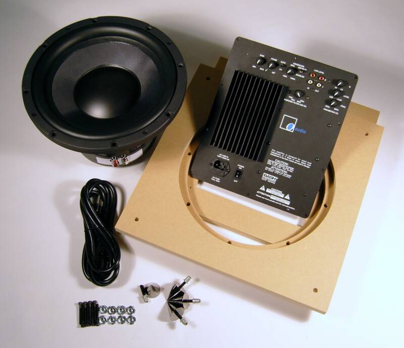

CSS SD12 Sub with baffle
You can get the CSS SD12 12" subwoofer with an amp and a CNC baffle at www.occamaudio.com
Re: CSS SD12 Sub with baffle
That might make sense if Kelowna wasn't a short drive (~3 hr) from Bob's. Besides the Occam baffles are MDF. Seems a waste of energy to ship the driver to the USA from Abbotsford then back across the border to Kelowna.
Both the SD12 & the SDX15 simply use 2 pieces of 3/4" with an appropriate hole in them. The hole in the outer piece acts as the rebate.
Both of these are excellent, and even the 12" moves a lot of air (in my big room, a pair of SDX7 does a credible job).
I would recommend the sealed boxes -- the purpose of the vented boxes are for HT people that want a big bump at the bottom.

jeff k said:You can get the CSS SD12 12" subwoofer with an amp and a CNC baffle at www.occamaudio.com
dave

OK, so here's where I show my ignorance (again!). Assuming I find a suitable amp, do I simply hook it up as Sub Out from my HTAmp to a Line In on the Sub Amp? Then I would drive the Sub from the speaker out of the Sub Amp. My understanding is that the Sub Plate Amps take care of the frequency cross over.....I suppose I will have to take care of this myself if I follow the advice from DANGUS? ....and this means that I need to design/build/buy a suitable cross over for the sub? I am intrigued by the idea of using another component amp for the Sub, but will need to figure out exactly what this involves as the plate amp (or a dedicated sub amp) certainly seems easier.
Bob Reimer said:Hi,
The Occam products are available from CSS for Canadians as the website makes clear. We try to minimize shipping cost wherever possible.
Bob
Thanks Bob
I will likely be contacting you - after I figure out what I am doing....
APLJaK said:OK, so here's where I show my ignorance (again!). Assuming I find a suitable amp, do I simply hook it up as Sub Out from my HTAmp to a Line In on the Sub Amp? Then I would drive the Sub from the speaker out of the Sub Amp. My understanding is that the Sub Plate Amps take care of the frequency cross over.....I suppose I will have to take care of this myself if I follow the advice from DANGUS? ....and this means that I need to design/build/buy a suitable cross over for the sub? I am intrigued by the idea of using another component amp for the Sub, but will need to figure out exactly what this involves as the plate amp (or a dedicated sub amp) certainly seems easier.
A modern HT amplifier will have a subwoofer out which has a low pass (cross-over) function applied to that. In addition the plate amp will have its own crossover. So you actually have 2 XOs (for this situation you just turn the plate amp XO all the way up -- some may allow you to defeat the XO.
