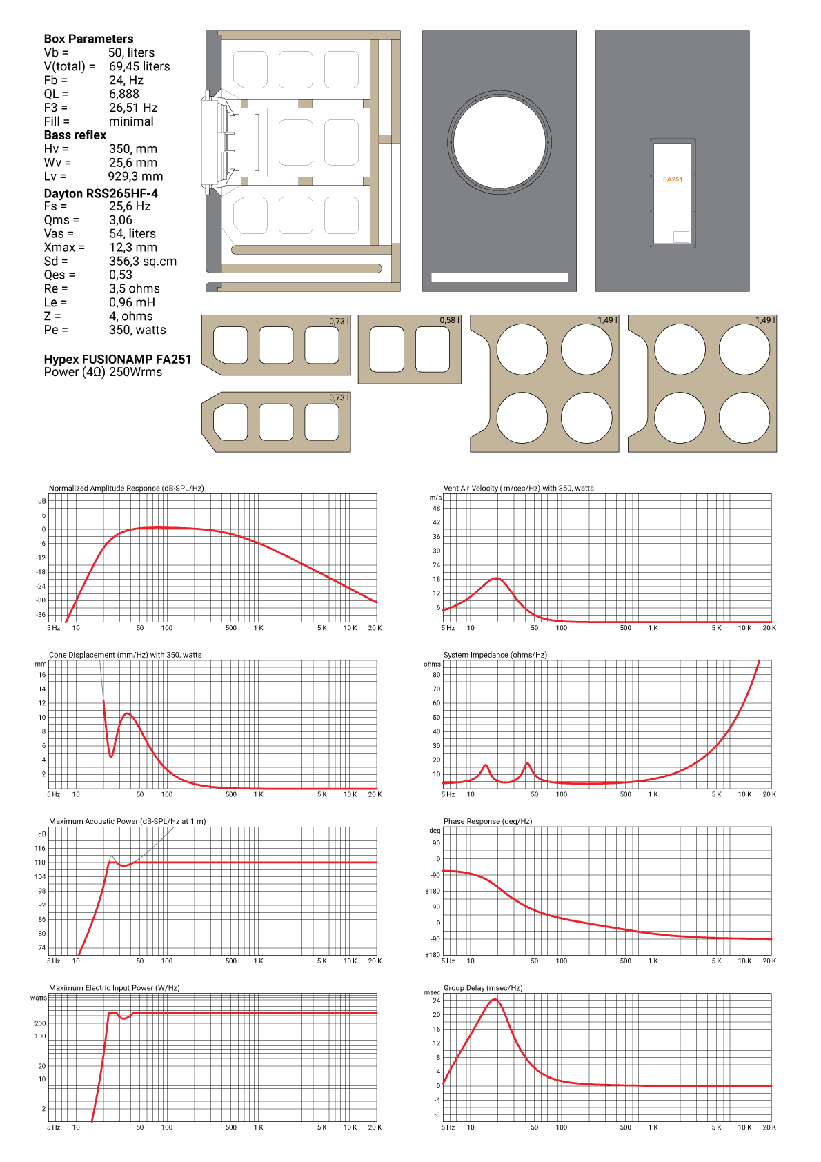

I would like to build a new subwoofer. I designed a subwoofer with the Dayton RSS265HF-4. I calculated a lot of combinations. I would like to share this with you. And I'd like one of you to look at it and comment on the charts. Did I make a mistake somewhere? Could it work well like this? In short, I will list the basic design parameters.
The volume of the box is 50 liters (1.77 cubic feet). The width, height and length of the bass reflex slit are 350 x 25.6 x 929.3 mm (for those using inches it is 13.77 x 1.01 x 36.59 in). Tuning is set to 24 Hz. Box is heavily braced. Construction is made from 22 mm MDF. Front baffle is 44 mm thick.
I will feed it with the Hypex FUSIONAMP FA251 amplifier. It has a power of 250W RMS at 4 Ohm.
In the attachments you will find graphs and a design. You would be very helpful if you looked closely at this experiment. I don't need a new subwoofer, but I really want to. So when I'm going to throw away a lot of money, I want it to play well.

Have you calculated the port velocity? I think it will be ok looking at the port dimensions, doubt it will exceed 35m/s (tenth of speed of sound is typically used as absolute max)
I think the folded port might lead to a slightly lower tuning frequency (effectively extends the port). Also, good practice to compensate for the increase in cross sectional area at the folds, by using triangular pieces for wood for example.
Reactions: DblAA

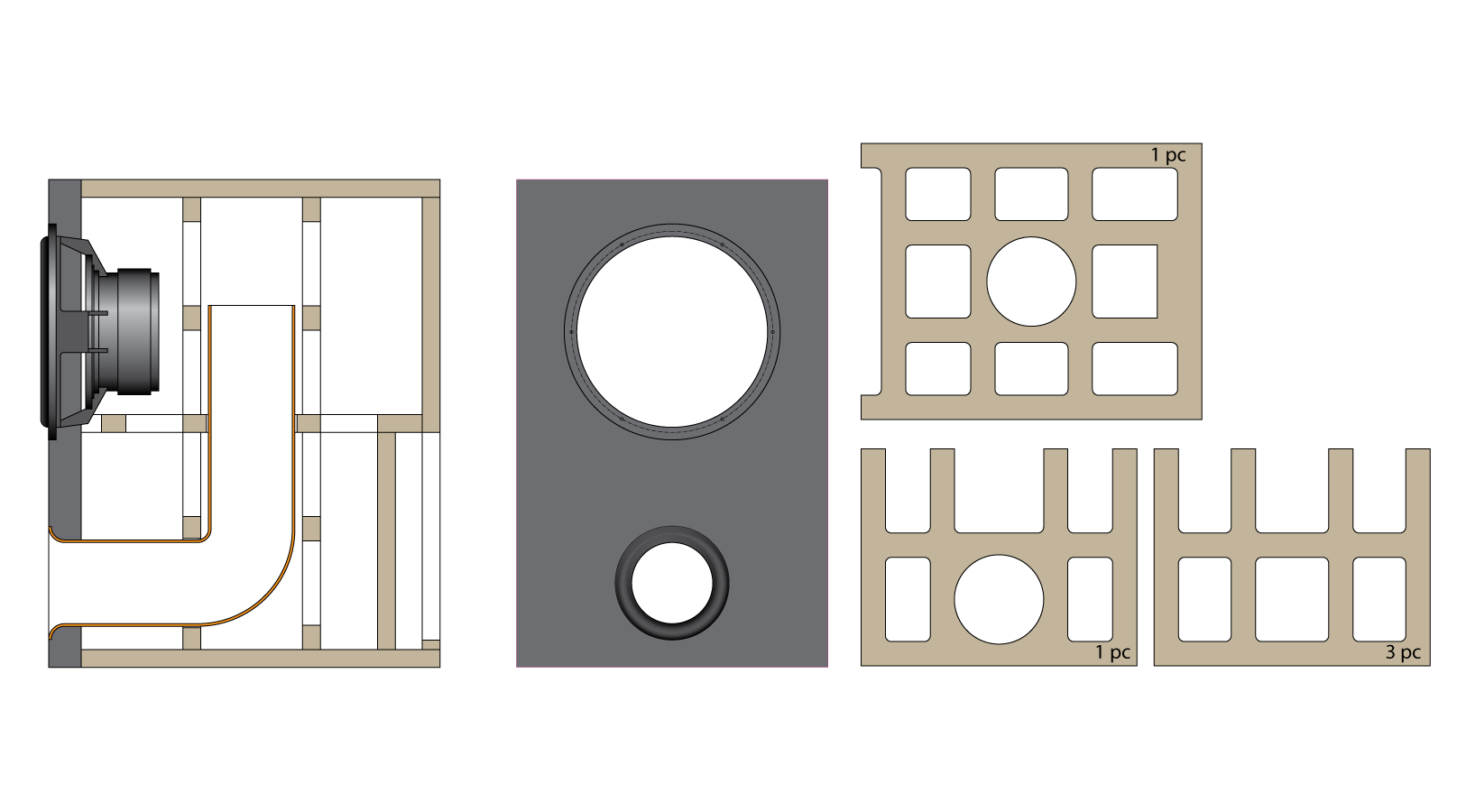

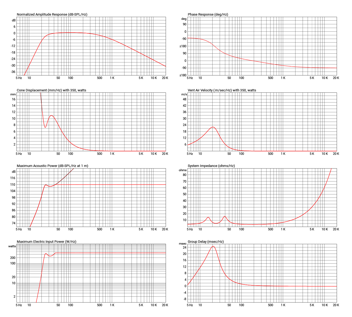

Thank you Mart34.
I'm not sure about that slotted port. I will definitely fill those corners in the tube as you suggest. I also cover the top and back walls with soft felt.
But my dilemma is a little bigger now. I also prepared a design with a classic port. Won't you help me with the decision, please? Is there less risk of going with the slotted port design or a classic PVC pipe? This second design off subwoofer box is in attachment with charts too. Advantage of second design is that in same total volume Vb is little higher. The big disadvantage is that I have no experience with gluing plastic pipes and I am afraid that the joints in the pipe will crack.

I always wanted a 6" Precision port but couldn't figure out how to bend it. Was tempted to build a mitre specifically to cut it at the required angles. I opted for slot port in the end as it increases rigidity of the enclosure and was easier to build. Not sure what round port size you have there, might be able to find a 90 degree elbow or two 45 elbow, if its 3 or 4 inch.

Hi Mart34.
Fortunately, in our country, a 100 mm plastic oven is a common item. Even with 90 degree elbows. But I'm 99 percent sure I'm going to make a slotted version. Unless no one convinces me with another argument. The speaker and amplifier arrived yesterday. That speaker looks amazing! On the contrary, I was surprised by the amplifier. It is surprisingly light and small. In reviews, however, they rate it very highly. So I'm satisfied. Unfortunately, I have unexpected work around the house. So the construction of the subwoofer will be a bit delayed. At least I can learn how to tune the bass port. I only have a calibrated microphone ready for it. I hope that will be enough. Or should I prepare to purchase additional equipment? How do you measure your speaker boxes?

Hi Mayok, I modelled your slot port design in Winisd, and it corresponds with your design sheet, -7dB at 20Hz, approx 10mm cone excursion and approx 20m/s port velocity.

Your frequency response looks good. If you wanted some more low end for movies in Home Theater, you could make the box larger. Will be perfect for music, and you'd still get plenty of low end extension with your design anyway, especially compared to even large floorstanders for example.
Most people run the port across the bottom and then up the back wall rather than trying to fold it, I think 90 degree corners are something of a “stay away from” if possible, something about slowing the air speed but not increasing length?.?. It could also simplify your build, less cutting. Nice design though.
