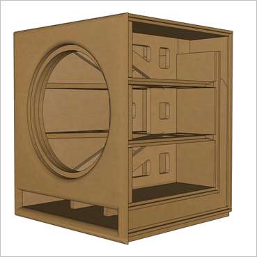

I once got given rough dimensions on a 24 x24 x48" cabinet with a 15 or 18" sub and a 1000w amp that will play happily at 18hz, and that every movie one has watched will be watched again with a proper sub.
I'm a carpenter so the build isn't an issue if I have a drawing, but if possible I'd rather buy a kit. To keep things on a shoe string budget what's out there? There was good stuff 10 years ago, there must be some nice budget builds out there now? How about a kit from Dayton audio, they say they are tuned to 20hz

Do note that, especially for subs, stiff with (potential) resonances pushed high in frequency wher ethey will not be excited. This means that MDF is one of the worst materials for subs. And i suspect if the kit comes with a box, it is likely MDF.

I fit 4 10s in 2 columns about 15x15 and 44 litre internal. If you find an 18” that fits in less than 88 litres likely means it does not go low or be very inefficient.
Remember that a push-push woofer requires 2 drivers.
Some of this illustration is not relevant at the frequencies produces by a sub
How much room do you have? Can you accomodate 2 smaller woofers?
No clue about kits as they pretty much went away with the rise in DIY and mobile audio becoming the main outlet for 'subs' with many manufacturers providing plans and pre made boxes, so best to DIY for HIFI/HT apps.
So 1st, what's your performance goals? Without this, no way to decide on type/# of drivers required.
