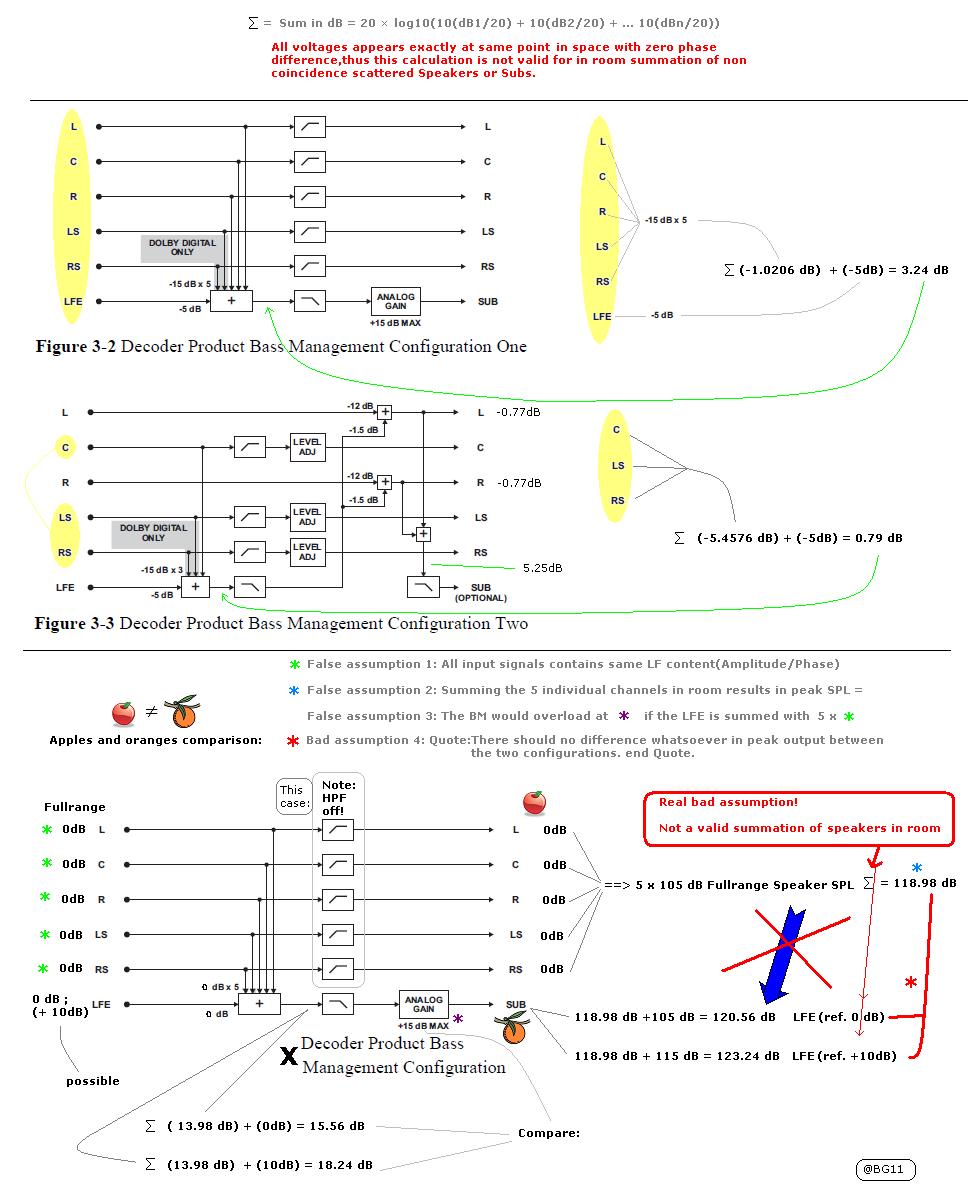

Hi guys,
I'm stumped and I need your technical expertise. I attended a Cedia Home Theater Design function a few days ago and the Cedia instructor told us that the maximum dynamic peaks for each main channel in a home theater set up is 105 dB's and the subwoofer is 115 dB's (assuming you calibrate to 75 dB's at the listening position).

The "reference" is 105/115dBSPL peaks at your seat with a 0dBFS peak input signal. Distance and room gain must be factored into the equation for a clear picture of what the sub is really doing.
75/85dBSPL is not the "reference," just the measuring stick. A mile is still a mile when measured with a yardstick, or a meter stick.
You have coherent and incoherent electric signals. Most summed signals from different channels will be in-coherent to a large degree. During testing the only time it was close to being coherent, near a 0dbFS situation was between the R & L Mains, or a Center to R or L combo.
Electronic signals carrying multiple frequencies of sound at the same time are tricky. You have to think a about the infinite variations of amplitudes each individual frequency could be at, along with it's position in time(phase,) which are summing together to create the single level, at any one point in time. Now sum two together, and depending on the mixture the overall signal level may not increase more than a 1/4dB.
Also, adding in the fact that the DD processor itself only allows 5dB of headroom before clipping on the LFE channel throughput for the added BM, and you can see why someone would say it doesn't make much difference.
All that said, the burden on the subwoofer does go up when BM is engaged. More so in the intermediate SPL areas than at the absolute peaks though. If your sub could handle "reference" levels with no clacking in your setup without BM, it should live happily with BM engaged for the most part.
This assumes the proper use of a HP where needed, as the below 30Hz content seems to create the biggest burden on the sub with BM engaged, as there is a lot of low frequency content in the front mains absent from the LFE track, that the sub is now tasked with.

It is additive. Have you heard of Pan's Law ? The rest of your post I didn't follow.
Pan's Law isn't quite the same thing. Pan's Law deals with the output from the loudspeaker. Originally, a stereo pair.
If you play a signal of a single keyboard note at a set voltage on one speaker you get a set SPL. If you pan the signal dead center, and apply the same voltage to both speakers you get up to 6dB of extra total SPL in room, as you now have two sources playing the same exact signal.
If you instead paned the keyboard note to one side, and played a note from say a sax at the same voltage on the second speaker there is no real increase in SPL, as the two signals are not exactly the same.
In a BM situation you are not doing this. You are taking the two signals, and adding them back together. If they are exactly the same you get ~6dB extra if they are at the same amplitudes. If they are at different amplitudes you get less of a signal increase over the larger input.
If you sum the keyboard, and sax tracks together you won't get much of a signal level increase at all, as the frequency make up is different.
Soundtracks are more like the latter, as the LFE information is not a carbon copy of the bass on the other tracks. It has its own frequency makeup in its own time domain. Likewise, the other channels are rarely ever doing the same things at exactly the same times, other than some panning across the front three.

OdBFS is the digital ceiling.
The first step in the processor is to reduce the LFE channel by -5dB. If BM is active the re-routed signals from the main channels are reduced by -15dB, and summed into the LFE channel.
Thus, there is only a 5dBFS window above the standard LFE ceiling before clipping the DD processor. The +10dBFS that is talked about happens after the processor in the analogue domain. Where the LFE is bumped up +15dB.

Umm, yeah there is. The peak levels your sub will see will be different. Are you saying there is no increase in SPL now when channels are summed? 😉
The only difference is that the sub will have to handle all redirected bass + LFE. If that means an extra 5-6 dB's of additional headroom, it's pretty darn significant to me.
So the sub will need to play higher SPLs, but the peak level will remain the same? Think that through again.
That isn't to say that you will require 120 dB's but that it's the maximum possible peak level requirement from the sub at reference level with BM engaged (assuming a flat calibration).
Now you are saying the peak level will be higher?
Well I don't know about that. If the sub requires 123 dB's at reference level that's a pretty big pill to swallow.

dB Pascals
115.00 11.246827
105.00 3.556559
105.00 3.556559
105.00 3.556559
105.00 3.556559
105.00 3.556559
Summed Value dB = 123.24
If there was a simultaneous 0 dBFS peak in all 5 speaker channels and in the LFE channel, and if they were all routed through the same transducer (i.e., the subwoofer) in order to avoid phase cancellation issues, they will sum to 123.24 dB. Actually if you route the redirected content to multiple subs, that's even better. But the fact is, you need one HECK of a capable sub in order to do this.

The answer here is that you are both right, as I tried to explain in my first post. The LFE "reference" level does not change because BM is activated. It is a reference point it, as such it does not change. In that sense it doesn't make much difference, in fact it makes zero difference.
The amount of SPL the subwoofer is asked to reproduce does change though. If your sub can't handle the new load you won't be able to play "reference" levels. It will be the lower frequencies that will determine the subs abilities to keep up, as all subs are program SPL limited by their low end capabilities, and using BM tends to alter the low end signal makeup more so than the higher frequencies.
You will never have a full strength exact copy of a bass signal present on all channels on a commercial disk. You won't find it across the front three, and LFE either. If you want to play hypothetically, you would find that with BM turned on with this full-on signal you would just clip the LFE/BM channel out, as it is limited the LFE dynamic range plus 5dB. See the link in my last post to a dolby paper explaining their DSP engine throughput.

conditionals make all the difference 😛 Yes, if you are playing the same tone through five separate speakers which would give you additive summing in room, then if you asked the sub to reproduce that effect it would need to produce a spl that would simulate the in room summing.
Thing is... there are compressor/limiters on the LFE+BM circuits to protect the sub from such demands. When you sum LFE and BM you get less low frequency sound in room because of the compressor/limiters than if you kept them separate, ie. pan law.
I've heard an optomized HT that had truly full range (20hz-30khz) speakers on all seven channels and it was truly moving (pun intended) when a coherent low frequency effect was put through all 7.1
The LFE ch and bass in the other main channels are separate. We can all agree that the LFE on it's own will never exceed 115 dB's no matter what. But I'm talking abouit redirected bass + LFE. If there is coherent bass mixed in a film and that scene requires 118 dB's from the sub + redirecteed bass, then that will be the requirement. If a film like War of the Worlds requires 122 dB's at reference (using BM) in a few scenes then that will be the requirement.
Remember, there should no difference in peak output in the room between BM or no BM. So if the total in room peak is 120 dB's the same requirement should be asked of the sub + redirected bass (ie no limiting of that and no protection otherwise you've just messed up the mix).

Pictured:😀
b🙂
