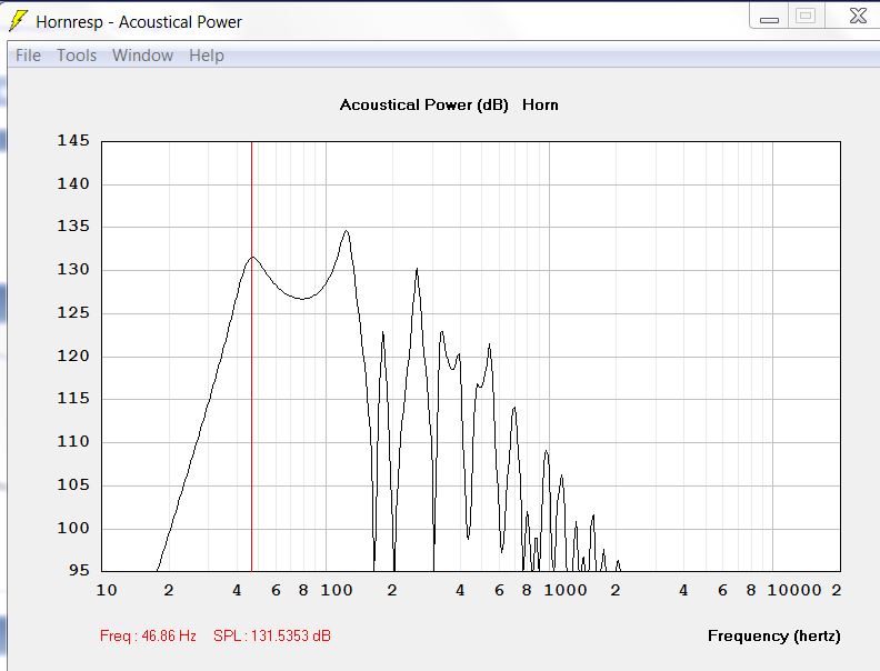

I just built a dual 12 th box that has a 15.5 by 19 footprint that while I tuned it to 35 you could shorten the path to get more 45 and up. Each box handles 1000 watts and the 12 inch drivers cost between 60-100 each. Best bang for buck and especially footprint that I've found.
This is me sliding the horesp sliders to make the design I came up with shorter and slightly wider for a 45 Hz tune. Shown is where I would limit with live music -->transient limit of 75 V should be safe considering the music dynamics being played (staying within mechanical excursion even this high) as 63 V would be my RMS limit for sine wave EDM.
See picture for max power output (single 185 L internal cab translates to roughly 8.4 cu ft external)
Message or respond and I'd be happy to share more about the design. You're looking at 130+ dB from 42- 52 Hz and >127 dB in the trough around 80 which can be eq'ed and may not be as bad as it appears.
Note this is limited to 75 volts per cabinet and assumes the two 8 ohm nominal drivers are parallel.
