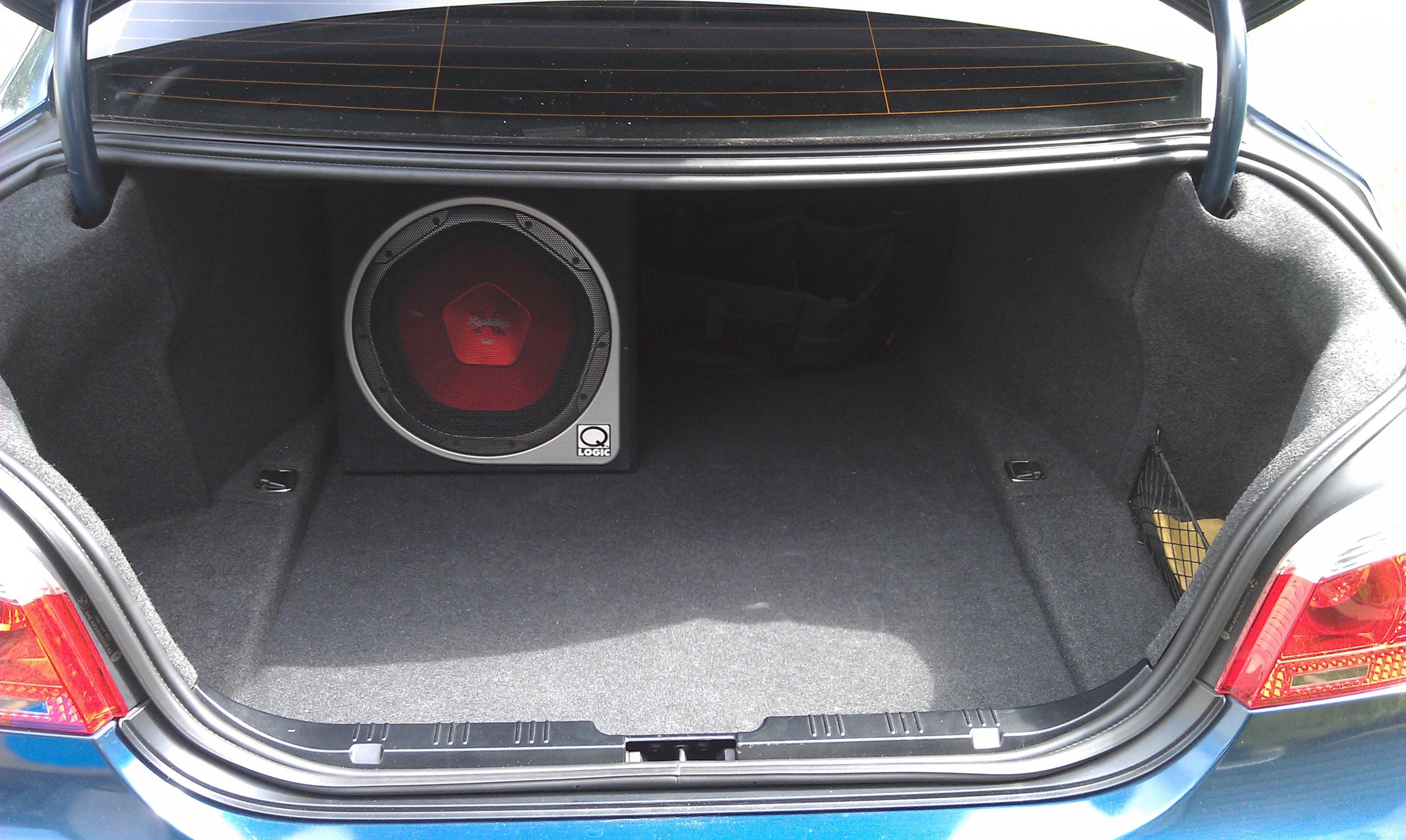

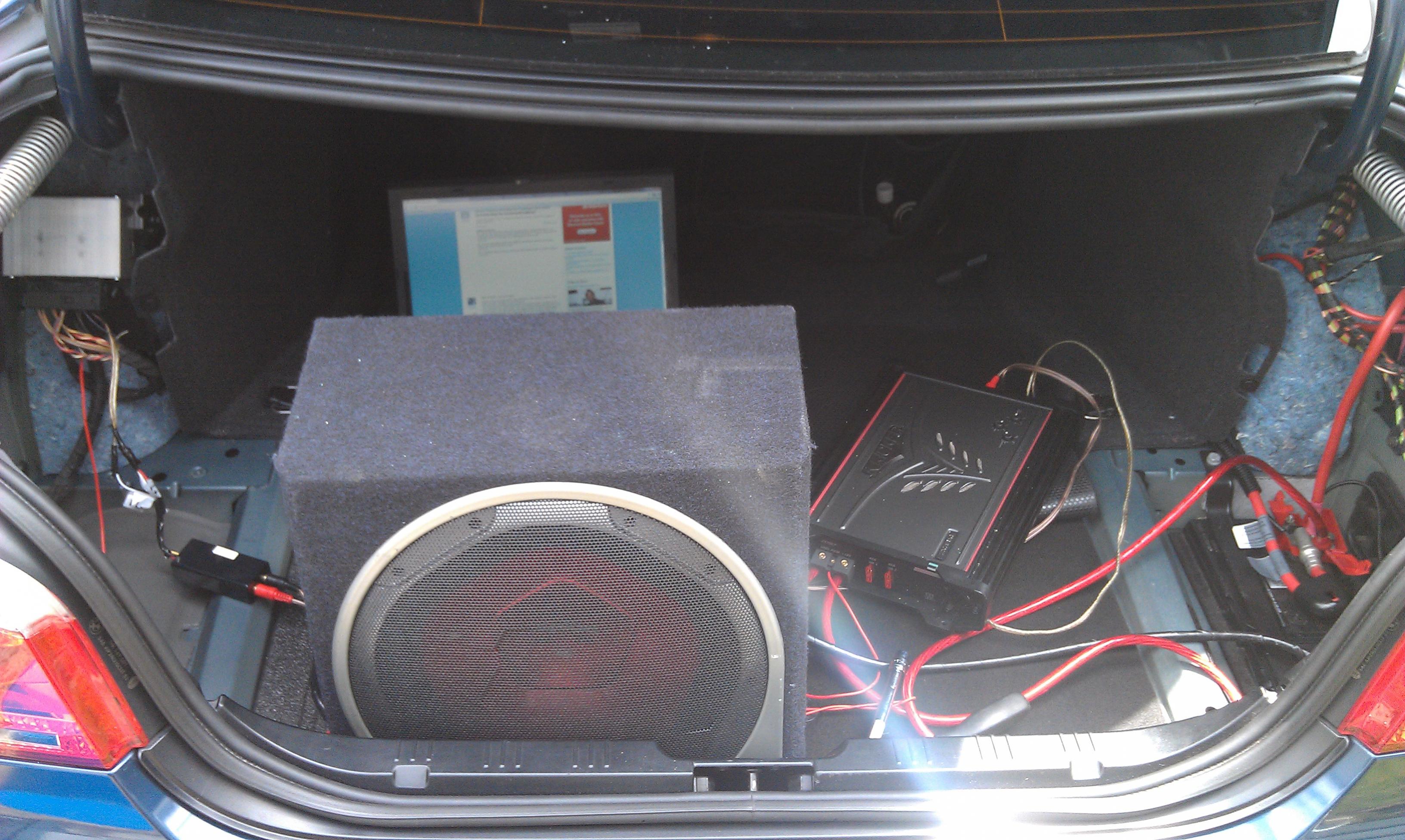

Hello Guys,
I have a Kicker ZX750.1 amp (http://www******er.com/ZX_Amplifiers), with 750 Watt Mono at 2 Ohms (not sure if it is RMS or PMPO... most likely RMS, coz they are recommending 800 to 1500 RMS sub with it), hooked up with one Sony Explode ( I think 380 watt RMS/ 1200W PMPO), in a small tight Q-Logic box. I literally have to keep the gain on the amp way less than half, otherwise it distorts the sound. A number of people have been telling me that the sub woofer is the week link, and I will gain a lot just by changing the sub. I do not want to put two subs, or big box in (kind of like trunk space ), or spend a lot of money on it. However, would like to find out few things before proceeding forward.
1. Would it really make a huge difference just by changing the sub?
2. If yes, what power sub should I get (RMS)?? Most of the subs are 4 ohm, however; the amp says 2 ohm.. does it make difference? To be more specific, any preferred brand/ model? I looked at Best Car Subwoofer, Best Car Sub – Reviews and Rankings | Bestcovery, and the best subs range from 80 bucks to 900 bucks. I read online, many people saying 4 ohm sub will be fine with 2 ohm amp, but what would be the best combo if I just want to hook up one sub?
3. Do you think I will need to replace this box for a more powerful sub?
Thanks again for the help and support .

I do not intend to go for two in future (actually I had two, but didnt really need all that bass, and needed extra space in the trunk as well). For now, I need the best 12 inch sub, that can fit the same box (as I love its size 🙂 ), and that is best suited for this amp 🙂.

According to my calculations, the internal volume would be about 0.83 cubic feet (1436.5 cubic inches). And, I have not taken out the space consumed by the sub yet (i believe there is a formula for that as well, however; I think when manufacturer of a sub states min volume requirement, they do not take that in account.. do they).
So, I guess its small for the Kicker sub, that requires at least 1 cubic feet ...🙁
I think I saw few that required less.. so I have to find one of those 🙂
BTW... I am setting my bench mark for more than 800 RMS at 2 ohm, and suitable for about 0.87 Cubic Feet sealed box (off course 12 inch)...
