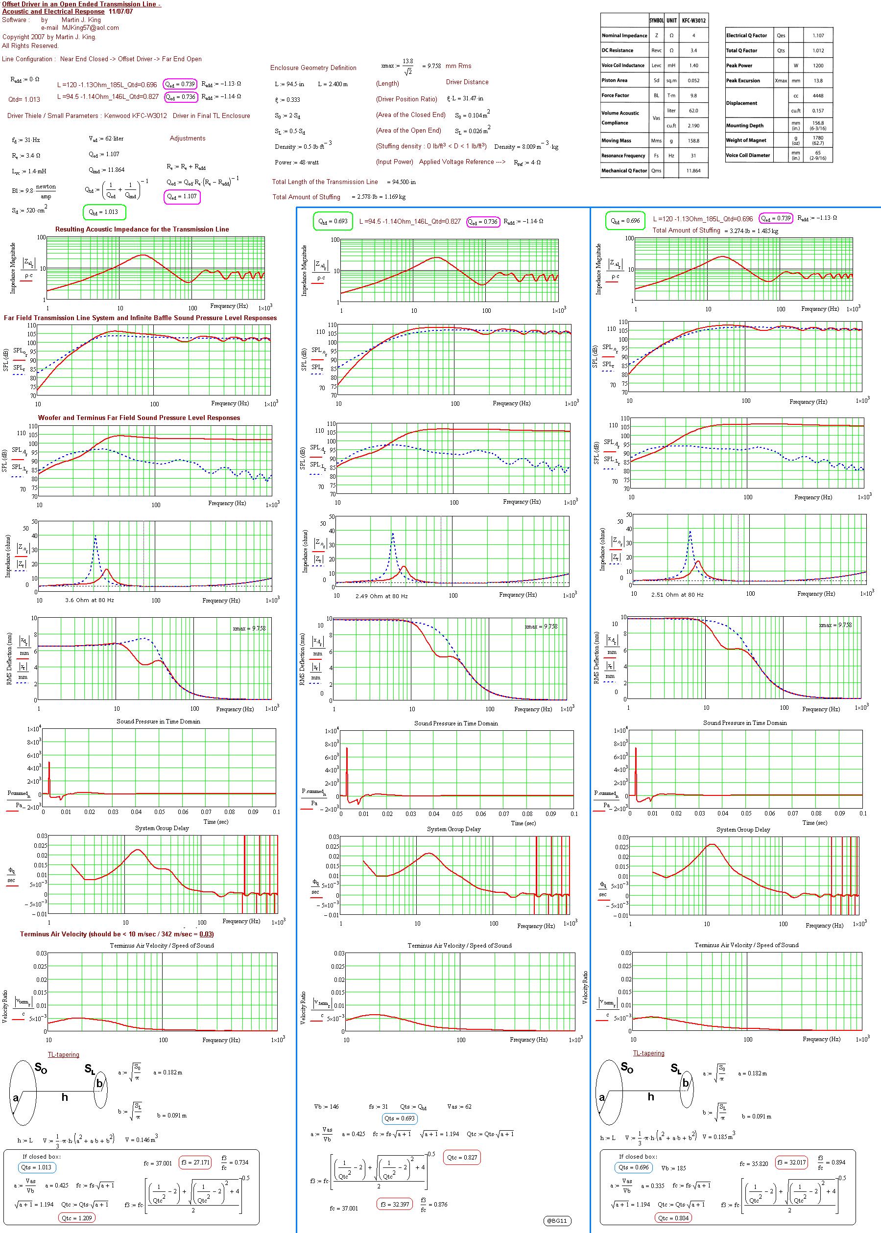

Based on its published specs, this driver wants a relatively huge, well damped sealed cab of around 13.6 ft^3 net for HIFI and due to its low efficiency its bass output will be modest if not in a corner, especially with only ~280 W available, so some type of high pass 'rumble' filter may be required to protect the driver.
You could heavily stuff your 'one note' car audio alignment cab with lamb's wool or similar to reduce the 'thump' at the expense of a much more rolled off bass, but if you have a high ceiling and/or comfortable with building a folded up TL, then your cab could be extended to a ~105"/268 cm long line or in a somewhat smaller bulk if a new rectangular cross section line of ~ 71"^2/457 cm^2 is built.
Stuff with polyfil or other suitable material as required to get a smooth sounding in-room response down to at least the driver's Fs and a bit lower if there's enough room/boundary gain.
