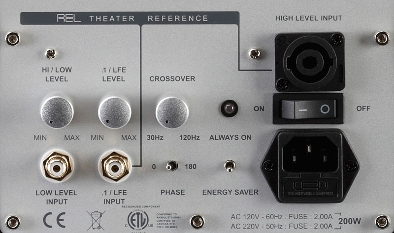

It's to power a REL R528SE Subwoofer rated at 550w power consumption. The other person is treating as they "possibly think" over time, even using the right type of transformer, that it "may" slowly burn the circuits out etc etc but I have stated that, if they do buy one from within the US, then it will work perfectly fine!
And, it doesn't do dual voltages, but for a rather high fee of £330 I could have the whole back plate removed (that I would keep) and to have the US one put in, instead, again, that is a high! fee, I am sure of they bought a step up transformer in the US it would only be around £150 odd.
That is what I thought until I contacted REL, on which they stated no, it is not self switching..
and Ellis post shows 200W !It's to power a REL R528SE Subwoofer rated at 550w power consumption.
The USA will be able to supply an auto transformer to convert the 110/120Vac, to mains equivalent 220/240Vac.
Auto transformers are much smaller and much cheaper than isolating transformers.
The "internals of the REL" equipment still allow SAFE use of the converted mains voltage.
In 1981 I bought the opposite. a 220/240Vac to 110/120Vac autotransformer to operate 110Vac equipment.
It cost less than half the price of an isolating transformer.
If the unit is really 200W, then a 300W autotransformer will have plenty of reserve to run all day and night at maximum audio power and not suffer any degradation.
That is REALLY odd that REL notes two different voltages on the back. So, what they are saying is..."If this was a 110 unit, then use 'X' fuse" oh and by the way, this is not a 110 unit it is a 220 ???? It makes no sense!
Truth be told, since this is rather confusing.....& if I'm right ?? I would put a 110V into this unit......Where does it say 220V only? With the prolific application of switching power supplies.....No body uses linear supplies much anymore (We do!). Put 110 into this, what's the worst that could happen? A power sag? All my gear has "suffered" half a dozen power sags for the last 9 years here in Argentina. I measured a "session" of power sag.....I think it was some 90V or so.....half an Hours worth. No damage as a result. Fortunately no spikes.
All my "American" 110 gear, I'd brought from the States, we ad to get a "collection" of Auto-transformers(220-110). We have versions from 10KW to 200W.....watermelon sized to fist sized. All but one are still going just fine. My best gear is running off a 750W version, calculated load about 480W draw....it runs 24/7.

No, now, the head at REL are now stating that the way that the RELs circuit and amp is setup, a transformer will not work at all, to be extremely bad to use for this model of Sub.... I'm lost to what to do next. I could have it converted to the US power supply, but feel that I should not have to be the one to pay for that as it is £330 odd to be completed.
Once I enquired as to getting my Rel Stentor II converted from 110V to 220V. Rel tech support said "don't bother; we just use a step-down transformer when we are testing our US stock." Frankly I was just trying to get rid of the ugly box transformer.
Is this your Subwoofer? If it is , note the specification for 110V....this one seems "self-switching" & will switch automatically to the lower voltage.

Have a peek behind the rear panel to see if there is a big fat toroid transformer. If so, it's likely not hard to change that and the associated fuse to 9A semi delay (see user manual). However it is a mains voltage project so if you don't know what you are doing you will need to find someone who does.
