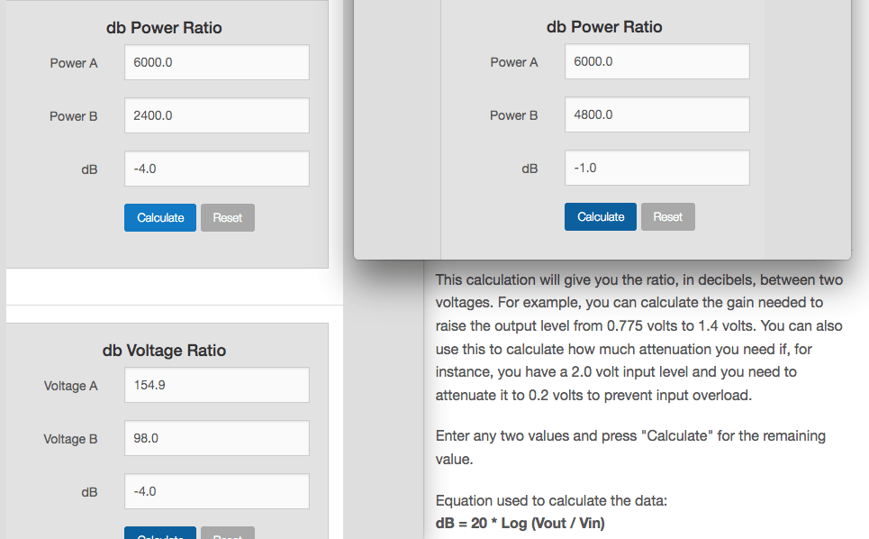

The problem now is, that the amp is can deliver a lot more power than my subwoofer can handle. So I've activated the limiter on my XTi 6002 at -3dB with almost instant attack (0.1s).
I thought -3dB is half the amount of noise, so it should cut the power in half (3000W). I'm pretty sure it doesn't work that way.
Is there any possible way to calculate at how much watts my amp is limited at what limiter (decibel) configuration?
I found the following calculator from crown (dB Power Ratio):
https://www.crownaudio.com/en-US/tools/calculators
The calculation is dB = 10 * Log (Pout / Pin). I think this is the right calculator to use, is it?

Run within linear capability, the topography of the amp makes virtually no difference regarding the sound quality in a DJ application. That said, most DJs do not run amps within their linear capability.I've read in a lot of forums that there is a big increase in the quality of the sound compared to a D-Class (or other classes) amp. My goal is to get a huge "woah" regarding the sound quality from the attendees of my events and I think the decision to get a class I is leading towards that goal.
"Almost instant" would be more like .1ms (milliseconds).The problem now is, that the amp is can deliver a lot more power than my subwoofer can handle. So I've activated the limiter on my XTi 6002 at -3dB with almost instant attack (0.1s).
An attack of .1s (100ms) should still allow some peak level of a 100 Hz signal (10ms cycle) through before clamping down.
The crown calculator works just the way it should, a 3dB reduction cuts power in half.
If you wanted to limit the 6000 watt peak power (154.9volts into 4ohms) to "2400W Program", the threshold should be dropped to -4dBFS (dB Full Scale), or voltage dropped to 98.
