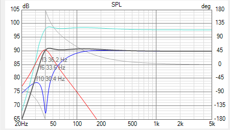

I need a sub for a small living room. Asking about recommended enclosure config, I have two possible ones to get started with.
Are those reasonable setups?
What would you pick?

I see two configurations that look interesting.
1) Ported @ 30Hz in a 18L box. 10W.
2) 4th order. 10w.
Thanks.
Seems like you will be running this thing a little bit hard
Thanks for the feedback.

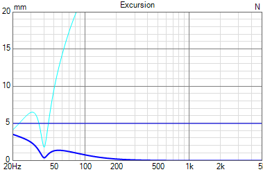

10W to see how it behaves 🙂 But not sure how much I'll need in real life. I guess less for the small room.
It seems it makes sense to tune it a bit higher and use less power. Same SPL and less excursion. Smaller box.
15L, 5W, tuned at 40Hz.
I have buffers, so the idea is to fill the low frequencies and have early low-pass.
Looks really good to me, though personally I prefer a bit more sloping roll off because it helps with group delay a bit.
So perhaps mess with the port a little more, see if it is possible to get the FS around 30-35 like your first post, only with a soft knee instead of a hard one if you know what I am talking about.
Other than that, nice little project.

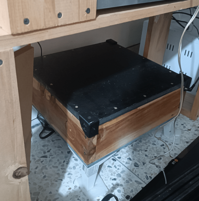

I never reported I built the ported version as recommended. I had this heavy box around and I ended up using it. I didn't measure a lot, other than a quick session to set the low pass. Much better than in the original box. 🙏
