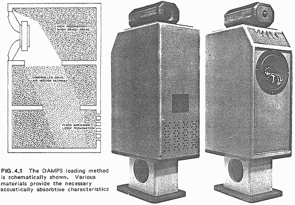

Ted Jordan did the seminal paper (4.7 MB) when he worked at Goodman's but not much has been published since then.Fortuneatly the design is fairly tolerant and quite ameanable to trial & error. This pic is a cut-away of a good, but relatively unsuccessful, commercial design.
dave
