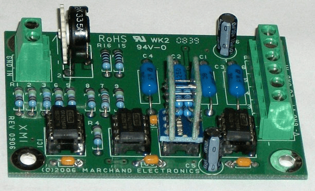

I have enjoyed good results using this 4th order crossover. You can adjust the overlap between the LPF and HPF because it is a state variable circuit.
For your application, you could simply use the LPF section.
Hope this helps,
David
https://www.marchandelec.com/xm1-electronic-crossover.html
XM1 Electronic Crossover​
Steep 24 dB/octave slope.
Crossover frequencies available: 10 - 20000 Hz.
Outputs are always in phase with each other.
Small 2" x 3" circuit board.
Fourth order constant voltage design (Linkwitz-Riley alignment).
