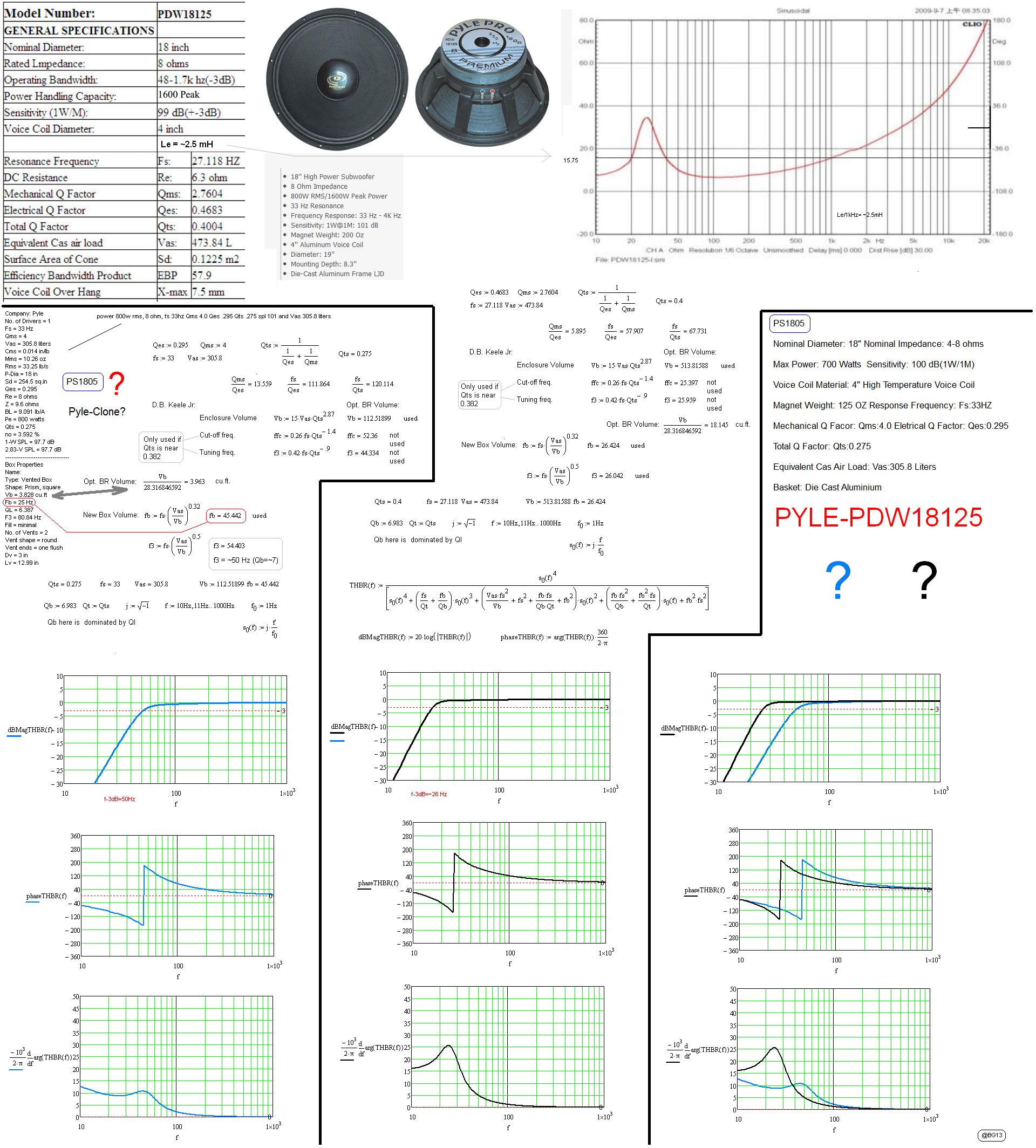

Hi all, my name is chloe and i used to run a home theater installation buisness. i have recently become disabled and have decided to follow a little dream of mine in building a awesome sounding subwoofer for my home.Budget is a concern but cabinet is not, as i have a professional cabinet maker willing to help me out. i really need a design for a Pyle Pro PDW18125 18 inch subwoofer. I am barely familiar with specifications and design , so here is a list of what i was given. power 800w rms, 8 ohm, fs 33hz Qms 4.0 Qes .295 Qts .275 spl 101 and Vas 305.8 liters. i was going to build a sealed cabinet , but from what i read that is a waste of the resources i have avalable, aka driver, all the amplification i need, and a professional cabinet maker. hopefully you guys can help me out, you can reach me at 650-888-0754 if you have other questions, or e-mail me. thank you guys a ton, chloe 🙂
more info
Hello all, heres some more clarification. ok, my room is 12x23ft and i plan to use this mainly for music listening, with some home theater. i like really loud bass, and i am going to use a parasound HCA-1500 amplifier with a NHT X1 crossover to run it. i have a marantz avp-7701 preamp and a stack of 5 NHT A1 amplifiers for my main speakers, a set of Klipsh RF5 mains with some RF3's in the back and the RF center. i am currently using 4 12" subwoofers, 2 sealed NHT w2's and 2 Power Acoustic MOFO 12's in a ported car audio box. i like the sound i get from the sealed W2's but they dont output enough, which is why i am making the 18" sub. this will replace the 2 12" PA MOFO subs. i am guessing i need to get to the 24-30 hz range to get the type of bass that i am looking for and am really looking forward to get this subwoofer up and running. please help with a suggestion or a design, i have alot of resourses available in the next few days but i am running blind on what to do. thanks a ton, chloe.
You really need to get the thiel / small parameters measured for that woofer. What you have put down sounds like the usual crap they send with their "woofers". It will most likely need a huge box to get any usable low bass. If you can bring that Pyle woofer back I would suggest getting another brand.

Assuming Pyle even responds, I imagine they’ll just refer you to the owner's manual here: PylePro - PDW18125 - 18'' Performance Optimized High Power Subwoofer
You'll see in the pdf that the specs are different from what you have and it being Pyle, I doubt either are accurate enough to use for your driver unless you oversize the cab enough to allow some tuning flexibility, though these are probably much closer to reality.
Note too that its inductance [Le] isn’t listed, which is usually a good indicator that it’s high enough to impact its bass performance and that the rest of the specs are somewhat bogus too. Just measuring off the impedance chart indeed it is fairly high at ~2.34 mH/1 kHz.
Anyway, just to show the difference between your specs and theirs for a typical T/S max flat vented cab alignment………
Yours = 108.863 L net/44.74 Hz Fb
Theirs = 460.744 L net/27.45 Hz Fb
Quite a difference and it won’t surprise me if yours will ideally need a 20+ft cab to get down lower in the 20s.

Obviously measuring your own is best but IMO the published TS parameters in this case seem legit in that they are looking pretty modest. Example: BL²/RE=60.97, if I was the guy making stuff up over there, I'd have at least gave it a pair 😀

Looks decent in the tapped pipe, should be OK with standard 80hz AVR crossover...
