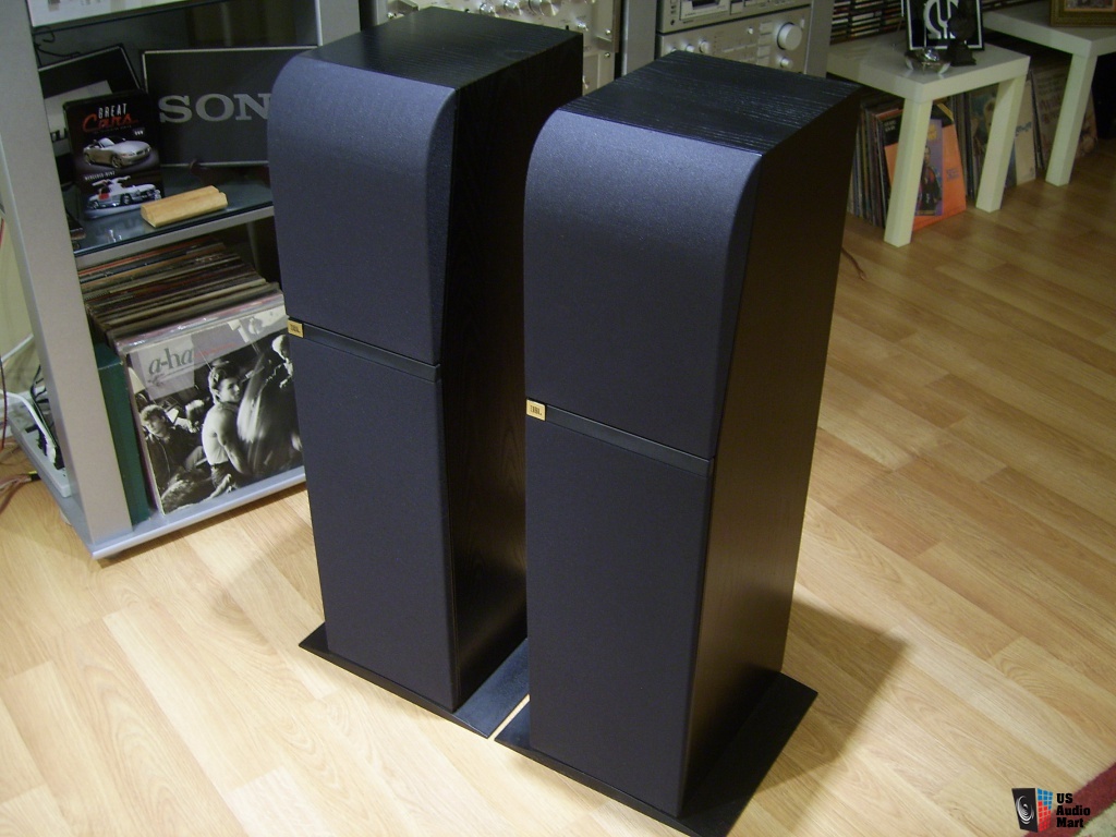

I am building a pair of Infinity 1262w's into sealed enclosures, and would like to try to make a grill for them that mimics the shape of the grill on my JBL L5 speakers. It doesn't look too complex to make a standard shaped grill, but in order to get the curve the same, it may require some trickery.

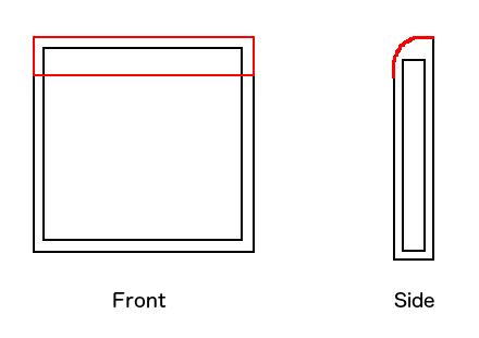

My first thought was a wood frame like a normal sub, and use some perforated sheet or something to make a curve that will support the grille cloth.
I've attached a photo of some L5's as well as what I am thinking of trying... hopefully it makes sense. The red bit is the perforated metal I was describing.
Anyone have any better/cheaper suggestions to achieving the shape of the JBL mains on my sub grille? Or am I already on the right path? Thanks in advance.

Find the Formica/Wilson Art/cabinet hardware/plywood distributor in your area and buy MDF quarter and half rounds up to 4" diameter.

If you start with single pieces of thin MDF to suit dimensions you could then kerf the sections you would like to contour. Once you have the shape you want use ingenuity to hold it while filling in all the cuts with glue and sawdust mixture. https://www.youtube.com/watch?v=PDYHca8f4fY
If you plan the cuts well just gluing them should suffice.
Once the glue sets up use those fronts to trace out side templates, cut those out with a jig or band saw and glue them in.
If the top requires plugs youll have to angle the tops closest to contour in order to glue a strips of MDF so they lay flat against your baffles.
After having another look the last step may not be necessary. It looks like the front are at straight 90 degree with the tops.

I'd guess that the fabrication approach would depend on how acoustically transparent you'd like the grille(s) to be. For me the answer would be - as much as possible, with no enclosed sections, as would result from several of the suggestions above as I read them.
If you're not comfortable with the durability of a grille with just the fabric stretched over an MDF framework, flexible perforated /expanded metal or thick aluminum mesh as for screen doors would make the most sense. You'll want to ensure the exposed edges can't telegraph through the cloth.
