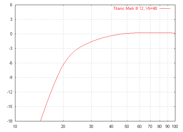

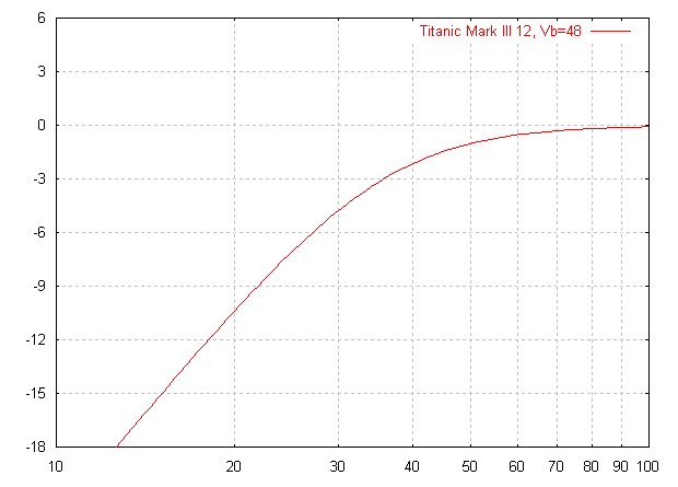

The PartsExpress 12" Titanic Mark III models real well in a sealed box that size. If you use a little boost at 20Hz, the response starts to fall at around 40Hz and is down 6dB at 22Hz or so. With room lift, that might be just about perfect. PE has recently published resistor values for adjusting the boost on their 804 240 watt plate amp, which has a 24dB lowpass filter. If I were going to build another sub, I think I might give that combination a try. I don't have any idea how much it would cost to ship the stuff to the UK.

The 250W amp might give you a few dB less max volume. I don't know.
Concerning the resistors, on the amp that I modified, it was not difficult at all. The only moderately hard part was removing the internal cover to the preamp. But that was a different unit.
As an alternative, you could get a plate amp with a built-in parametric equalizer. Those are more expensive, but some would allow you not only to add the boost, but also kill a room node.
I am attaching modeled FR plots for a system in a 48 liter box both with 4dB boost at 20 Hz, and without boost. The no boost graph is obviously inferior.
Here's the one with boost:
