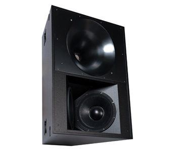

A pair of Danley SH-50 might end up in my livingroom. They'll probably need a subwoofer(or several), and I' open for suggestions. One idea is to copy the outside of the SH-50 cabinet and put a subwoofer in it. This way I could put one below and one above the SH-50, making a kind of MTM. This would give me around 160-180L per cabinet depending on the height. I've also thought of TH, or even IB, but so far I haven't made any decisions. What would you suggest?

I've looked at Danley's creations as well, but I would like to build something myself. Anyway, I don't think the TH-118 digs deep enough. The TH-50 was made to accompany the SH-50, but seems to be discontinued.

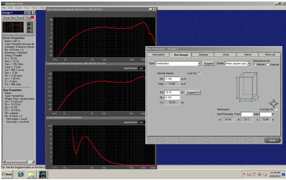

That said, 4 Lab 12s in a pair of ported enclosures matching the SH-50 footprint with a dual opposed driver arrangement would be a simple build and could do well down to the 20 Hz range, and 400 watts per driver is plenty to get your pants legs flapping.

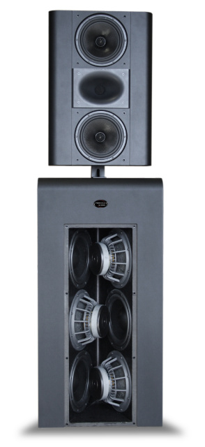

If you can find a MTX T9515-04 over there just do what I did. NewToy link, I'm ending up with 4 of them. Drivers coming from all over the country 😀
I really like your design, but it seems to be hard to source the drivers.

The drivers have been discontinued, I'm assuming that's why the TH-50 was as well. The Orion HCCA152 will work in the design with slight modification, but it cost a bit more
