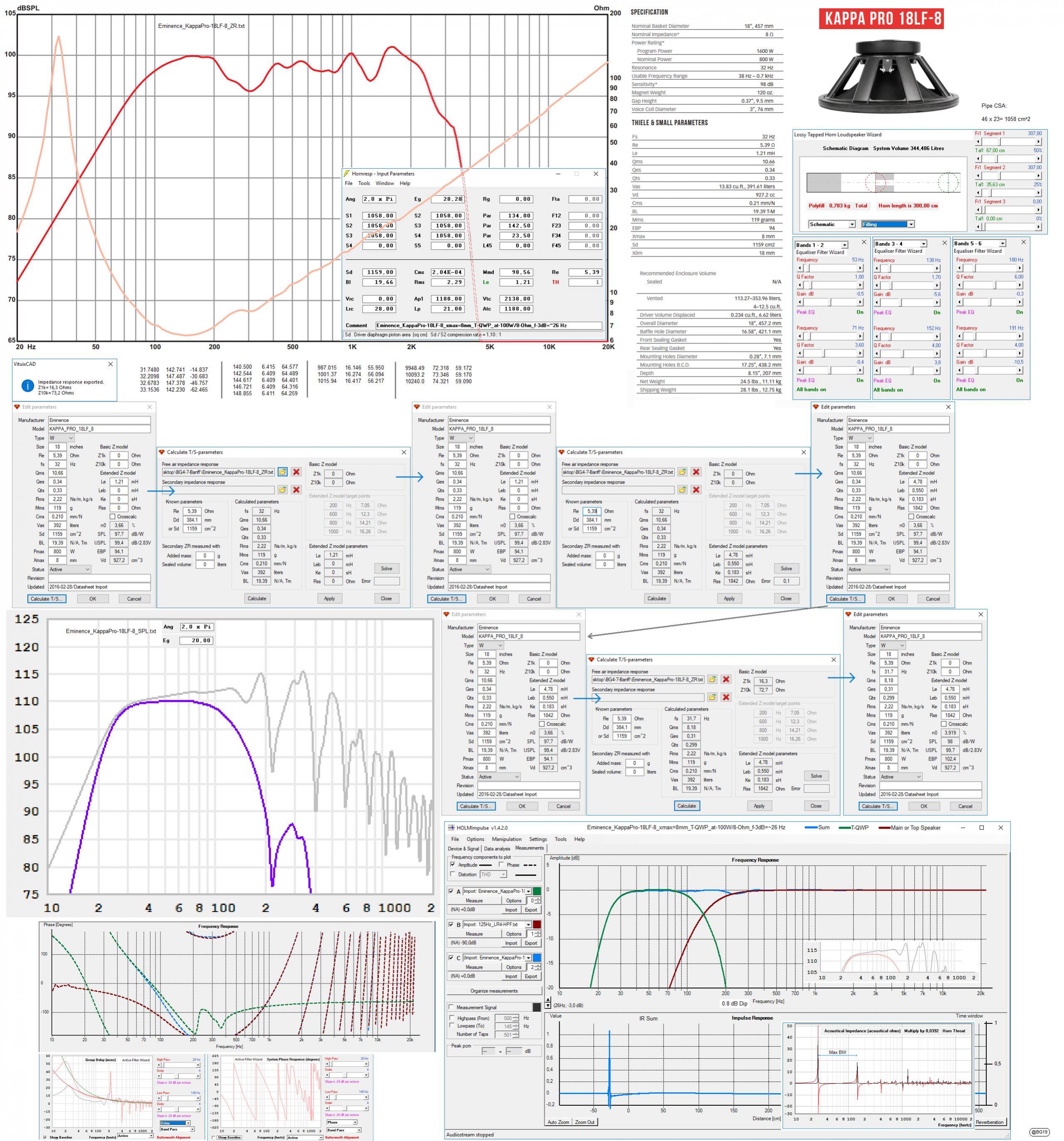

For [high power] prosound apps, the recommended tuning; for small rooms/lower power apps tune to Fs.

Depends how much power you want to throw at these things. Even with a 6cuft box tuned to 40hz the driver is several mm over Xmax at 800w input, there is no real danger with that it's just that the motor is beginning to lose control over the cone and distortion is increasing rapidly. And the speaker will still produce output below tuning just at a lower level but you must have a low cut filter in place or you could easily destroy the driver with high power below tuning.
All of this data is available to see with a modeling program such as WinISD.
will that be ok tho?even tho the usable frequency is 38hz-0.7khz?
Well, had your 'recommended box tuning frequency of 40Hz' been correct, yes, but for high power prosound apps it's actually 47 Hz tuning WITH a 20 Hz high-pass and 120 Hz low pass, so the 38 Hz min. is based on these conditions.
For HIFI/HT apps, tuning to Fs [and lower] is an option due to lower power requirements combined with room gain, so if in my room I'd initially tune to ~27.5 Hz and adjust from there if need be, though in each case I recommend a much larger ~19.2 ft^3 net cab for dual.
