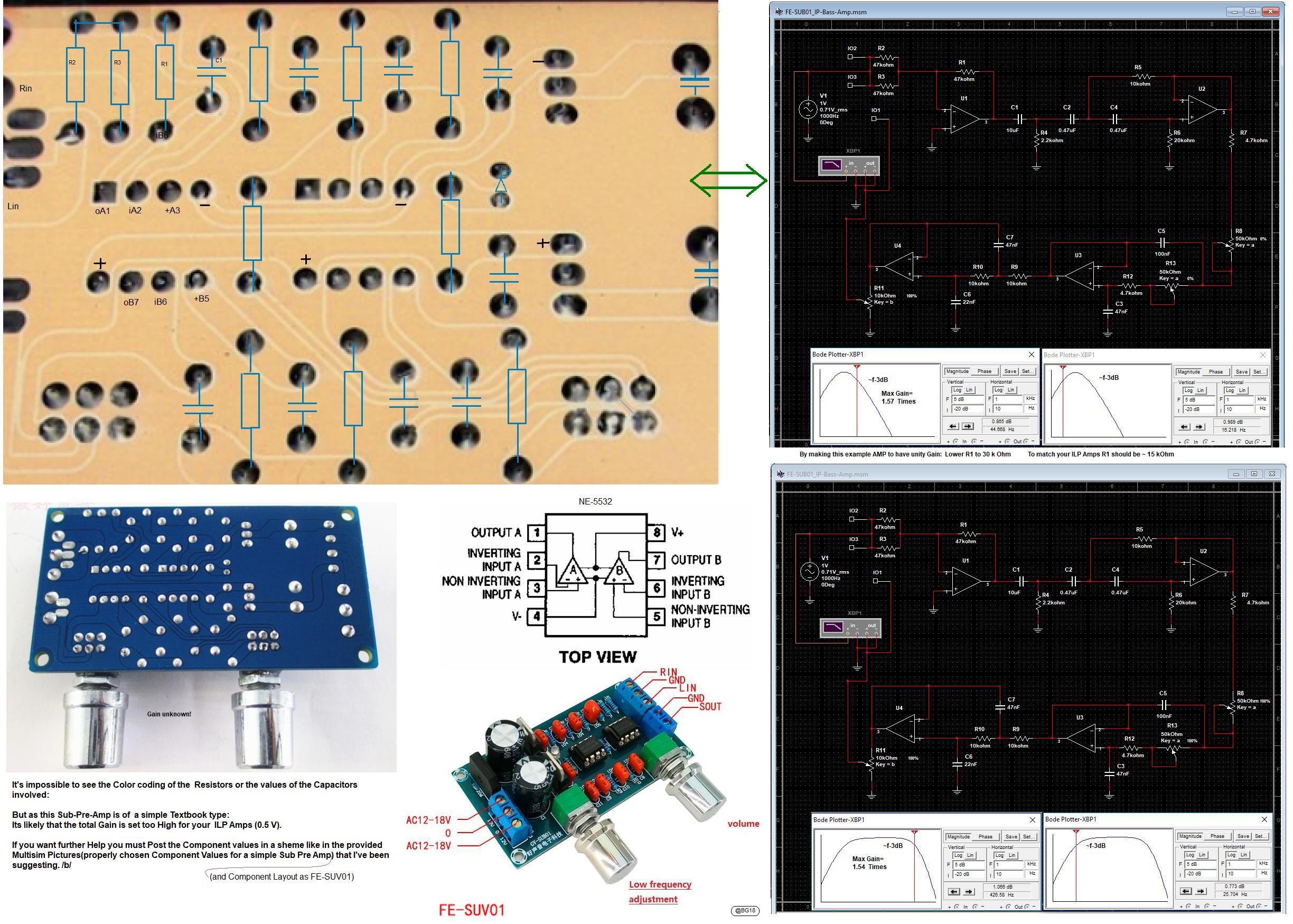

Hi everyone just wondered if you guys had any ideas on this little problem . I have recently built a couple of mono block amplifiers built aroun a pair of old

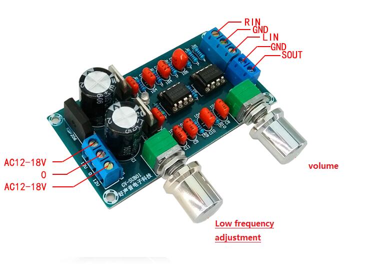

ILP power amp modules . I am using a couple of cheap Chinese low pass filters which are just being used for level control as my Denon AVR does all the DSP. The first one works perfectly but because I have to wait for the Volt drive unit for the second sub I only tried the second one yesterday.
I am getting random distortion at high volume levels which seems to get worse and better all the time . I have tested the amp module bypassing the filter and all seems fine so I’m assuming it’s the LPF .
You guys got any idea what can go wrong with these . It’s based around 2 NE5532 op amps and the rest including the power rectifier and smoothing are all on board too .
Any ideas?

Bjorne it’s exactly the same board but mine cost £3 ($3.80) from China . Korpberget swapped out the opamps with som rc 4580 ones I had lying around . Still the same distortion . Ordered a replacement LPF so hopefully will solve the problem ,fingers crossed
