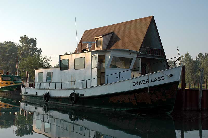

pic of fixer upper
thanks stocker.it is enclosed.The boat is 66' and there will be a dance floor.We are fixing it up now I just wasn't sure if a pro sub could go low?

thanks guys,I will look into your suggestions.Pics are from right at the end of last summer when we got it.Outside and in are painted now.8 man hottub was put on the back by bay doors last week.we just got all electrical problem solved(13000 watt generator,tons of batteries and charger)When I finish i'll put up more pics of sound system and dance floor.
The space is small but probably open so I'm not sure if there is much room gain here. Is the dance floor there already?
