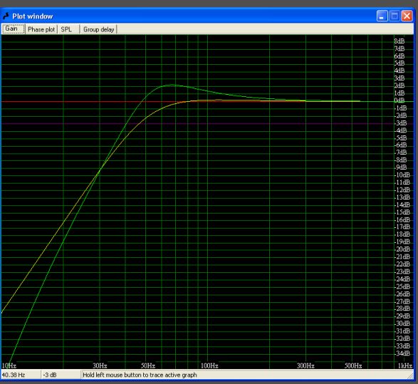

Just for comparison, doing a 2 cu.ft. vented, tuned to 35hz, VS a 2cu.ft. sealed(yellow) would look like this. Would a curve like this sound bad?
I`ll be tracking down that speaker design book thats been mentioned here before. That should help, no?? 🙂

the curve of the vented box you showed doesn't look good - the tuning is too high and there is a bump in the response, so that its response it exaggerated at one point without really giving a significant gain over the sealed box - not a good design. Try tuning lower, closer to fs - more like 23 Hz as a starting point. Get the best looking response, and make a chart showing for your 2cu ft box both drivers vented and sealed. This would enable a better comparison, but it would seem to me a vented box would be the best way to go. All other things being equal, more efficient is better, but this doesn't always help for a subwoofer, as low end efficiency is determined by more than just the nominal efficiency.
regards,
Paul
PS - based on comments above, I don't think a satisfactory conclusion has been drawn as you need to compare on the basis of a simulation that shows the impact all the relevant factors - picking out numbers and comparing them won't really help you.

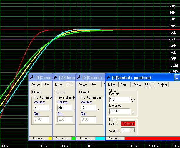

A) I read it as 8mm vs 4.5mm
B) Q and F are raised by square root (Vas/Vb+1)
C) Q=0.71 is the classic maximally flat Butterworth alignment.
🙂 sreten.
Sreten,
Both drivers are specified as having a one way xmax, so it should be 4.5mm vs 4 mm, not a significant difference.
It appears that you didn't show vented for both drivers.
Theli
From Sreten's chart, it appears that there is +3db at 40 Hz and about +5db at 30 Hz. At this point you will have higher power handling and increased output, however, the power will probably be more determined by the cone excursion above tuning for most music. The vented box gives you more output, and this may be important with a sub that doesn't have much xmax. It depends on your tastes and priorities. When you put it in a room, you will get a boost and this is likely to mess up the response of the vented box the most. With the smoother rolloff of the sealed sub, the boost from the room, especially if you put it in a corner, will be extended lower. You will probably get all the extension that you need for music. The sealed box is more likely to give you more articulate and accurate bass. If a vented box sounds boomy in the corner, you might move it out from the corner, or into the centre of the room if possible - try experimenting.
Is it possible for you to try a vent, then try plugging it with your box? That way you get to decide which you like best, and hear how it sounds in your actual room. You are the expert at what sounds best to your ears.

I messed up on the box size, it`s actually about 1.5 cu.ft (~ 42 ltr)
I`m getting a SPL meter from a friend to determine what kind of sound levels I actually listen to at home. Would this help?
Measuring the levels you listen to probably won't help you much with choosing between a sealed and vented sub. For the range covered by music (mostly above 40 Hz) the output from a sealed will not be much less - only 3db. Room placement and the acoustics of the room itself will actually be more significant. If your system is a typical mini system then my guess is that in a small room, either sub will have plenty of SPL.
In a 42L box it becomes harder to get in a decent vent.
After much playing around with different subs and reading the info on this forum, I`ve decided to go with the max pentivent and a 1cu ft (28ltr) sealed enclosure maybe with some stuffing. Makes it easy to build and should put out enough bass. AND be cheap to make.
