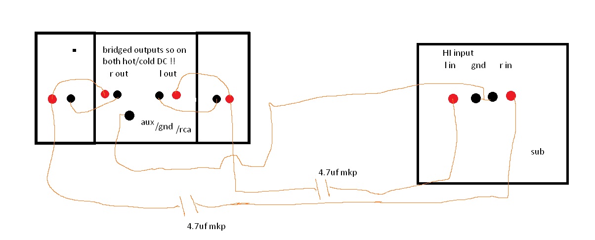

he can connect only positive trough dc block capacitor to high input,and gnd from somewhere.and then it should work if it is bridged
you will do same thing with converter as you done wit just connecting highs, simplest and cheapest way is to connect it as on picture up if its bridged. but please take measurment from gnd of rca input to black output is there any voltage when operating?
