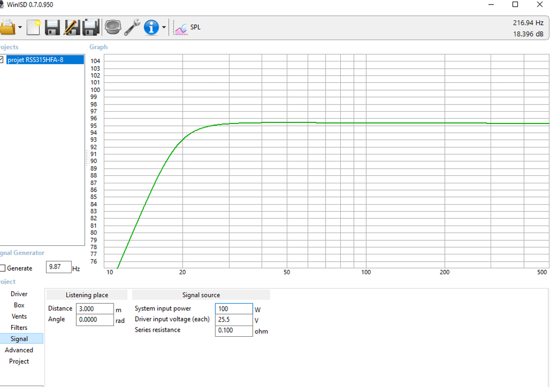

I have a pair of DIY column whose design is attributed to Mr. Troels Gravesen and the realization to myself.
The project: CA18RNX floorstander
The measurement :
I will take the measurements at home when I have a UMIK, but we can think that they go down to 150Hz or even 100Hz in the range +/- 5db
I want to add a sub to have an extension in the bass (20Hz would be cool).
I mainly use my system in HiFi, no nightclub. I enjoy listening to music, but not at unreasonable levels. I am nevertheless in a house without adjoining neighbor, so I can push the level if I want to.
The installation is in a living room of +/-130m3, and my couch is approximately at 2.5m from speakers.
I have space for a 150L box (minus wood, speaker, etc... the box can be 60*50*50cm outside).
It will be powered by a Behringer a800, measured by Amir
Nevertheless, if the amp is limiting, it could be swapped.
I played around a bit with Dominique Pétoin website and loudspeakerdatabase. One particuar subwoofer hold my attention: the DAYTON RSS315HFA-8
Surprisingly, Dominique's website gives me a simulation, but only with events that are much too long...
Wininsd does better.
These simulations give me, if I do not misinterpret, an f3 at 19Hz and SPL at 3m/100W of 95db up to 30Hz.
That would be just perfect for my needs.
But ...
I think it's too good to be true, so I'm coming to see what you think?
Thanks for the help
Alex

Greets!
Well, T/S max flat = ~129 L/20.5 Hz and HR 'says' a 6" dia vent is required for 18 m/s vent mach @ Xmax limited 200 W/m/30 Hz, so at 100 W peaking at 110 dB/W/m/2pi, then 95 dB/100 W/3m/2pi is fine, though still need at least a 5" dia. vent.

Well, thanks for the quick answer.Greets!
I don't know where you got/calculated all these datas, though! 🙂
Could you please explain the calculation ? I could therefore do it by myself
Best
Alex

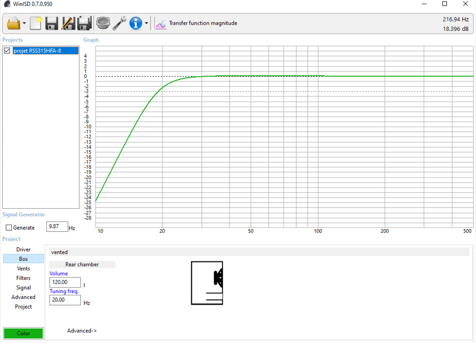

This can also all be simulated in WinISD. I do it like this:
Basically, I try to keep the air velocity below 20 m/s at Xmax. So I first display "Cone excursion" and increase the input power under "Signal" until Xmax (the horizontal red line, if Xmax was specified in the driver parameters) is reached above the tuning frequency fb.
Then I display "Rear port - Air velocity" and increase the cross-sectional area of the port under "Vents" until I am at just under 20 m/s at peak. That's about where it often hit for me with a cross sectional area of 1/3 * SD.
In your case - 120 liters @ 20 Hz - a practicable bass reflex design with ports is hardly possible: one third of the diaphragm area of a 15 inch driver would be about 270 cm², according to WinISD the port would then have a length of 1.5 m. In this case, it would be better to use passive membranes if bass reflex is still wanted.

Thanks a lot for the procedure.
Indeed, vent lenght is limiting!!
Is it possible to bend the tube to get those 1.5m? Because in a 60*50*50cm box, I could technically do it, but it would be weird 😀
I tried with a laminar vent. Again, a 5*40*110cm long vent is "doable", not sure if it is a good idea.
I have never designed a box with a passive radiator but I tested with this one: DS270-PR
If I did it right, for a 110L box, f3=25Hz, xmax is never limiting (350W @ 3m gives +/- 100db). I added Mms (100g) to "added mass to cone" because it was not asked before, but not sure if it's correct.
If it's too hard to design, I'll switch to another subwoofer.
Best,
Alex
