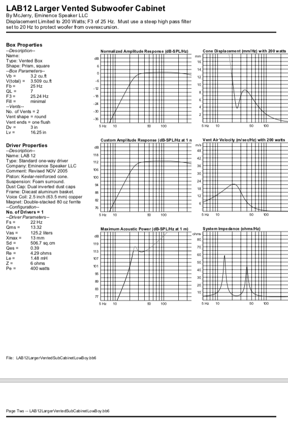

Using a "donut" ring you could use a 12" driver in your cabinet, ported F3 25Hz.

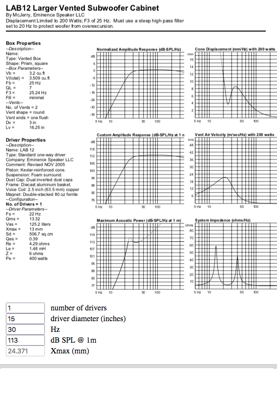

A LAB12 at just 200 watts in your cabinet with two ports would be within a dB of the output of a sealed 15" at 30Hz requiring 24.4 mm excursion, which would require several times the power.
At 400 watts, the ported LAB 12 could exceed the output of the sealed ZR15.2D and still be under it's 13mm Xmax.

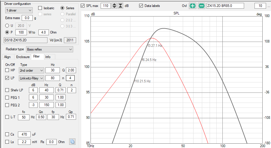

So for the ZXI15.2D it lists these box specs.
Sealed Internal Volume
56.6L / 2ft3
Sealed Box Output Response F3
32Hz
https://ds18.com/products/ds18-zxi1...fer-2000-watts-2-ohm-dvc-quad-stacked-magnets
What would the F3 be for a 3 cu ft box?
Even if the F3 is not much lower in the larger box it is still lower than many other subs I looked at.
The depth is a no-go though at 10.51" as the cabinet brace would get in the way and other than cutting the brace I am not sure how to make it fit.

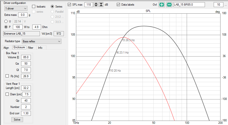

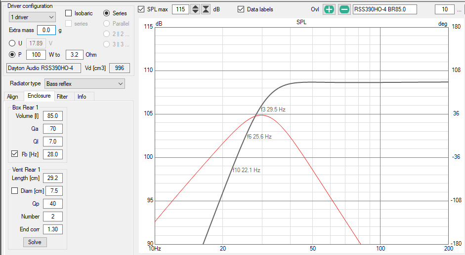

In a vented-box enclosure we can get something like the following response.
Adding in an 80-Hz 4th-order Linkwitz–Riley low-pass filter we get the following response.
If we use a 3 cuft (85 litre) closed-box enclosure, we get the following response when an 80-Hz 4th-order Linkwitz–Riley low-pass filter is applied. The peak output of the closed-box system is about 4.5dB less than that of the vented-box system. Of course, the closed-box system won't suffer from port chuffing noises.
If we apply 3.5dB of parametric EQ at 30Hz with Q=2, the closed-box system can produce the following response, with a −3dB point of 25.9Hz. That gets the system comfortably below the 30Hz design upper limit, albeit at the expense of driving the subwoofer a bit harder.

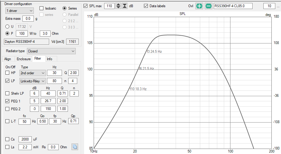

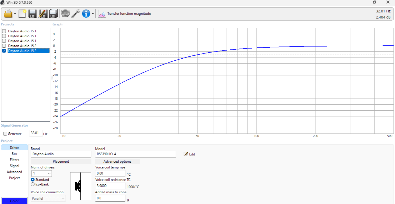

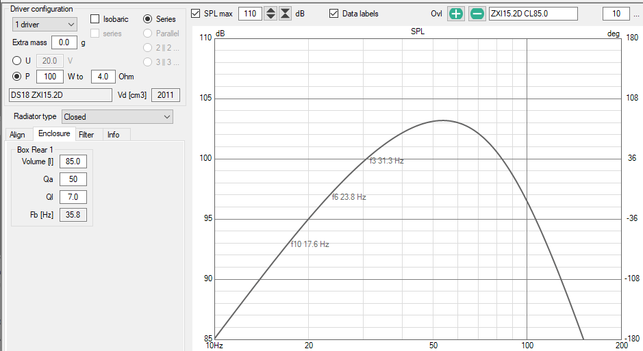

Interesting. For that same Dayton Audio driver WinISD shows this assuming I did everything right.
The Dayton Audio does seem like a good choice though. I've used some of their other speakers and have always been pleased with them.
If I felt the need, what EQ could be applied to the Dayton Audio to extend the F3 lower?

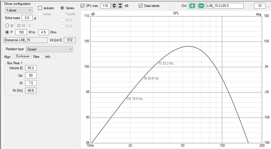

If we look at the Eminence LAB15 15-inch subwoofer, we can get the following response. This includes the effect of an 80-Hz 4th-order Linkwitz–Riley low-pass filter.

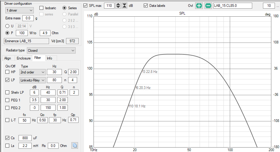

Switching to a closed-box version of the above enclosure, we obtain the following low-pass filtered response.
If we would like to further extend the response using passive amplification, adding a series 800µF capacitor results in the following response.
It would be possible to add a 2000µF series capacitor to lower the F3 of the closed-box system. The response plot below shows that an F3 = 24.5Hz should be possible.
Alternatively, it would be possible to apply 5dB of PEQ at 26.7Hz with Q=2 to get the following response, with the same F3 = 24.5Hz.

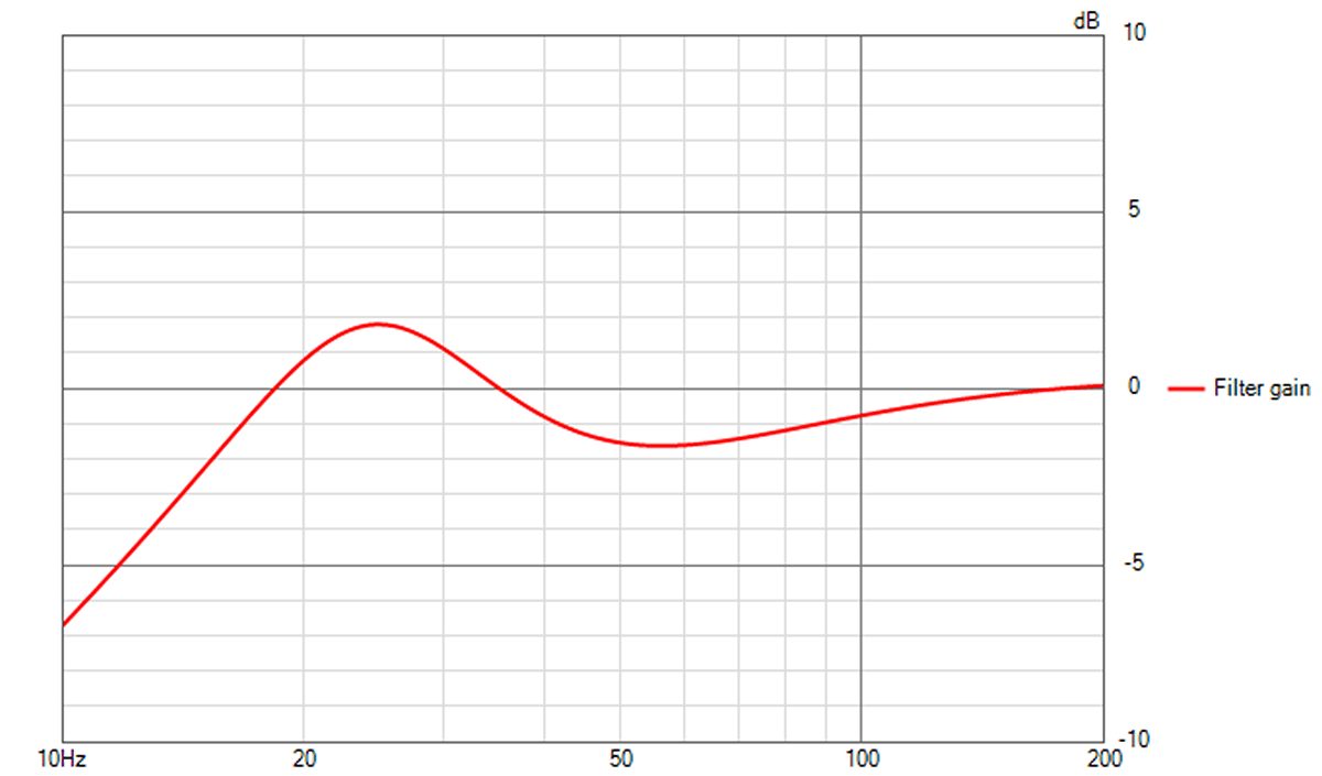

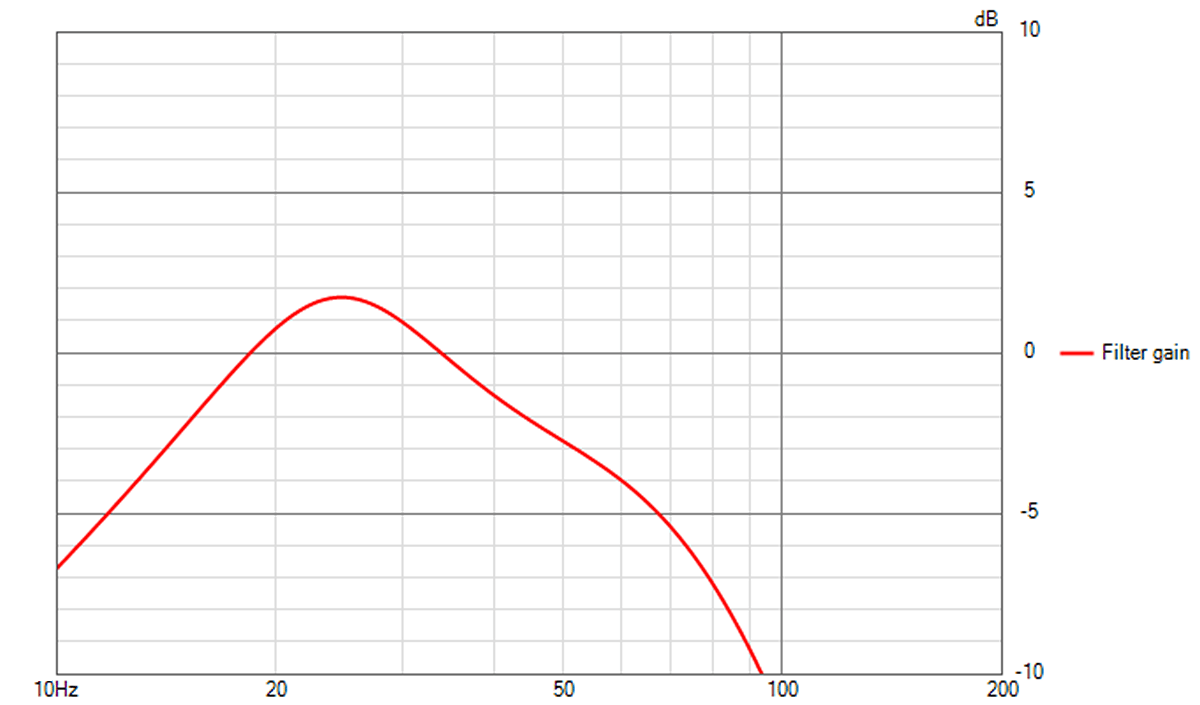

The capacitor interacts with the electrical impedance of the driver, which can be represented by an electrical equivalent circuit consisting of resistors, capacitors and inductors. The effects are driver/enclosure dependent.
In the case of the Dayton driver, the series capacitor introduces the following filter response into the system. Initially, the capacitor behaves like a 1st-order high-pass filter but then it introduces some equalization between 18Hz and 200Hz.
When the Linkwitz–Riley 4th-order 80Hz low-pass filter is added, we obtain the following composite response.
