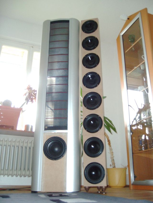

Well not quite dipole or a sub, I am building a line array mid-bass bolted to the top of an infinite baffle sub matted to a Martin Logan SL-3 panel as my new center. See details on this DIY Audio thread
That concept could be extened by a couple more drivers and some greater length to do frequencies down to 30Hz or so.
As for the best sub to match ESL’s, my opinion is that a good infinite baffle is the trick.
My IB delivers outstanding results with my all Martin Logan system. Here’s a pic:
The key is the crossovers and phase matching. Use a good high-end speaker processor like the Drive rack 260 and tune it to your system /room and presto, audio nirvana.
That is exactly the approach I would take. Good job Calvin. Looks nice 😉 ! I would run the box sub below 40hz and use the dipole a array above. Can't hear it, but I know its sounds good 🙂 . What woofers did you use?
cheers,
AJ
thanks for the praise 😀
The box blow the panel will be replaced by a smaller box, that will only house the electronics. But with enough volume to have a 2-channel digi-amp and active crossover built in -future plans-.
The system runs the woofer drivers from app. 35Hz to 250Hz, where the panel takes over. The panel is crossed over with a 2nd order butterworth filter with a Q around 2 to counter the falling freq-response and a notch on its ground resonance (160Hz). Acoustically this gives app. 4th order chebycheff.
The woofers are filtered with a 4th. order chebycheff and the acoustical behavior is the same. So both channels experience equal slopes 😉 -different slopes, i.e different group delays is imo one of several reasons why most hybrids integrate bass and panel so badly.
The bass channel is completed with a subsonic and bass boost (0-10db @ 35Hz..I run it at app. 6dB).
The drivers are bought from a sell-out. I knew them before and that they are able to be used in dipoles, but the sound-experience I have now is far better than I believed could be possible in my room. Playing a double bass like in Rebecca Pidgeon´s Spanish Harlem led to strong booming at distinct frequencies. Now I have clear and highly precise bass without any tendency to boom at any frequency at all. 😀 😀 😀
What surprised me even more -and I don´t know any explanation for this- is, that the exceptional bass quality leads to even better mid-highs!!
Though I´m absolutely happy with the results, I´m a bit ashamed that both towers -as You can see them on the pics- costed about 200€
jauu
Calvin
