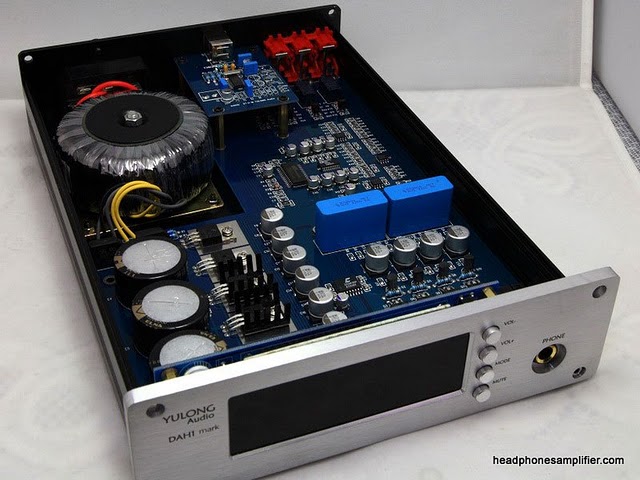

I have used several times the AD-1955 demo board like that from the photo by post #9 about
http://www.diyaudio.com/forums/digital-line-level/135650-ad1955-evaluation-board-schematics.html
and the photo URL
http://www.diyaudio.com/forums/attachment.php?postid=1315495&stamp=1191364151
Unfortunately the AD-1955 demo board is since several years no longer available
This board is much more better than the DAC Yulong DAH1 (DAH-1)
to find about this weblinks:
YULONG DAH1 MARK DAC /Pre amp/headphone amps : hi-end headphone amplifier
Yulong DAC DAH1 Mark headphone amp - Head-Fi: Covering Headphones, Earphones and Portable Audio
and the attached photos
The main disadvantage of Yulong's DAH1 (DAH-1) are the very hot voltage regulators (with the small heatsinks). I have this problem solved by screwing this voltage regulators on the inside of the alu housing (no longer there are this hot spots on the PCB). This work was very unpleasant and time consuming.
I want to have similar evaluation board than that one with AD1955.
Which type could be an adequately substitution (same sonic quality)?

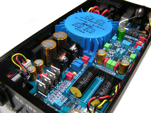

What about this DAC? - it has a replaceable module for both the AD1955 and PCM1794. Price looks to be very reasonable here in China (around $220). At least two of the regulators look to have heatsinks 😀
HA-INFO NG94 MkII

Exactly this I also note. In the attachement you will find the schematic of Yulong's DAH1, unfortunately without the front/display unitabraxalito post #8: said:In my limited experience with the AD1955, the output filter components have a big influence on the sound quality. The best-looking published filter to my mind is indeed the one that AD shows with the AD797s on the EVB - with the notable exception of the 100pF cap between the complementary DAC output pins. Do you have a schematic for the Yulong output filter?

Yulong DAC enhancements
OK, thanks. It seems to be incomplete in other ways besides the display (which doesn't matter to me). For example, there are no wires taking data into the AD1955😕
The output filter seems to be directly lifted from the AD application but the AD797 has been substituted for a BB one with considerably lower bandwidth. I'd suggest deleting the 100pF caps from the DAC output to ground, but I'm not sure what the outcome will be for the sound - so try it and see. They can't be doing any good - DAC designers generally work to achieve the lowest output capacitance so having external caps looks odd to me. Perhaps they're to soak up glitches from the DAC, but they tend to screw up the following opamp in the process. Another bizarre feature is the lack of feedback around the output discretes on the headphone buffer - the feedback loop has been closed around the opamp but not its output driver. Really weird.😱
The power supplies are only made from standard 3-terminal regs, so a move to generously decoupled adjustables will improve ripple and noise (assuming this hasn't been compromised by grounding problems). Adding extra RC filters before the regs may further reduce ripple. Notice that the DAC offset currents are fed in direct from the +15V rail through two 2k2 resistors. If these resistors aren't closely matched (so the CMRR of the following filter can provide some help) the +15V power supply noise is being fed in unfiltered straight to the DAC output. This is an oversight copied directly from the AD EVB (albeit with a value change to track the change in rails from 12V - 15V).
Other improvements are bound to be possible to the layout...
