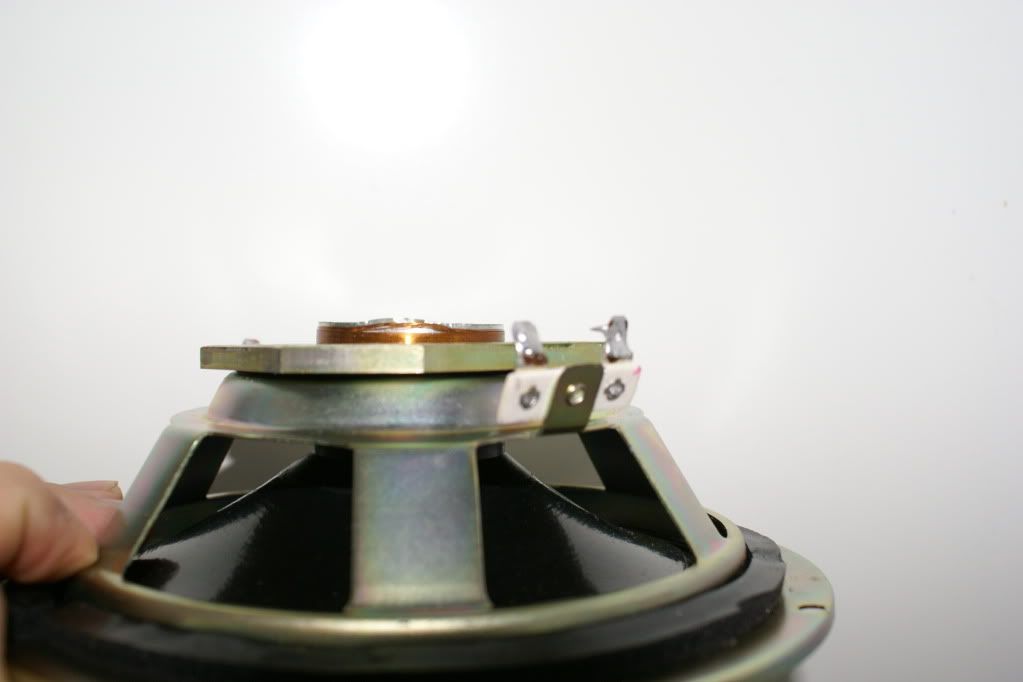

So I visited the local stereo repair shop. The fellow there told me it would cost about $150 to repair the voice coil on the driver, then he upped it to $250 when he realized there was a tweeter installed in the middle of the midrange. Turns out the tweeter is easily removed, one screw and an easy desolder. I could buy the Uni Q drivers up for auction on Ebay right now and replace the tweeters in them (NT19) with the Model 2 tweeter (NT25) and basically, I think, have the same thing as the midrange is the same on both. However, I decided to take the magnet off the driver and look at the VC. Nothing to lose right?
Paint thinner and a razor blade did the trick. Next step will be to straighten all the bent copper wires and the foil surrounding them.
Somewhat tedious but doable. The final, and trickiest part, will be to get the magnet positioned back onto the VC. Here is a link to a jig someone made for that purpose.

I am hoping I can get away with just the PVC pipe and a dowel.

Don't give up untill you make a thorough search of Ebay. I passed on a pair of UniQ drivers because i wanted to do this myself, but there were more than one. I would think any driver with a B160 midrange would work.
As for fixing them yourself, they are easier than most as there is no need to disconnect the voice coil, surround, etc., since the tweeter screws right out. If you can bend the wires back in shape the main thing is to make a jig to place the magnet back in correctly. I finally hit upon the idea of screwing the magnet to a wood plank, and then screwing the driver to another plank. then with the 4 screws that hold the driver to the plank I can slowly lower it into the proper alignment.
