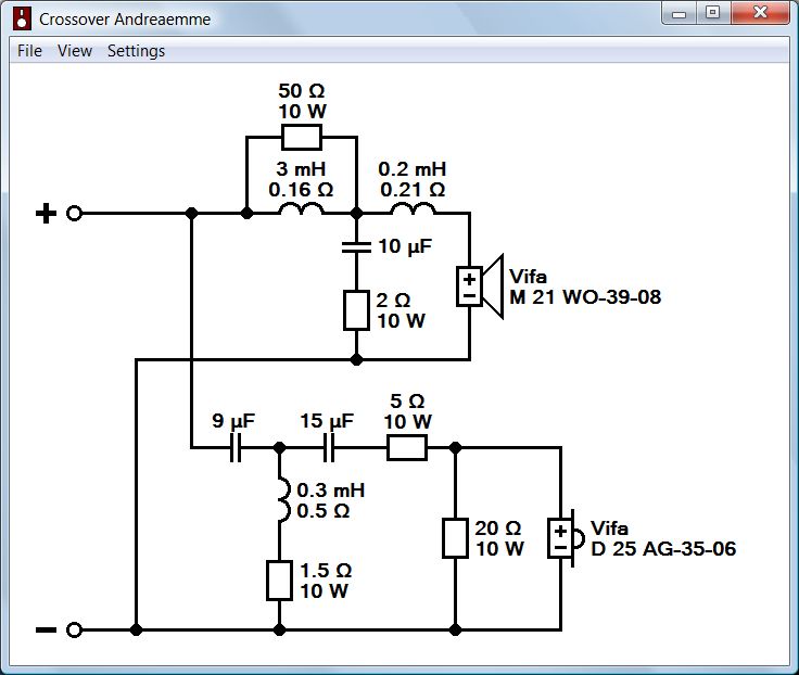

Thank you, I'll study well. However the system I've built is based on The New Vifa Tower by MurphyBlaster, what do you think about its low-pass filter?
Inductors I've used are Intertechnick Tritec type, the main has ferrobar inductor body, the other hasn't.

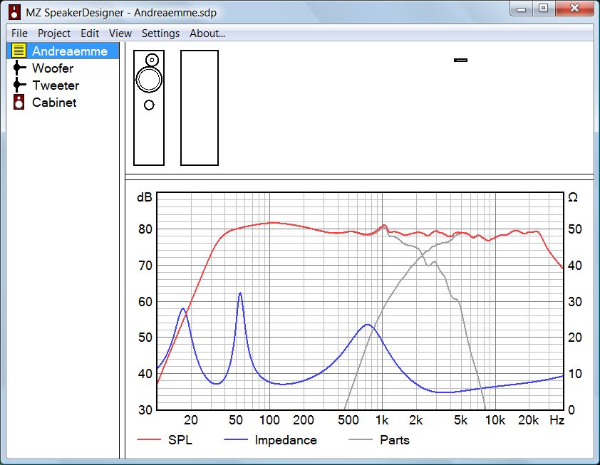

Based on a simulation the New Vifa Tower seems to have a hump of 3 dB around 100 Hz. Cause is the large woofer coil of 3 mH in the crossover. I'm not sure if that explains the issue with your speaker, perhaps someone else can tell more. 😕
The Excel woofer certainly is not a drop-in replacement for the Vifa, you would have to redesign the woofer filter completely IMO.
This could explain the negative sensation I have just for that field of frequencies.. So can I resolve this problem without substituting driver?
Difficult to say. Of course, the hump at 100 Hz is caused by the crossover and can be eliminated completely with a filter redesign. But that doesn't necessarily mean the problem is solved. Vented box design always is a trade-off between low frequency extension and transient response. A Vifa M21WO-39-08 in 60 liters clearly is an alignment in favour of low frequency extension and at the expense of transient response. That's a basic fact which doesn't change. Hence I'm very unsure what to expect from a crossover modification.
If you share more information about your speaker (cabinet size, driver placement, vent size (a picture usually answers many questions🙂)) I might come up with a crossover modification proposal. You don't really have the old Vifa D25AG-35-06 tweeter, do you?

Looking at the crossover, it's a bass heavy design.
MurphyBlaster Productions
3mH is way more than I would use. That's going to create very intrusive "Here I am" bass which will overwhelm the midrange.

I'd try about 1.5mH or less, with some impedance correction like 4.7uF and 4R shunt. That simple. And change C2011 to about 4.7uF for a higher 3kHz crossover. That's gonna be close to BW3, so either polarity might work, but I'd go negative polarity. You'll need less attenuation on the tweeter too, because smaller coils make for more efficiency and a more direct sound. Keep it around 8 ohms load to the filter. You could lose that 2R in series with the tweeter coil too.

Oh, I could mention that unwinding coils to reduce inductance is easy enough. Inductance is proportional to the square of the number of turns. So to convert a 3mH to 1.5mH, you take out about a quarter of the turns. It helps to measure the effect with a good mH multimeter as you go along. Then scrape the enamel off the bare end for soldering. 😎
system7, if the 3mH is changed to 1.5mH, would that not now allow the baffle step to appear?
I have often found 2.5mH to 3.3mH to be a good compromise.

You very rarely apply more than a couple of dB bafflestep, not the full theoretical 6dB, and room gain tends to swamp it into boom anyway. Which is what is going on here, IMO.
How come Troels gets away with 0.82mH here?
TQWT-
The smaller the coil, the more slam the speaker has. No need for a new driver at all. It's the crossover that is plain useless. Whoops, outspoken again. 😀
