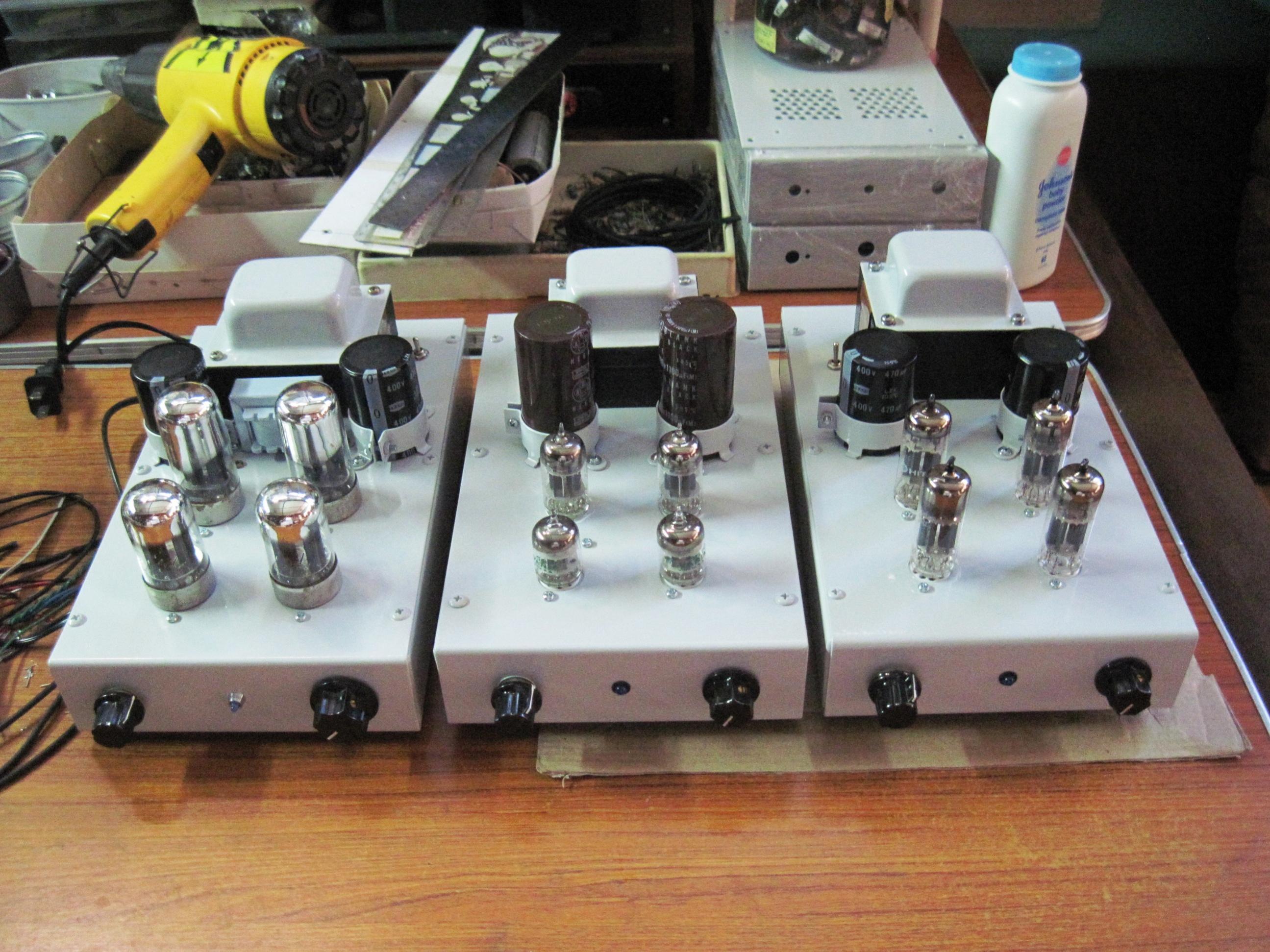

I need about 6-9db more gain in my Aikido.
Would a 6AQ8 be a suitable front end substitute?
There is a matched & balanced quad of NOS Tungsram 6AQ8's on E-Bay for $40.
Then I would have a backup set of each.
I'd run the 6AQ8's in front with the 6CG7 follower.
6AQ8/ECC85 would give you 10-12dB more gain. You might need to adjust the cathode resistors to get the bias right.
Unusual request - most people find the Aikido has too much gain!
I am driving a Pass F4 (-.3db gain) on some pretty low efficiency speakers.
I'm really only looking for about 6db more I think.
I don't want to sacrifice the superb sound I have with my 6CG7's though.
I am running 290V B+ for what that's worth.
Switching to 12V heaters is simple with my Aikido since I'm running my 6.3v heaters in series right now.
6N1P is supposed to sound like a 6CG7, but with more gain (35). Or you can try a 6BQ7, 6DJ8, or 6N23P.
