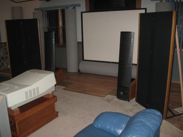

Not for everyone, but this huge dual 12" tapped horn from Danley Sound Labs rocks my home theater. It is veneered in Macassar ebony.

Pretty room!
Pretty gear!
Imo, way way way too live (reflective) for my listening tastes...
As far as a tapped horn - I'd be concerned about the delay time between it and the ESLs...
_-_-bear
Pretty gear!
_-_-bear
1. From what I can see in the picture, that beautiful room (and with pretty gear too) must be very echo'y. Hard to imagine me making speakers sound tolerable to me in that room, not least the MLs, to my ears.... I hope I have expressed my personal opinion of my personal taste in a manner which is consistent with forum standards of courtesy and respect for the fact that others may have very different personal tastes.

The photo is of "Wardsweb" room, he posts in many audio forums, including this one I think.
He builds some of his own equipment, a very talented person. I'm not sure that that photo represents the last word in room acoustic treatments. Maybe he changed it since the photo was taken.

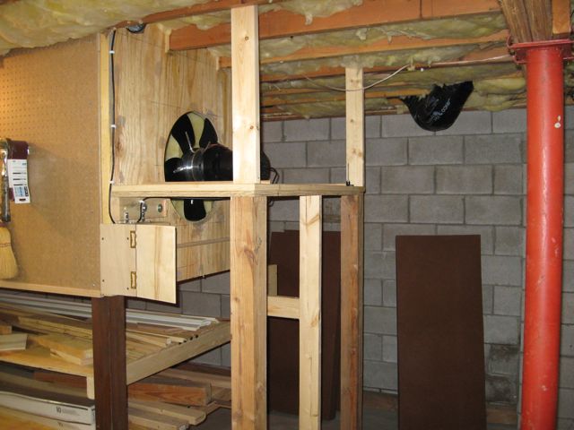

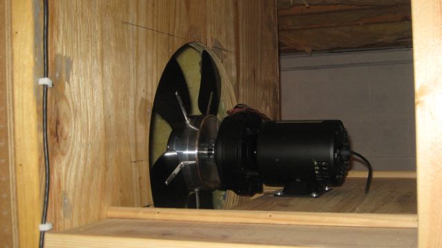

electrostatic, Magneplanar and rotary woofer
This is my system with Martin Logan Summits (woofers disconnected) along side of Magneplanar Tympani IV bass
panels (modified) with Eminent Technology Trw-17 Rotary
subwoofer.
subwoofer.
