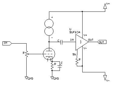

Here is what I am thinking as a design -- it is similar to the millett design but uses a cap before the buffer so that an electrolytic on the output is not necessary, I 'm not really sure this will work at all though. The 6GM8 might be ideal, though I do think I'll either need a voltage reg between the B+ and the + power input to the buffer, or I'll need to run the tube even lower than I was thinking. The tube's heat dissipation is very low, so that isn't a problem, but maybe the voltage reg will be a problem ... did I mention that this is in a solid wood block just slightly larger than an RA-1 with no air holes? That's probably important information too. 🙂
As for the mint suggestion, I have been considering a single opamp amp based on the AD8397 which is good for power hungry headphones (grados.) Tangent is working on a successor to the mint using this chip as well, be he is unlikely to be done soon, so I'd like to get something working sooner than later.

Your design should work. The cap can be a high quality type, I would choose a low dielectric absorption type like teflon, polypropylene or polystyrene film/foil. You will need a resistor to ground for BUF634 bias current. The 6GM8 appears to have about 2k plate resistance so driving the BUF634 and using a simple PNP/LED CCS should work fine.
A tube with 6.3V 300mA heaters will dissipate about 2W, a 6GM8 with Vp=25V and Ip=10mA will dissipate 2.5W. You should provide some ventilation, more for the SS than for the tube.
If you need something right now I'd just use op amp du jour with BUF634 ala MINT, low parts count and probably compatible with your DAC supply, with a bipolar supply you don't need the rail splitter, you probably have all the parts to build. AD8397 is high GBW, you should have access to a oscilloscope 60MHz or faster to check for oscillation.
At some point you might consider using the AD8397 with inverting feedback instead of the BUF634, driven by the mu output of a Pimm CCS, but this is more complicated.
