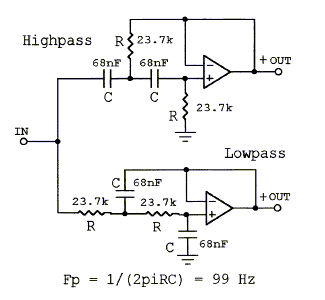

i see that my first post was pretty unclear.
I am building a separate sub for HT purposes. All i need info on is a line-level filter design. Be that active or not.

oops!
heres the pic.
-Mike

Matjans,
Ohh, line-level.😉 Here a site that can help with a PLLXO.
http://www.t-linespeakers.org/tech/filters/passiveHLxo.html
If you're really sharp you'll recognize the home page of one of our more prominent members.
Take a look at Rod Elliot's site for information and boards for some simple active line-level filters. The xover stuff is here:
http://sound.westhost.com/projects-3.htm
I use a first order PLLXO as a hi-pass to the mid-bass and a third order active lo-pass for the sub. Beyond a second order PLLXO and the losses become too high.
