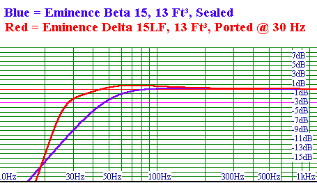

Matttcattt:
If you don't have a extended core, a sealed box is more advisable. The ported will have high distortion at the deep bass end.
The Eminence Delta 15LF has an extended core, the Beta 15 does not.
Even a 15 incher will have trouble putting out super high output at 30 Hz in a sealed box. The ported box will have a higher maximum SPL at it's rated power. I would suggest the ported for more output. However, you can go sealed as an option.
Below is the Eminence Delta 15LF and the Eminence Beta 15 in two identical boxes. I checked the eminence website and found that the Beta 15 is just 1 dB more sensitive than the Delta 15LF, (even though it is listed as 2 dB), so the chart is off by one dB. big deal 😉.
As you can see, these two give virtually identical performance in a 13 fT³, (that's 368 liters in Metricspeak🙂 ), box tuned to 30 Hz. How low did you want the sub to go?

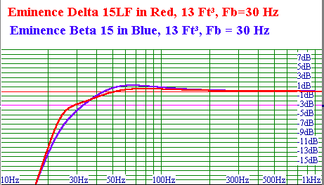

Matttcattt:
Both are ported in the chart. Only ported systems have Fb. You cannot tune a sealed box, except by making the box bigger or smaller.
I made the chart to show that both the Beta 15 and the Delta 15LF are pretty much the same, except the Delta 15LF is a better made driver and works in ported boxes better.
