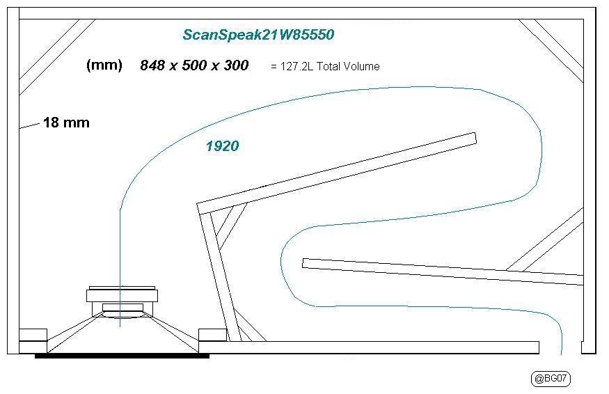

Hi 2wice,
I tested a Scan Speak 21W/8555-00 in a TL for about 7 years ago...Great Sound.
So far I've only found a simple saved drawing:
b🙂
Thank you very much.

Amazing project, I like that (driver + TL). 🙂
You will probably need EQ, I mean a Low pass or something, but I'm not the best person to ask (experience). This driver has a lot of information (output) above 100Hz and breakup above 1KHz that you don't need. A passive component crossover might not work in this case. What a Bandpass sub would take care of that, but if you go with the TL project, or other, you will need some tips of what to do to have some control in the frequency domain.
http://www.scan-speak.dk/datasheet/pdf/21w-8555-00.pdf
You will be using separate amp from the main speakers and adjust considering the need for a perfect match.

Hi Inductor
I was wondering if the 8" would be sufficient, compared to a 10" or 12" sub, but it seems like it would do the job nicely. Would the TL be a better idea than a sealed box? Seems like a pretty big box that.

What do you mean (?), is more than enough...
""8" would be sufficient, compared to a 10" or 12" sub""
""Would the TL be a better idea than a sealed box?""
Regarding your post, a BR enclosure would workout in more maneuverability (~60L net). I don't remember mentioning a sealed speaker. That would be a another project maybe a 10" or 12", yes. I don't like subs from Focal, they don't have a very good LF. Maybe is just the electronics or alignments. The drivers are in the most cases good or excellent.
